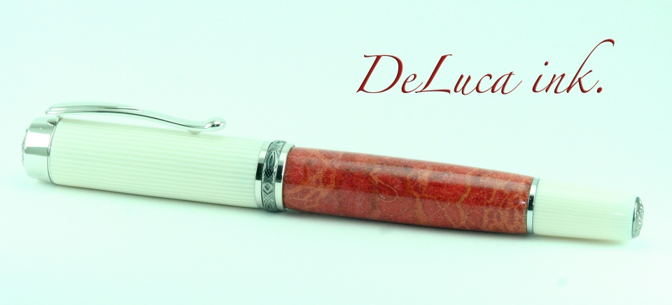

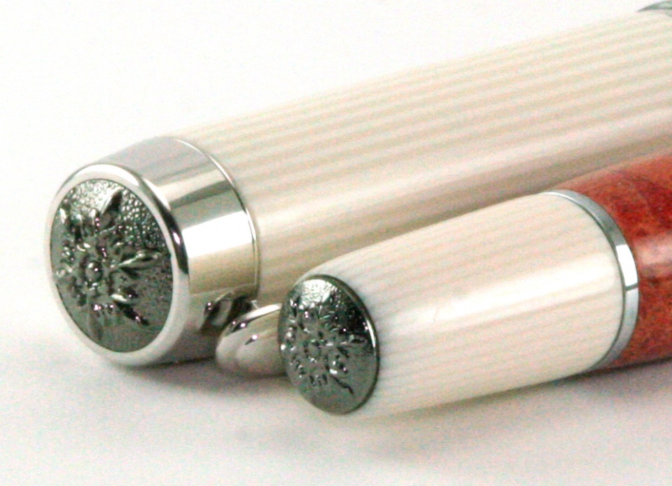

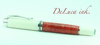

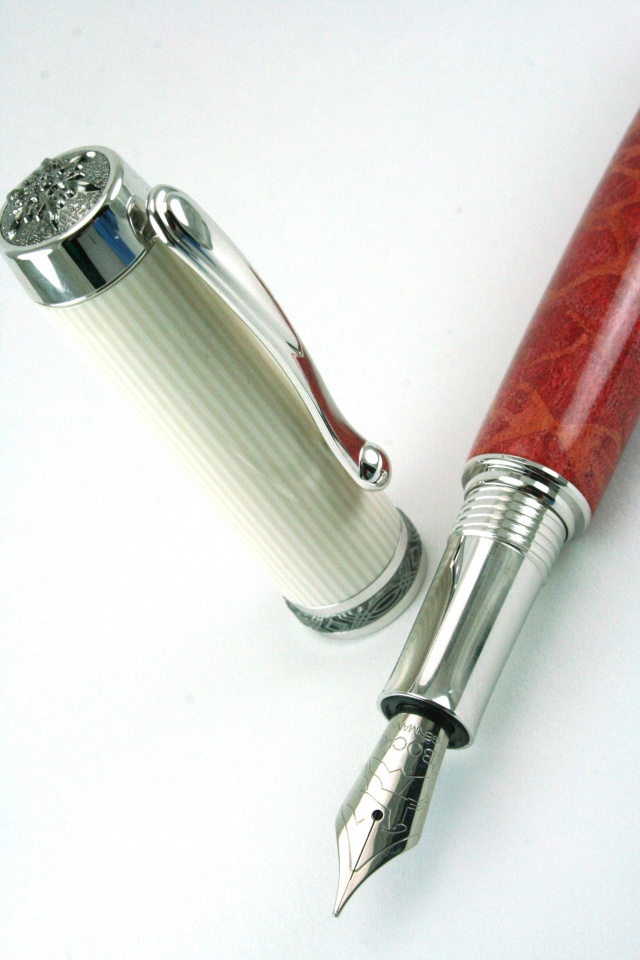

Second up we have The Apple Coral FP. Genuine Apple Coral, dressed up with Casein. Much Straighter Shape on this one as I tried to keep the diameter down, and this material is a little more forgiving of the group. Full Sized Rho/BlackTi Statesman, with custom casein rear section and stock finial, which fits like a glove, and is epoxied in place. That section is epoxied in the tube, but was a good fit, not too concerned about it. That rear rhodium ring is from a rhodium jr gent cap that I had spare, i just made my parts to this diameter. I had made a trim ring, the rhodium one on the front body, the is under the threads the the cap screws on...Made from casein, but was such a tight fit, it is currently stuck on a now extra part....maybe one day. Again 6mm Polished Bock Nib, courtesy of the classic nib.. C&C Welcome..Prob. should have shot on a dark background for that casein...

Thanks, the finial insert was my favorite part... It fits very well and I thought it was a nice touch!
