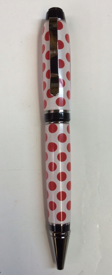

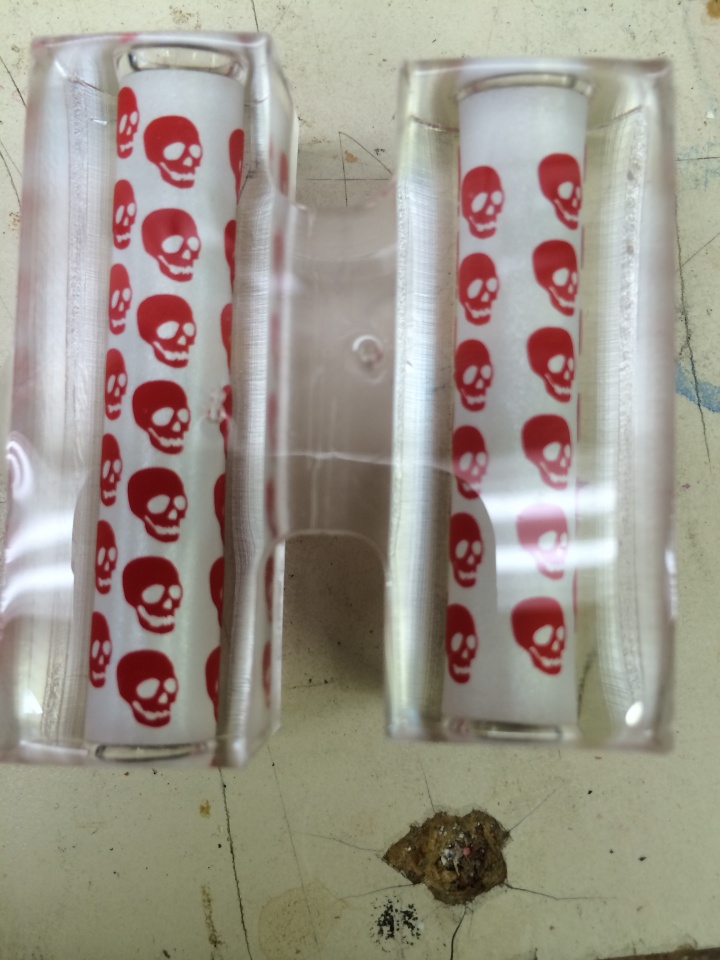

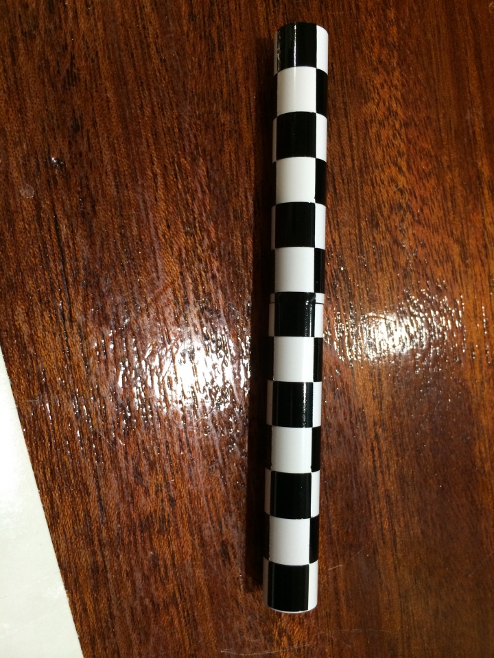

I use Oracal 651 and it works great. Don't have to CA over the top, presuming you aren't covering the whole tube (haven't tried that).
You will need a real low tack release paper, which takes as much experimentation than everything else.
These were painted tubes then the vinyl put on top. If you have good paint adhesion, you won't have an issue with the transfer tape peeling up the paint when you remove it.
