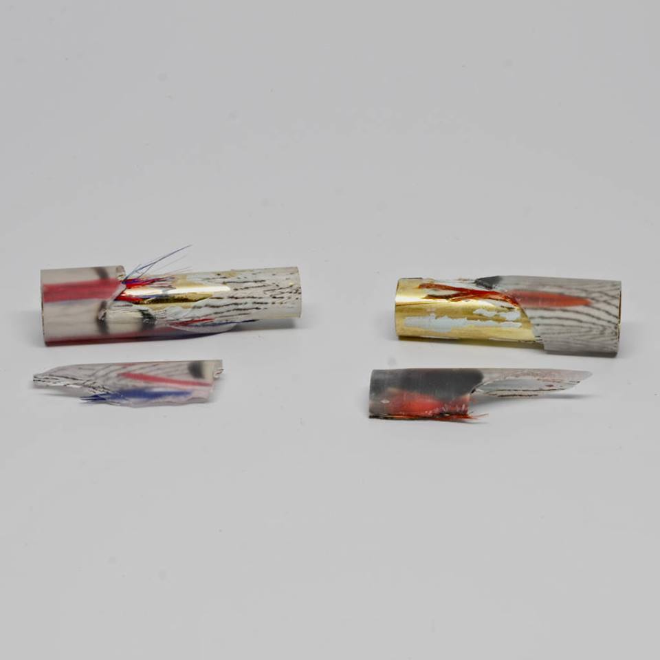

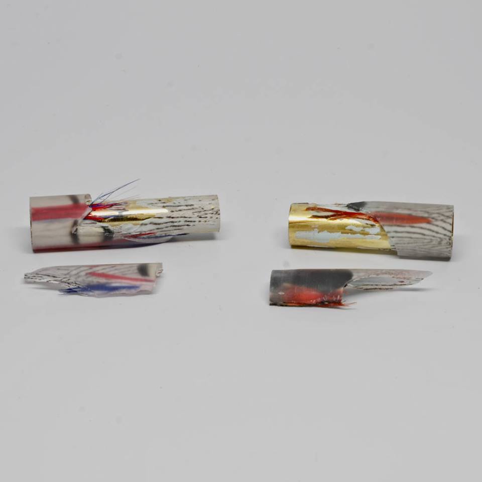

Sigh. It was a bad weekend for expensive blanks

It was just not my weekend.

I feel your pain although I've messed up some very nice blanks I don't think they were quite that nice. I remind myself to slow down and make sure the tools are sharp.

I wish I could say what happened. I turned 2 sets just fine and then proceeded to blow up a cap from one and a body from another. Unfortunately different feathers so I couldn't combine them. Good sharp tools that were perfectly fine both before and after these happened. I must have been distracted but honestly I didn't even feel much of a catch on either one.
I'll end up pairing the parts that didn't blow up with either some solid black or solid white to at least finish the pens.

Not sure really. I turned a bunch of PR over the weened and these 2 halves were the only two I had failures with. It could have been anything really but I'm sure the second one was directly related to my frame of mind after blowing up the first one.
Sometimes I have a hard time making myself just walk away from the shop when I should.
I had one of these in particular made up special too. I really feel bad for wasting Marla's time and efforts as the blanks were absolutely beautiful.

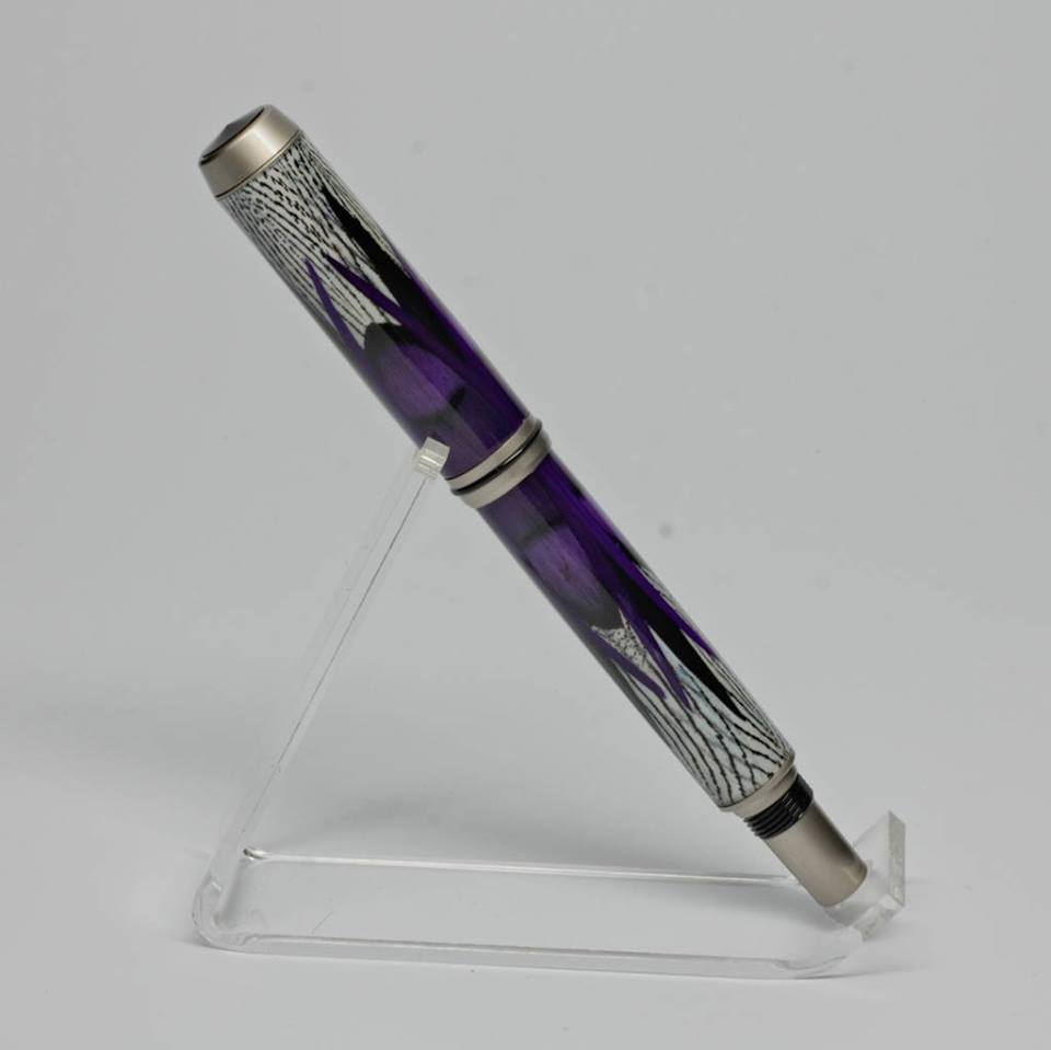

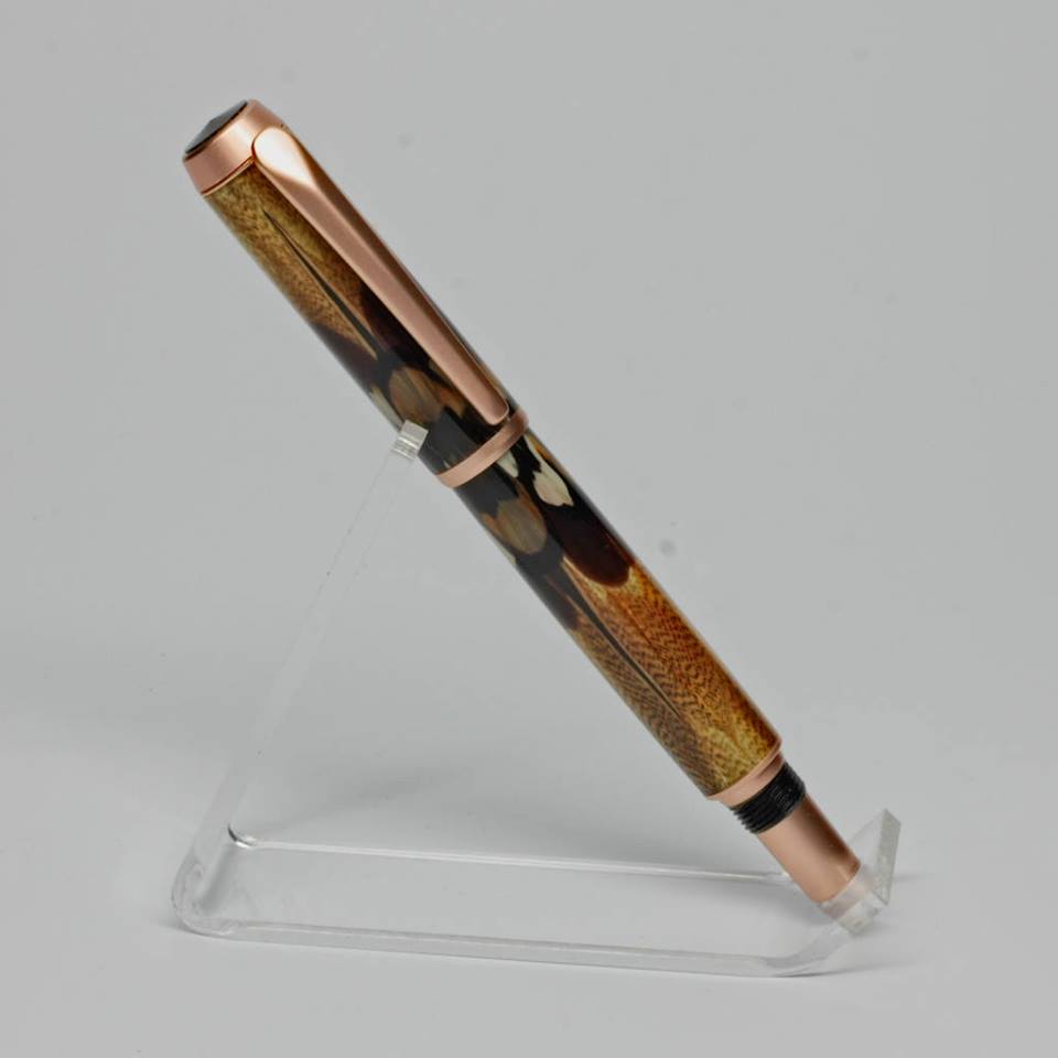

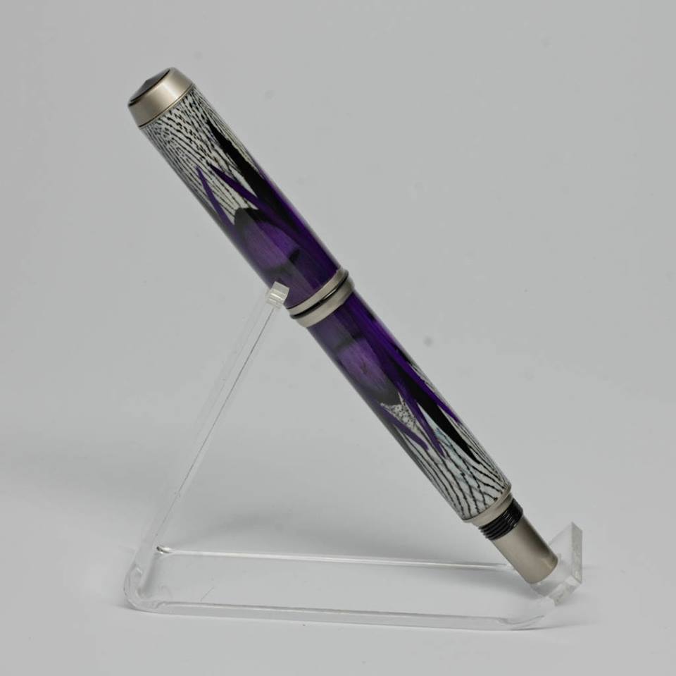

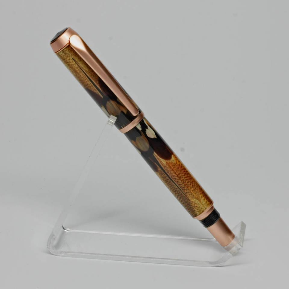

Don't be afraid of turning them. Here are 2 of the intended 4 that did work this weekend.

You may have done nothing wrong at all... sometimes you may have a fracture in the blank that's invisible to the naked eye and it just blows... BTDT.

I always clean and sand the tubes prior to gluing. I've found that we have fewer blowouts when I take the few minutes to add these steps. My belief is it sanded tubes get better glue adherence.
From the pictures, it looks like these tubes were not sanded.
