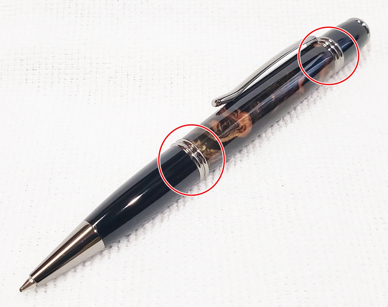

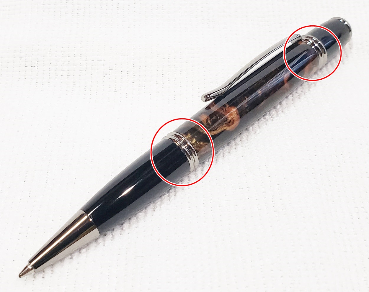

I've made many of both. I like them both, but slightly prefer the Gatsby simply because it's a little more forgiving. Because of the "beads" on the tip coupler and clip assembly, the final diameter isn't as critical. However, there are more versions of the Sierra available. It's a tough call.
There is also the Gatsby Grande, which is a larger diameter. But because it uses a smaller 3/8" drill bit, the material is thicker. Can be better for translucent acrylics.

I agree with Jim on the lower section 'beads' being more forgiving for the blank-component transition. 👍
