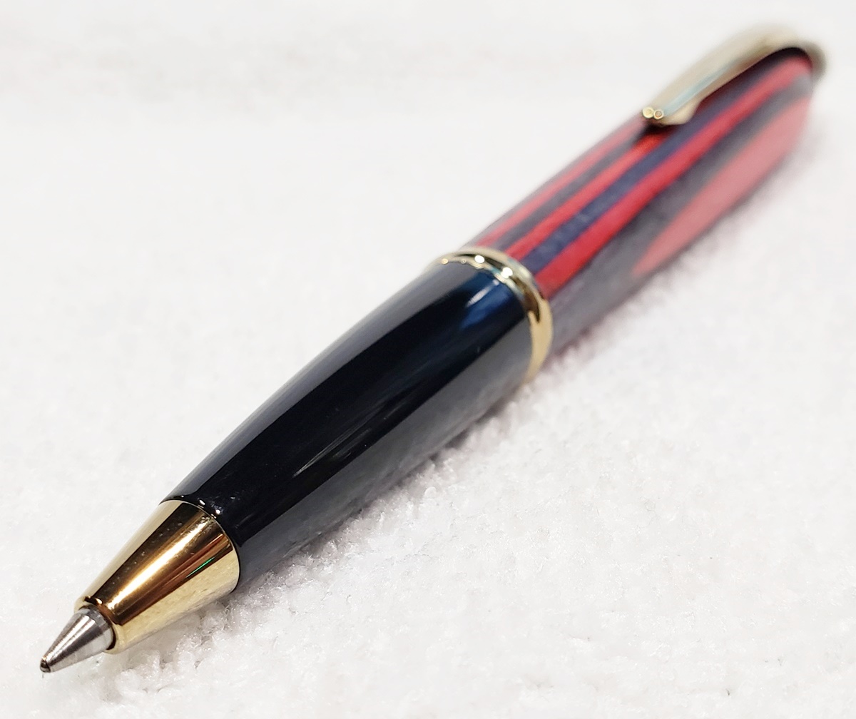

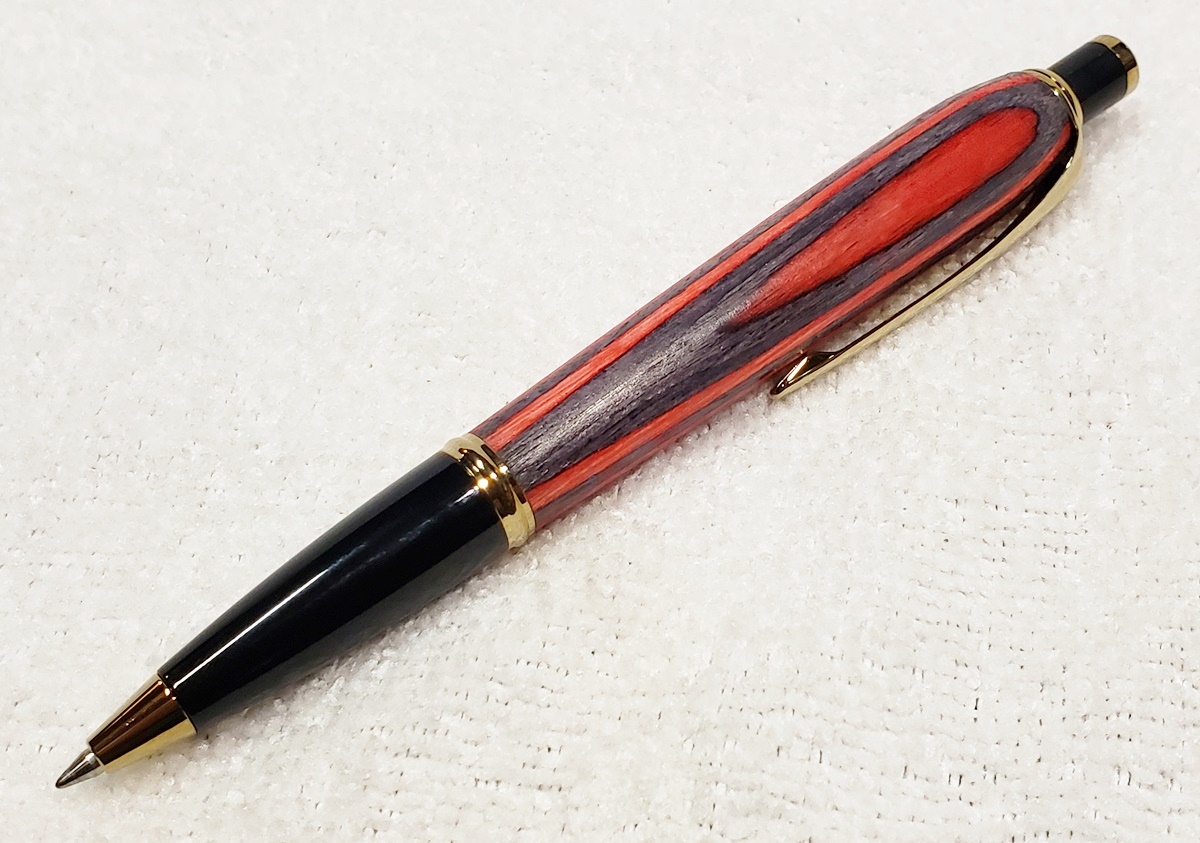

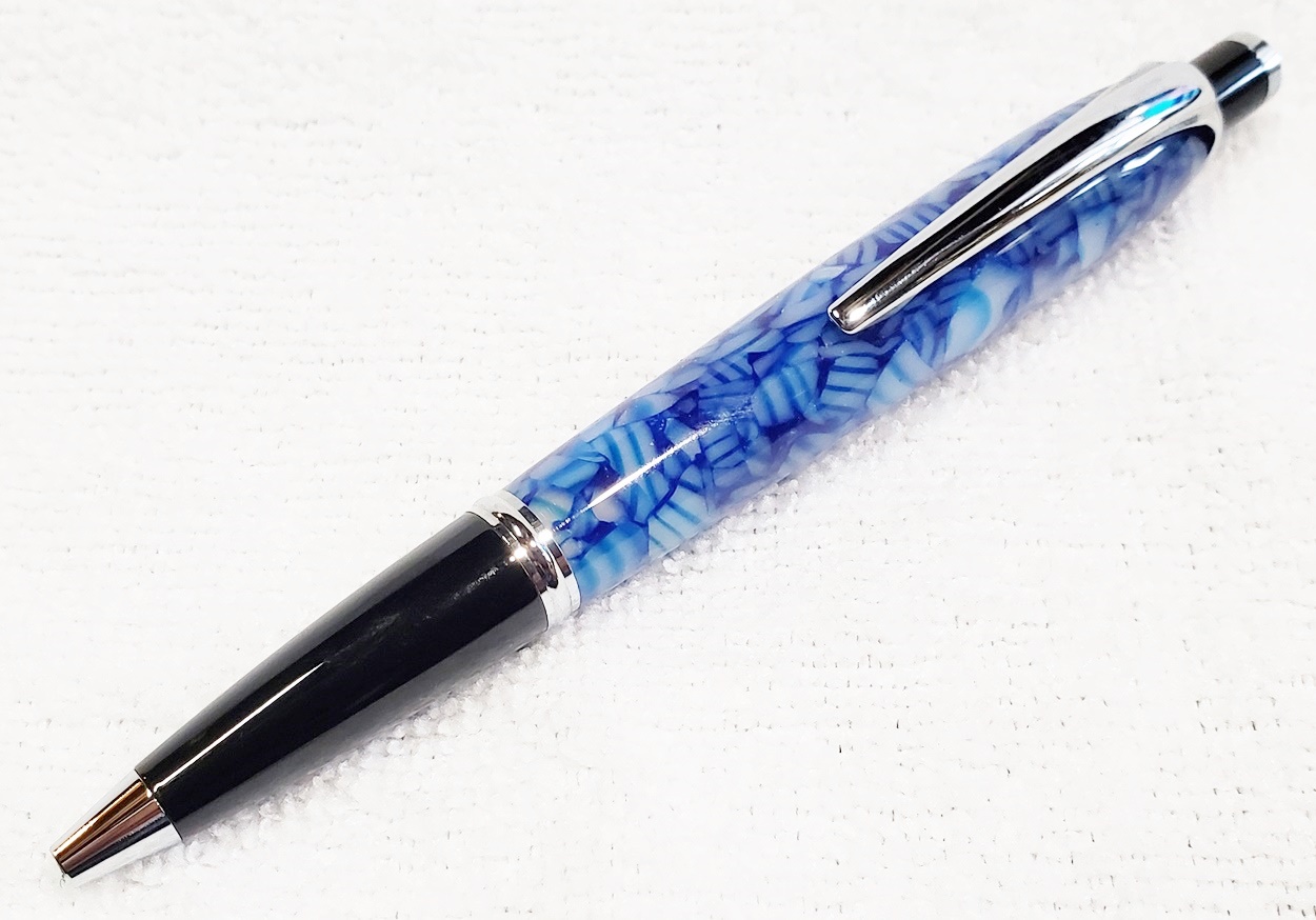

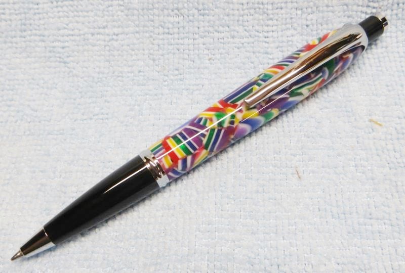

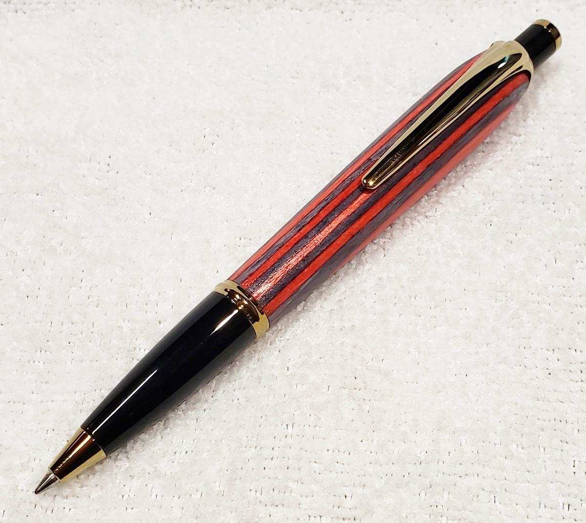

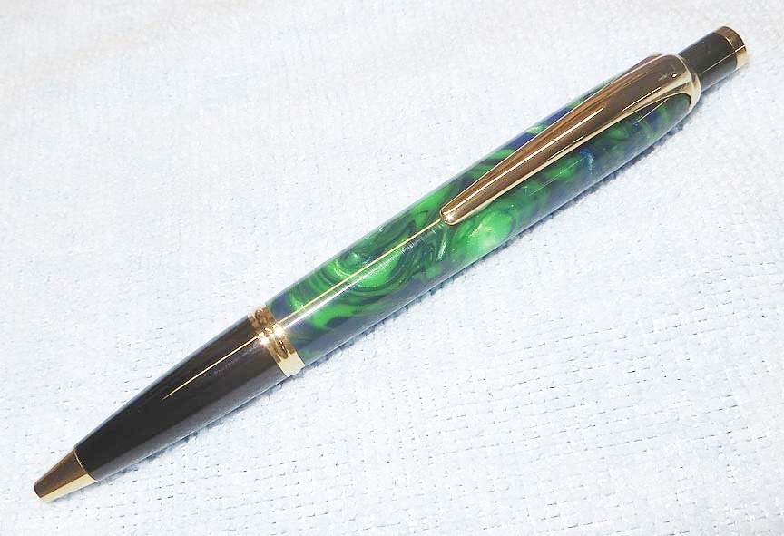

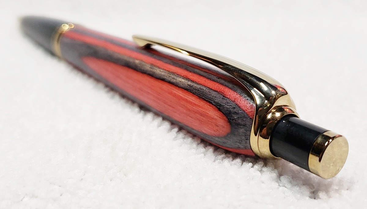

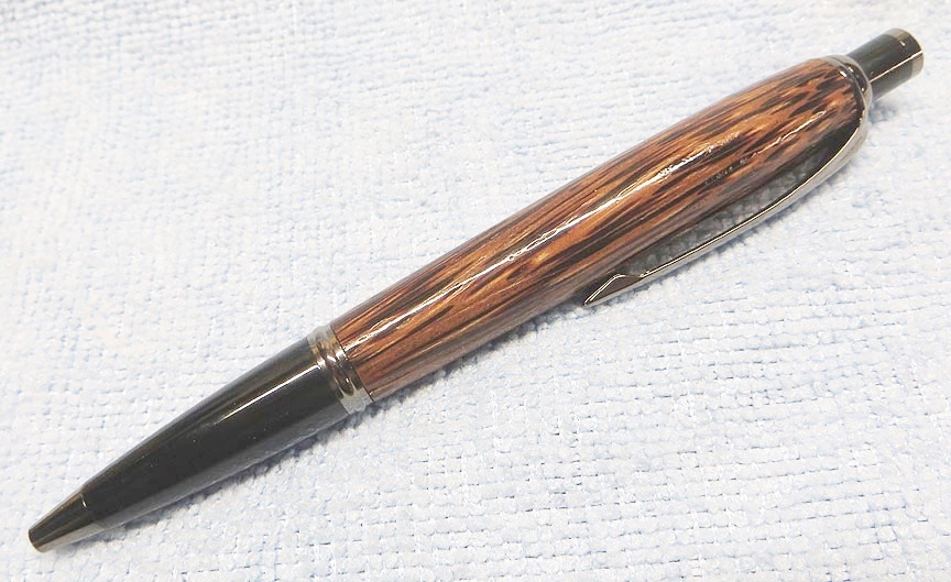

I can't answer the questions about Sierra pens, but don't need to, Mal's responses are quite thorough. However, I have made a few Compsons, and really like them. I like the shape of the body, it reminds me of "old fashioned" click pens. They use the old three-piece click mechanism. I haven't had one fail, but haven't used one as much as I have some other click pens. None of the recipients of the Compsons I've made have reported any problems, but I don't know how much they've been used.

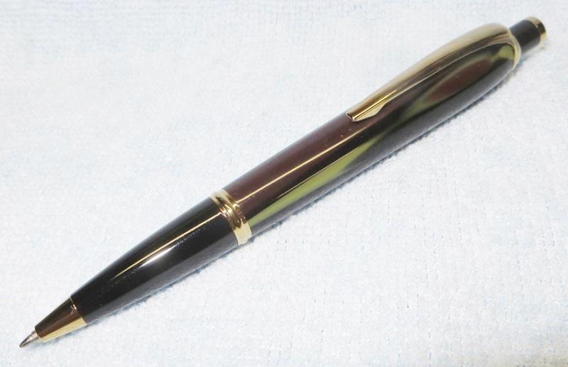

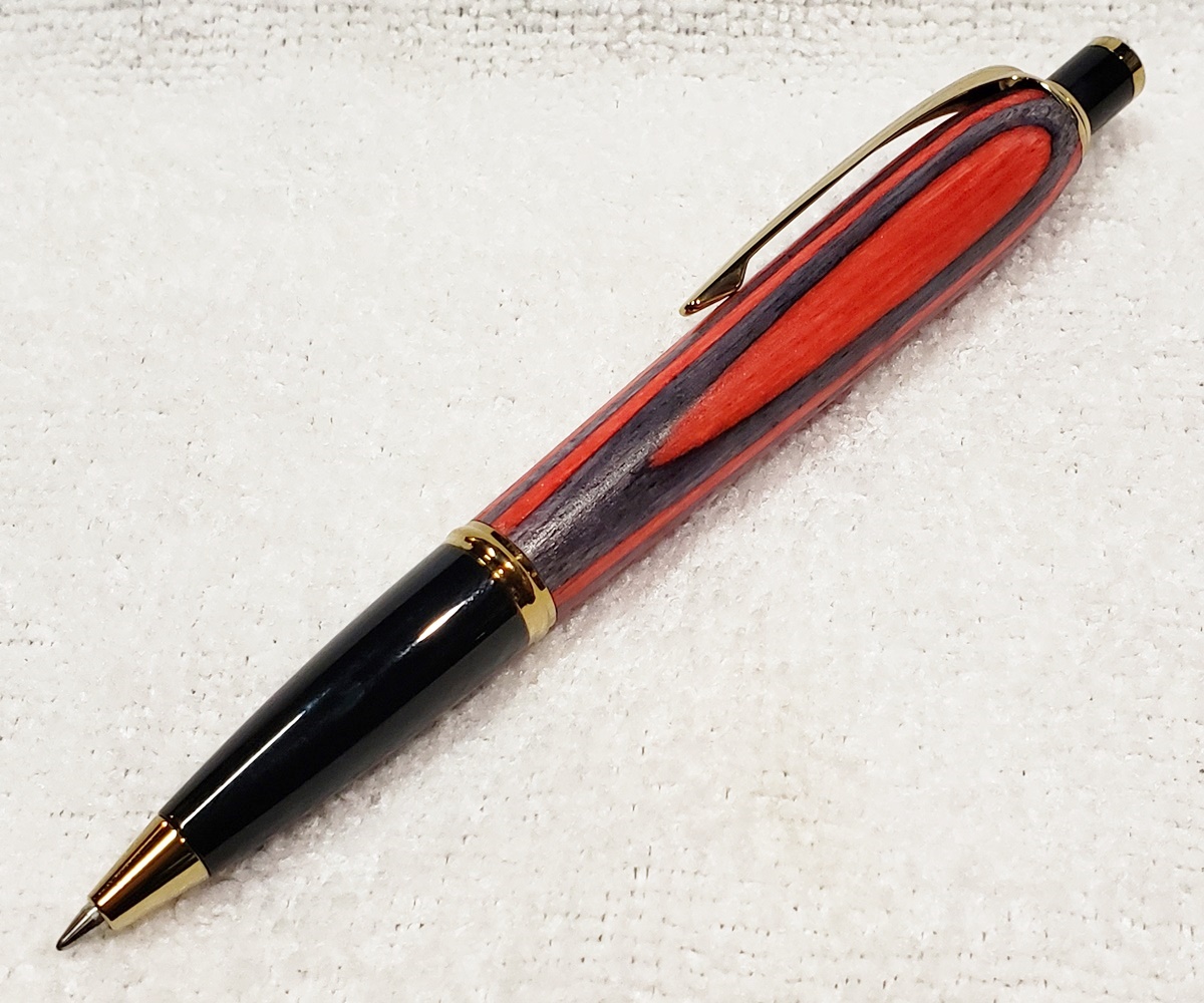

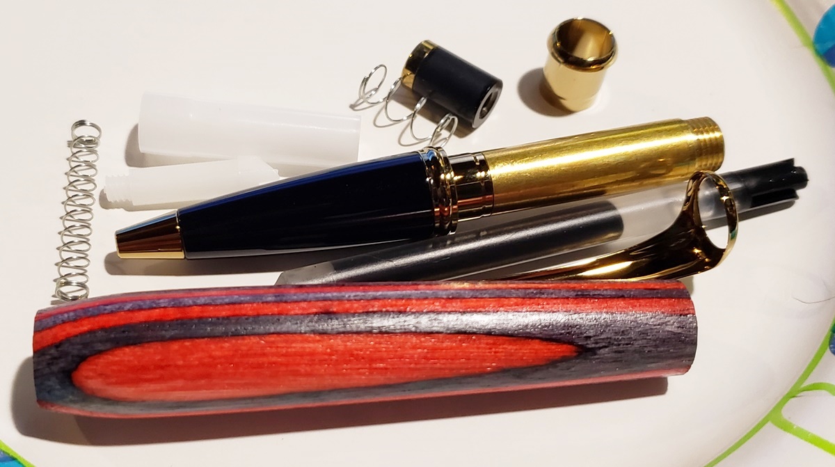

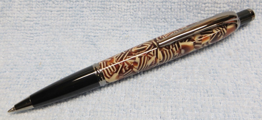

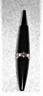

john you can modified the sierra super click when you get your metal lathe up and going, you'll have to change out the nib and turn down the nib coupler, the blank then goes to 3 1/8 " long, parts needed a carbara nib in the same color they don't have nickel but gun metal, gold and chrome are a perfect match sierra 3.JPGsierra 2.JPGsierra 1.JPGzx3.JPG
Lots of good info here. Jim thanks for posting those photos. That is a different look to shape of any pen kit. Interesting. I may just place an order with Exotics for a few of these to play around with. Thanks everyone. Mal very intensive reply. Well done and thanks for taking the time.
