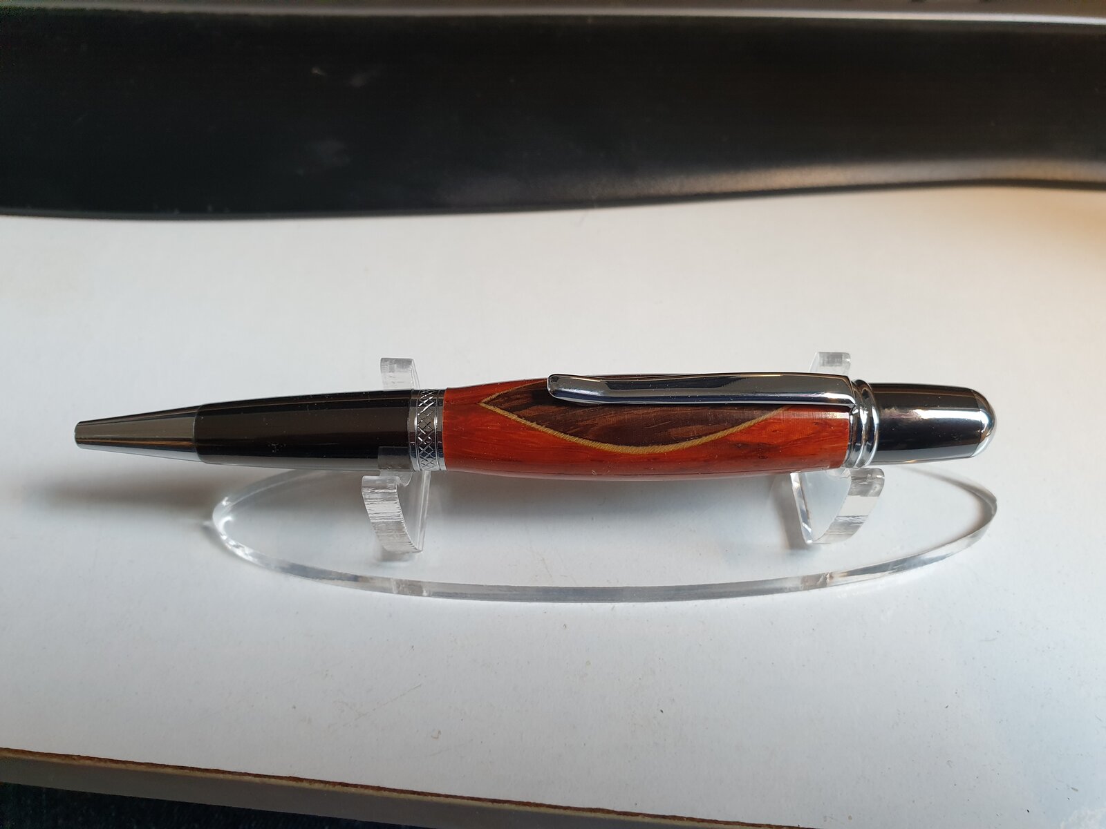

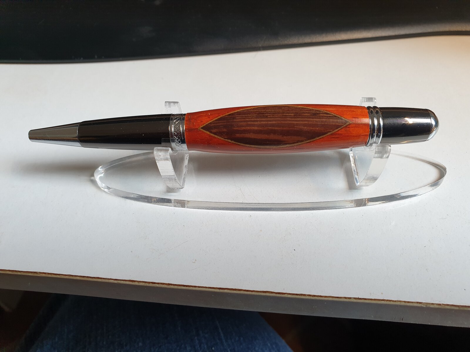

sierra pen looking back at me
See more from peter1958
peter1958
Dec 11, 2020
230
Netherlands
Wenge, padauk and veneer. CA finish.
Very interesting and you've hidden how you accomplished it very well!
It just opened the eye.... LOL The trick is a holesaw (92 mm) and 3 blanks. First a piece of wenge 1 inch by 1 inch, 3 inches long cut from 2 sides to make the eye. I don't cut completely through the wood, 1/32 is left. When done the wood breaks easy and the eye is carfully sanded.
Then 2 blanks 3/4 square and long enough for the sierra. carefully cutting a little too much out of the side (86mm holesaw). With a thin veneer between it fits perfectly. On the discsander the padauk blanks are sanded until it fits perfectly, Slowly is a must!!! Clamping all together and thin ca glue over all joints. let it soak in and another bit of ca glue. thats all.... drilling and so on.
