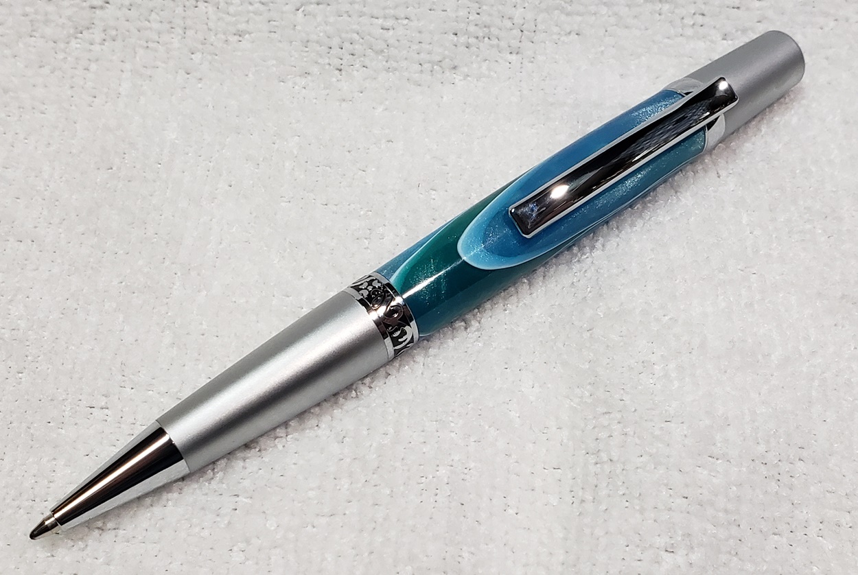

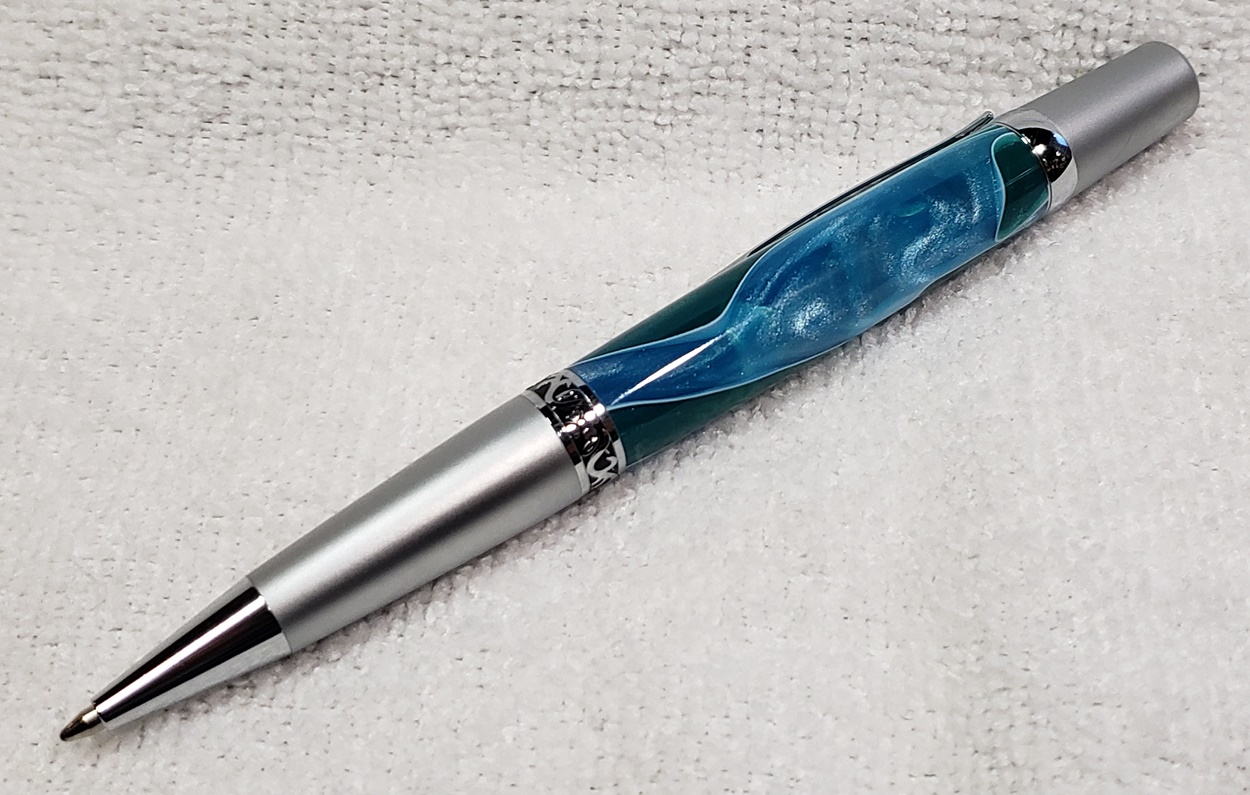

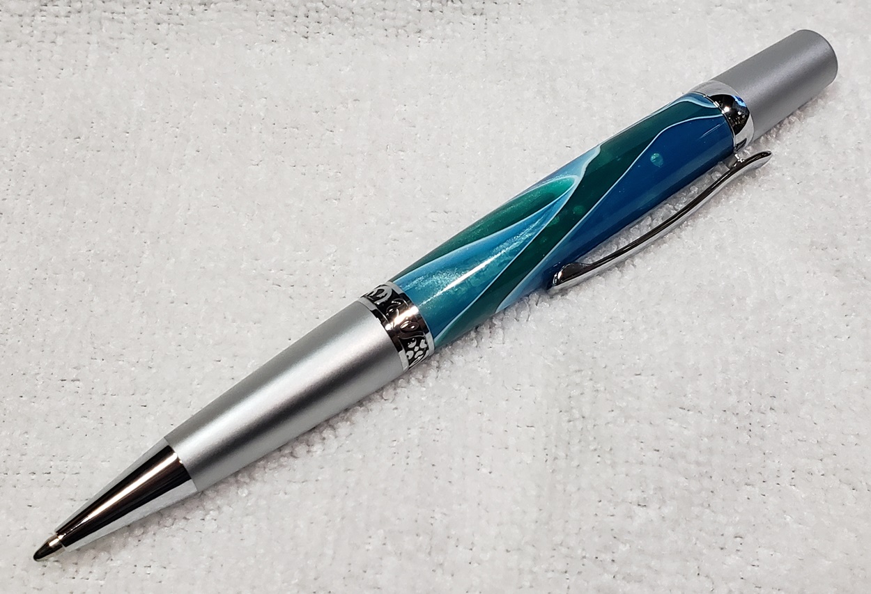

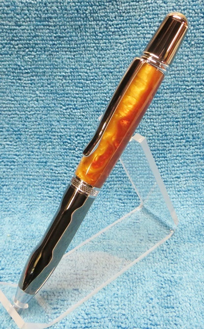

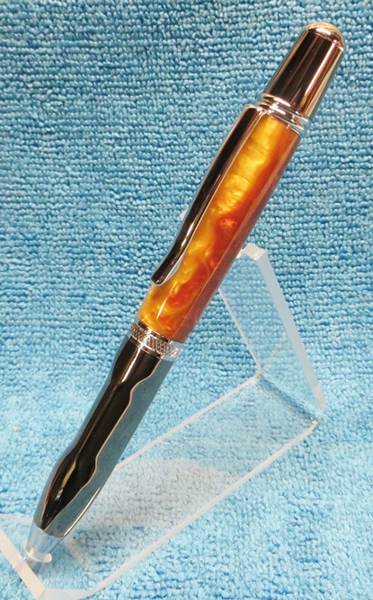

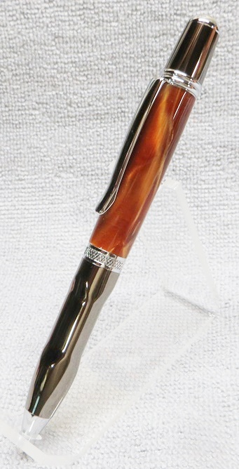

Here are a couple of Sierra Grip pens, which also us 20A bushings. In my opinion, both ends of the body should be turned to the same diameter. The tip end should be relatively the same diameter as the "trim ring". The finial end should be smaller than the "rings".

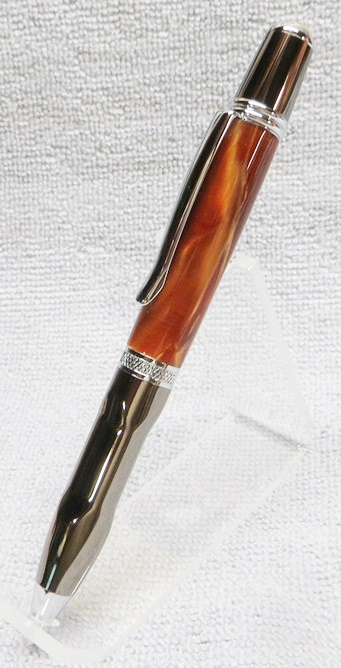

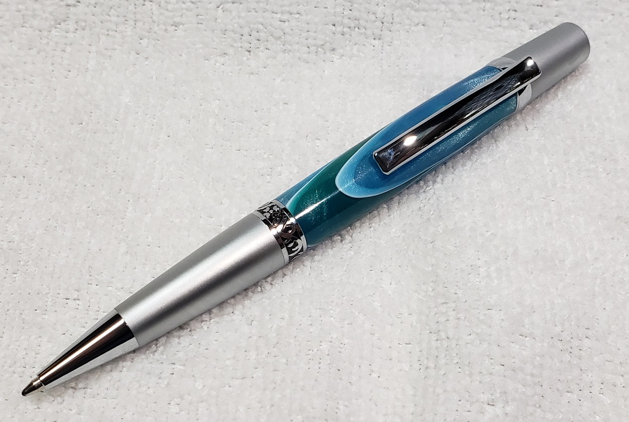

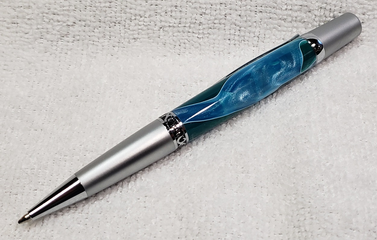

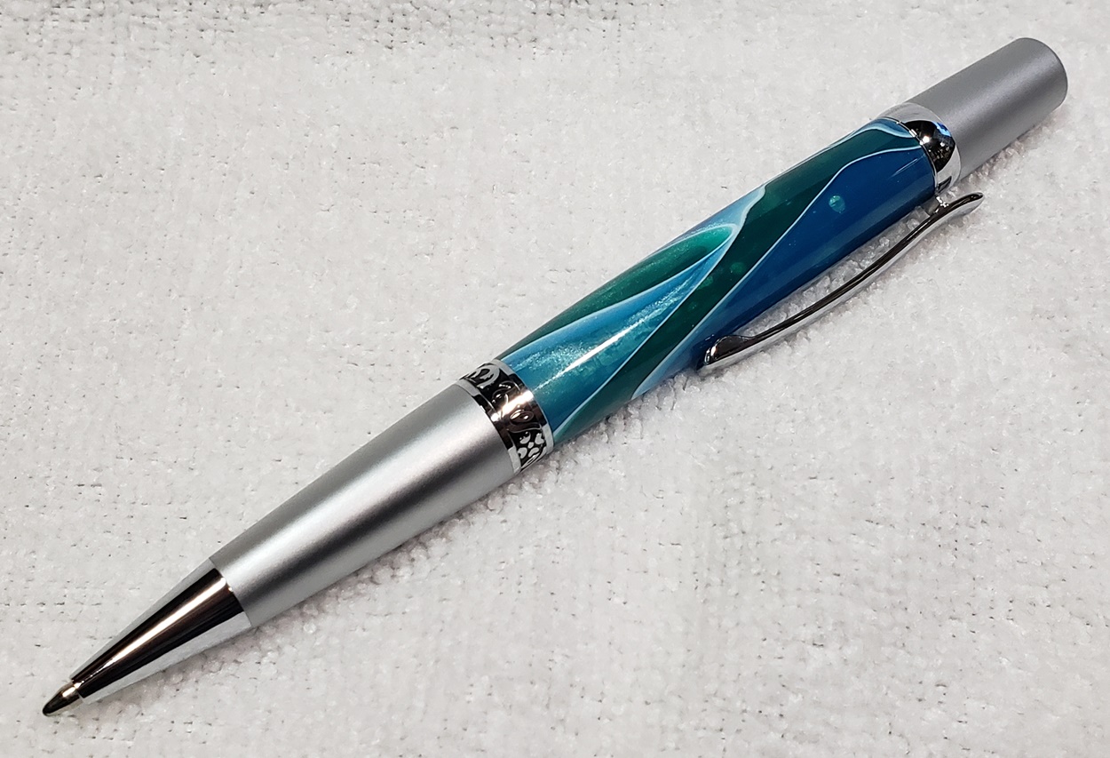

This is a Woodcraft Wall Street II, which is a Berea Sierra Elegant, I believe. I did use 20A bushings to turn it. Same thing, both ends of the body are the same diameter.
