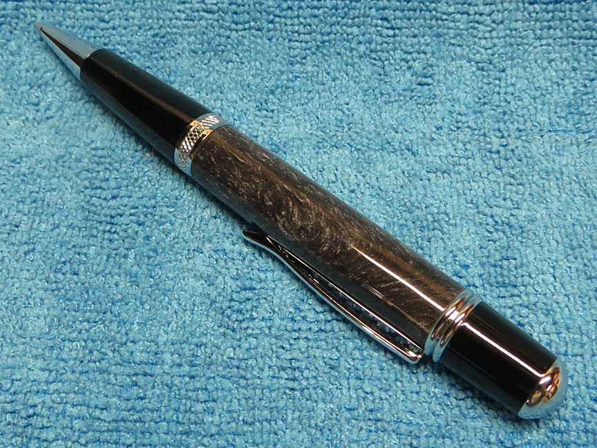

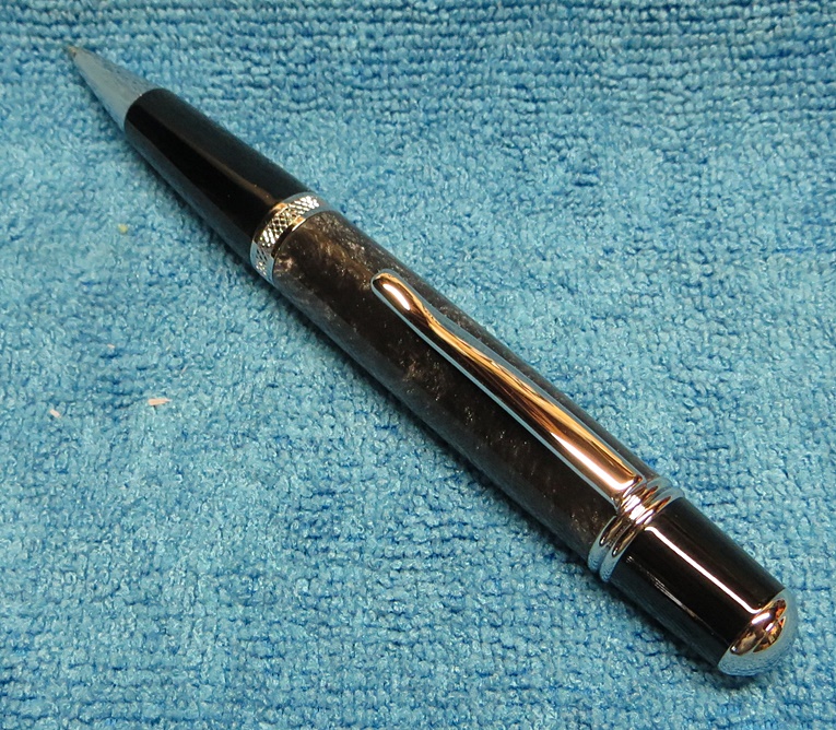

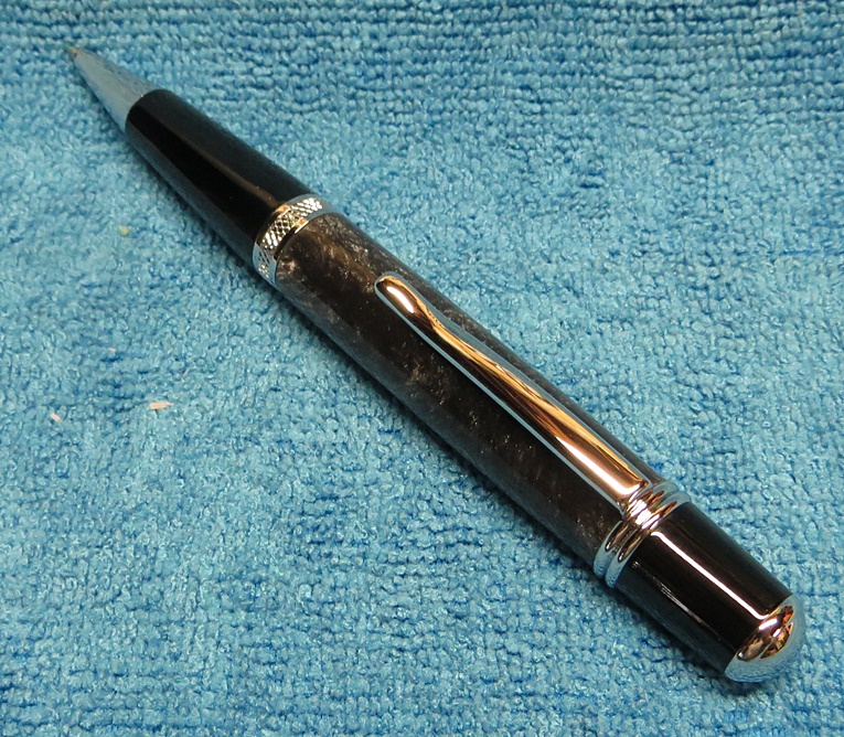

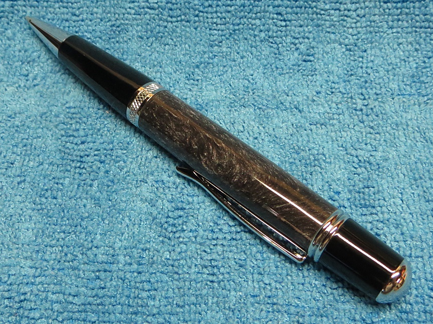

I recently turned a Wallstreet III, and the Woodcraft instructions say that the bushings are the same diameter. But the Berea instructions for the Sierra Vista say that the bushings are different diameters. I just measured my WS III bushings, and one is .525", the other is .524".
http://www2.woodcraft.com/PDF/77C67 WallStreet III Pen Kit Instructions.pdf
http://www.bereahardwoods.com/pdf/SierraVistaPen.pdf
