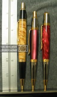

Here's a comparison view
long click version is ~ 5 3/4", short click version is ~5 1/4" and twist is ~5 3/16"
Edit to add re long version refills: Out of the box Uni-ball refill (available at Walmart or Staples) worked just fine as replacement for provided Parker clone refill + 1 of the spacers (they send an extra in the kit). Out of the box Pilot G-2 would not work (pen tip would not extend). I didn't monkey with it to see what the problem might be -- just my experience with stock refills.
Edit (again)...: other posts say a Pilot G-2 refill can be used, too. My long version could well be a bit "off" and that is the reason the G-2 didn't work in my pen. IMO the long version doesn't fit well in a pocket so I only make the short versions now and, of course, limited to Parker ballpoints or gels. Further, on my long version the Parker brand ballpoint and gel refills extend past the nib when retracted (hole on refill top is a bit smaller in diameter and the spacer doesn't fully insert like it does on the clone). Parker branded refills work fine on the short version.
long click version is ~ 5 3/4", short click version is 5 3/16" and twist is a bit over 5 1/8"
Jim
Thanks for the picture that is great. Looking at all 3 The long click does seem abit too long but the short click looks too short especially with the clip overpowering the blank. Is there a way to make the click look like the sierra twist and what refill can be used???

John, none that I know of....you could grind the spacer and make something between the long and the short but still stuck with a clip designed for a longer pen (tell you the truth I've never noticed the overpowering clip before -- now I will every time probably!).
Search for "long click" pens on the forum -- those look nice but I've never tried one (and I don't know the source).
I'll stick with the short version Sierras especially in the premium two-tone platings (and I get those from Ernie, too) until I find something better.
Good luck!
P.S. I use the procedure Ken referred to to make the short version. You can go as long as 1.91 but trim as short as 1.83 and the point won't fully retract DAMHIKT!
