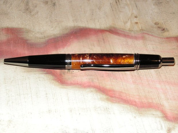

Does anyone have a photo of a sierra click that has been cut down and one that has not side by side.??? I think I saw one cut down and it looks like the clip looks too big on the pen blank. Not proportioned right. Thanks. Not sure I like it. May have to grow on me.

here is a shortened 1

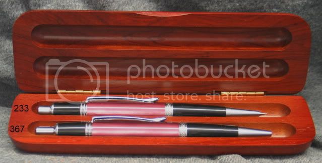

John, I agree the clip somewhat overpowers the blank on the short version but I still prefer it over the longer click. Short version is also a better match for the Sierra click pencil if you make a pen/pencil set.
One last thing: I think the Sierra click springs are a bit weak and even with stretching the pen seems to have a "too loose" click operation. Wood-N-Whimisies sells replacement springs for Parker style refills and these are much stiffer in my experience. At only $0.15 each, I replace all the Sierra click kit springs with those from W-N-W. Replacement springs are about 2/3 down on this page (item XPARKSP):
http://www.woodnwhimsies.com/pparts.html
Short version click and Sierra click pencil (per kit instructions -- 1.77" tube) FYI, too:
