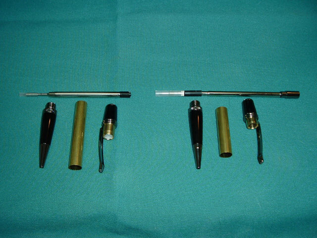

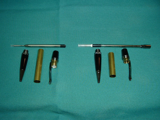

A picture is worth a thousand words.
Here Lou,
Here is a click pen and a click pencil side by side. The tube for the pen is 2.420 and the pencil tube measures 1.758. It also appears that the pencil mechanism is very similar to that which is in a slimline pencil. Hope this helps.
