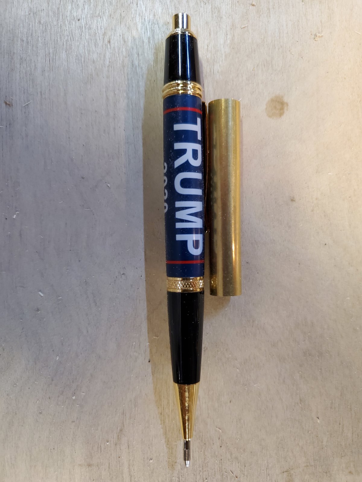

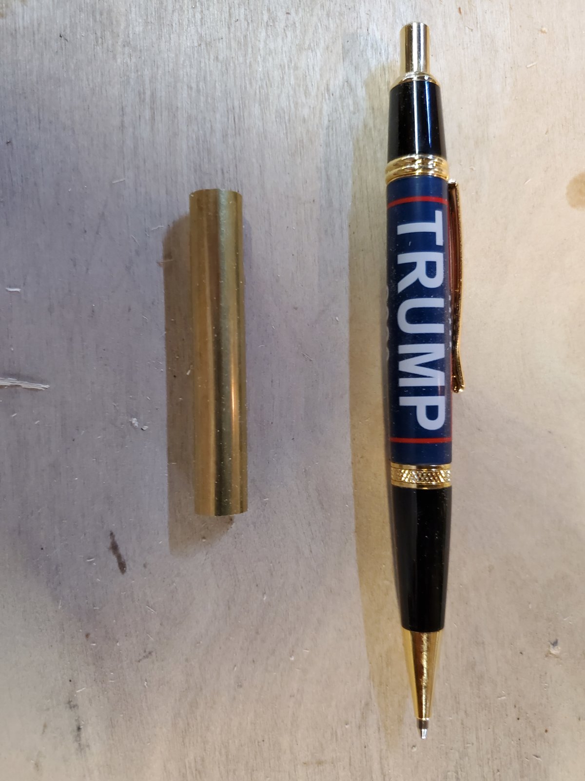

Oops. I bought a couple of Sierra blanks and as most of my customers prefer click pens rather than twist I got a couple of Sierra Click kits. Turned a blank, assembled the pen, and "Holy Over-extension Batman" something was wrong. It turns out that the tube for the click style is 2.42" and for the standard twist (and the blanks I purchased ) is 2.21". My bad for not checking the Tubes and Bushings app. Just posting so others may not make the same mistake. Back to the drawing board.

Dan, that is repairable, it would take some time, but it is one that you could try fixing. Or, you could keep it for personal use, and cut the refill a bit shorter.
