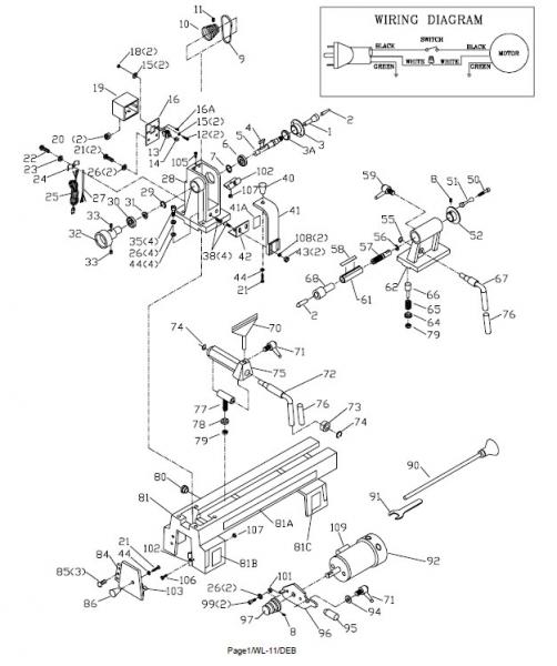

Here's a parts diagram and list:
http://www.mikestools.com/download/Delta-Parts-Lists/46-250-MIDI-Lathe-WL11.pdf
I'm thinking I might have to order the bearing. If I am looking at the chart right I only need one and a little instruction on how to get the old one out and the new one in. I loosened the pulley and tried it in a different spot and tried it tight and lose. It sounds better when the pulley is a little lose but it still makes more noise than before.
Thanks again.. Paul
