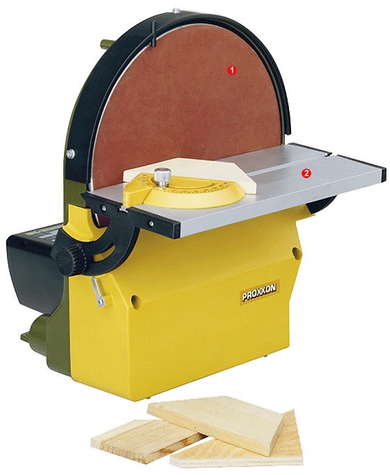

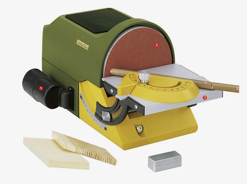

Anyone familiar with these. I use it as a dedicated blank trimmer with a Rick Herrell jig.

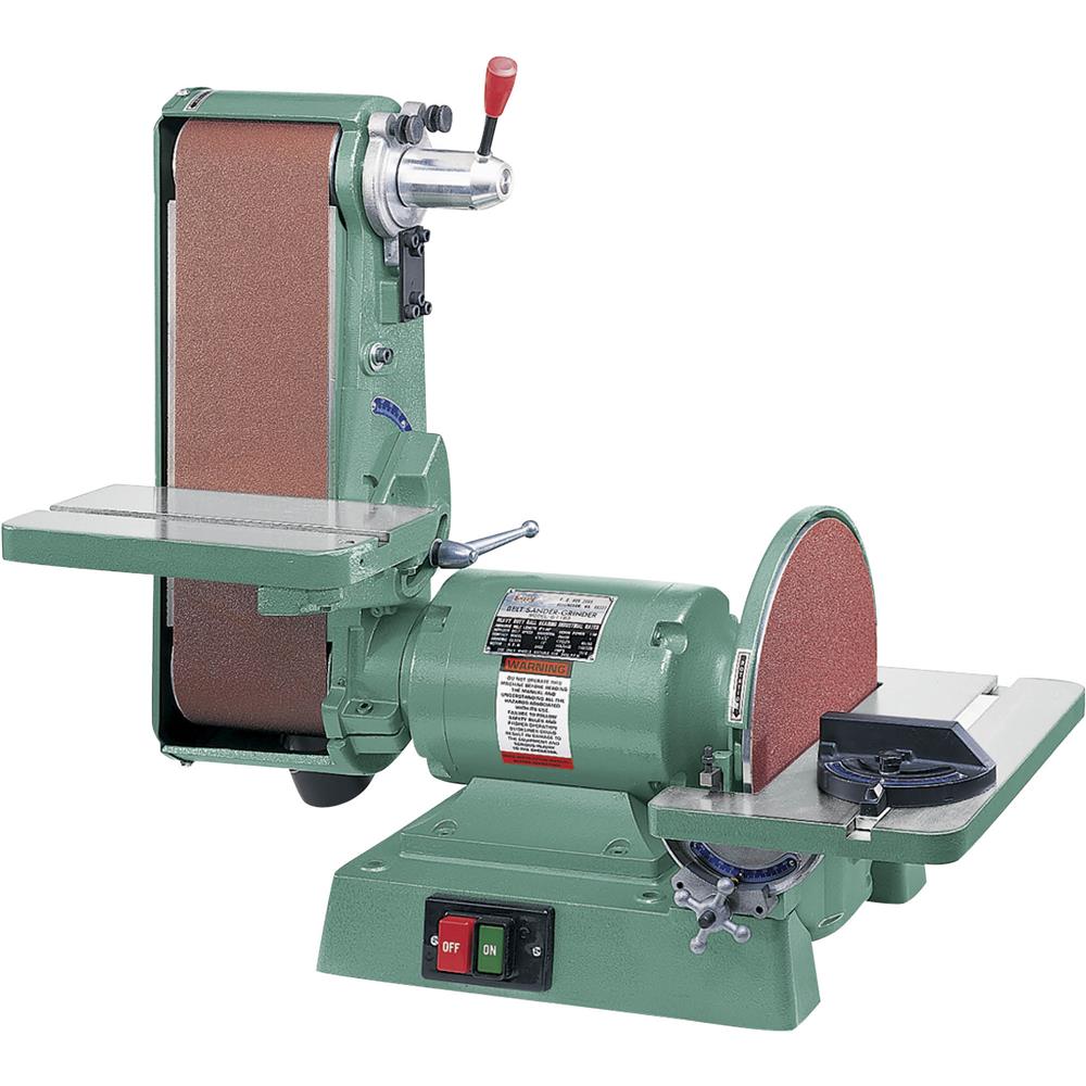

Well you likely won't care for mine. ;) It is a 6" x 48" belt / 12" disc sander from Grizzly.
That 6x48 w/12" disc is a nice size....had a couple in cabinet shops I worked in years ago.

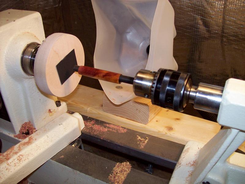

If space is that tight you should use your lathe. A disc on a faceplate and either a jig in the tailstock or a table mounted to the bed/tool post. It might take a few minutes to setup and take down but it doesn't use anymore space than you already use at the moment.
You could also mount a disc to the hand wheel on the outboard end of the headstock and leave a jig setup all the time. It would take up a little more space but less than a separate machine.
The lathe set up looks great. But again I prefer a dedicated trimmer. I am having benches built when I move... I should have room for whatever I need. For now I'm looking into disc sanders. I have no issue using barrel trimmers on a lathe. But like having a disc/jig to work on an almost or finished blank.

I thought about the Proxxon but want more HP. What do you feel is the smallest disc that is suitable for blank squaring with a jig. The Sorby belt "field" is too small. I don't mind having a belt/disc combo but a disc is enough for what I'm doing. I'm ok for price.
