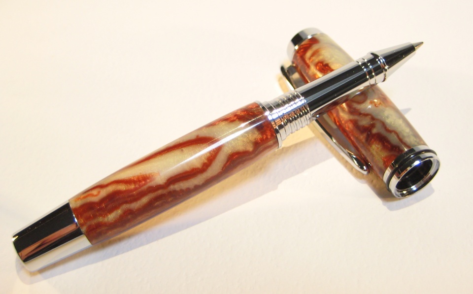

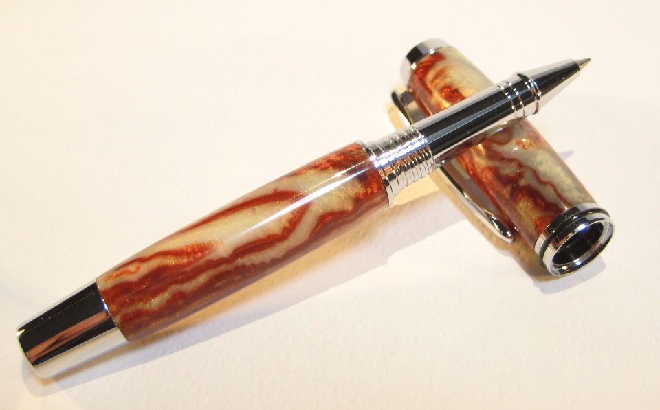

Shortened Jr. Gentleman II Rollerball Non Postable
An Opps after realizing I drilled the cap blank instead of the pen body blank with the 12.5 mm bit. Once I figured out my mistake I drilled the pen cap blank using the 10.5 mm bit. NO the blank for the Cap wasn't cut long enough to accomodate the true length of the brass for the body. I didn't think about how this would effect how the refill would fit in the pen body. Lucky it was about an 1/8" shortened and by cutting the spring in half it fit like I knew what i was doing.
