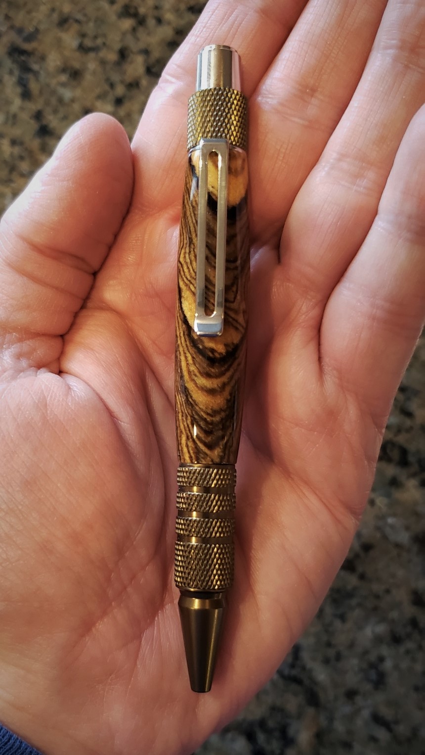

Another one of Mark Mayo's beauties. I shortened the EDC so as not to need the adapter (which I don't have an issue with). I may use this as my new carry pen given its smaller size.
10 coats of mercury thin flex CA and, 600 and 800 grit sandpaper, them off to then buffing wheels.
Thank you. About 12.5mms. I also had lined-up the grain and clip nicely; it must have moved when pressed together. I thought I had a grip on it.
Thanks folks!
I'm going to have to try that out, too. I don't have a problem with the spacer, and even like a longer blank, but can easily see a customer or gift recipient accidentally throwing it away or losing it. For what it's worth, sometimes I put some painter's tape on the clip. Also, that's a nice piece of bocote.
