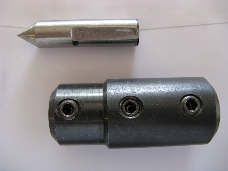

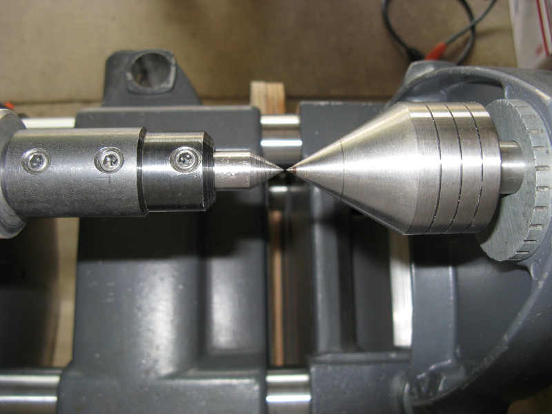

I made a drive center for turning between centers. It goes in a Shopsmith1/2" router chuck. I used a shoulder bolt so that I would have a better 1/2" diameter than I could make with hand tools.

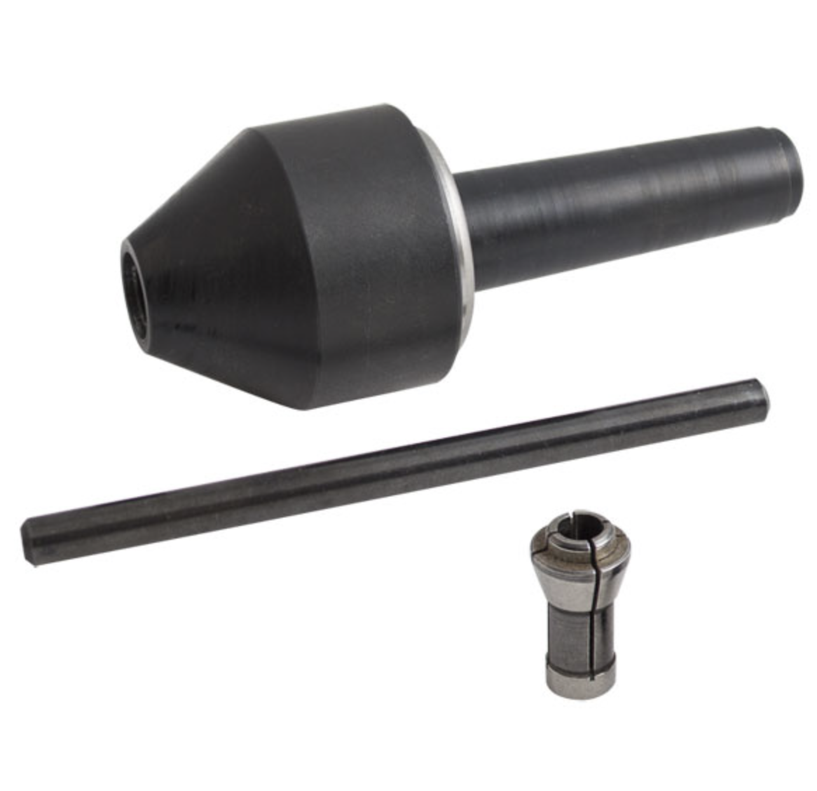

Regarding the mandrel saver, I found on at PSI, but it states it has a .245" bore, and my mandrel is 7 mm which is larger than that. Am I missing something?

If a 7mm slim line tubed blank fits the the mandrel may state 7mm but the actual diameter is 1/4".
