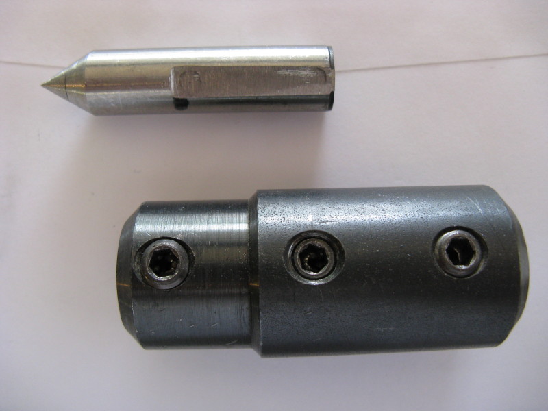

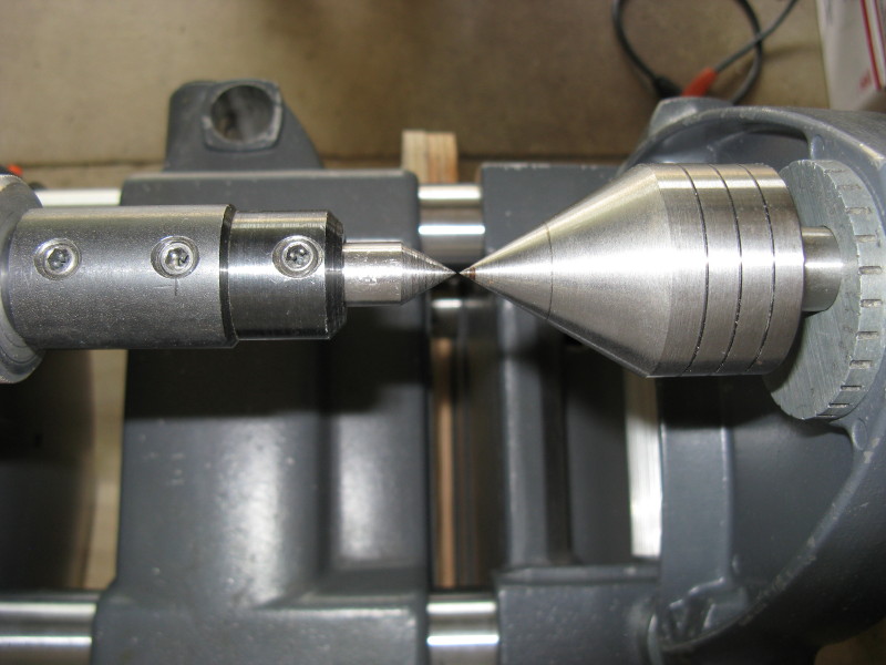

Here was my project for today. Make a dead center to use on my Shopsmith for turning between centers.
It uses the 1/2" router bit holder to hold my dead center made from a 1/2" by 2" socket head shoulder screw. I cut off the head and about a 1/4" for the threads. Then I put a flat on it to keep it centered and formed the 60˚ angle while it was held in the router bit holder and the Shopsmith was running at low speed. This allowed for the clearances between the the three parts, the Shopsmith, the router bit holder and the new center, to kept the center true. If you want more info, let me know and I'll post something under Jig and Fixtures.

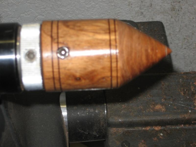

After reading all this, I changed the way I did things to what Kovalcik suggested.
A piece of mesquite drilled to 5/8" and drilled/tapped for a set screw. Then a 60* point turned on it.
Works pretty good and very easy to redress the point as it wears.
