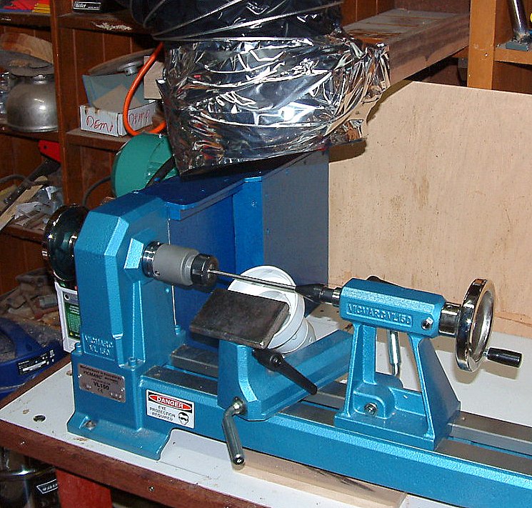

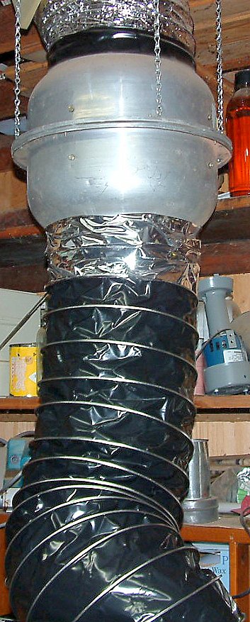

If you run the fan above the lathe it would serve a dual purpose to remove the fine dust to atmosphere.The silver covered tube leading to an inline fan runs to the outside for this purpose over my VicMarc VL150. the pic while I was installing the lathe in 2014.
Peter.
