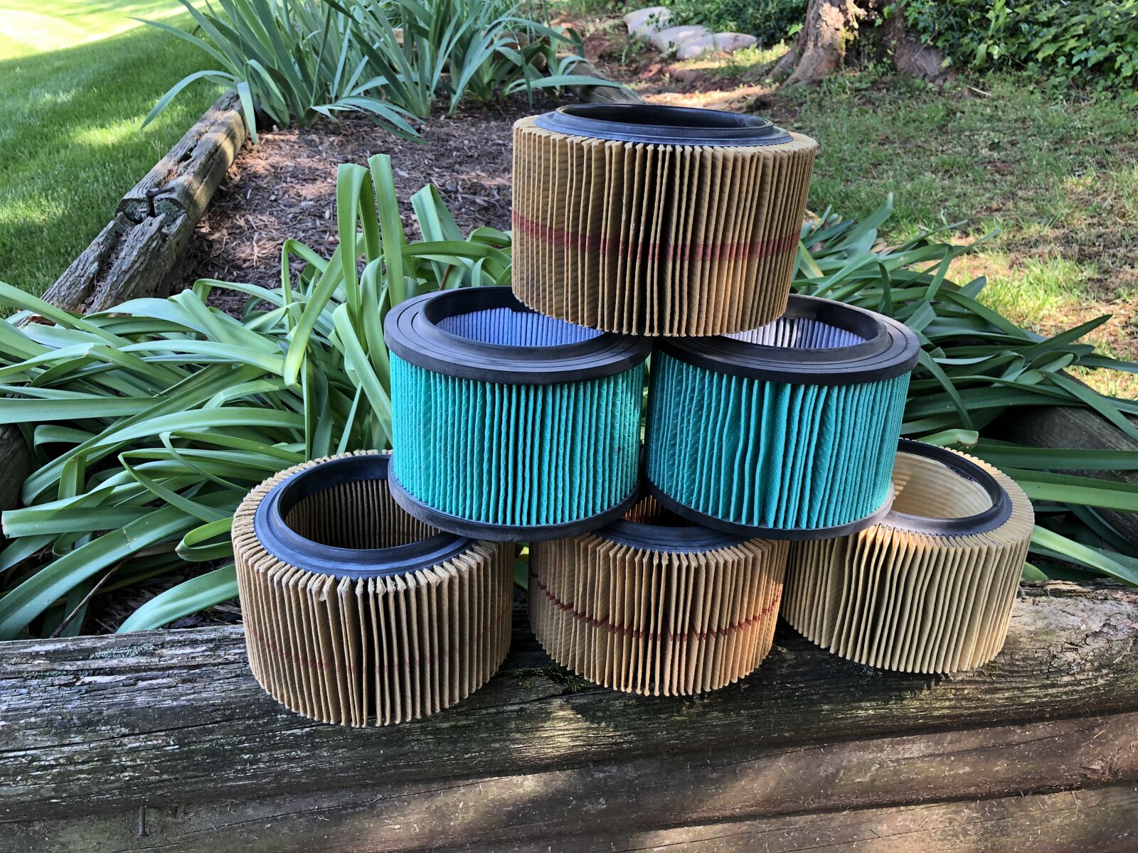

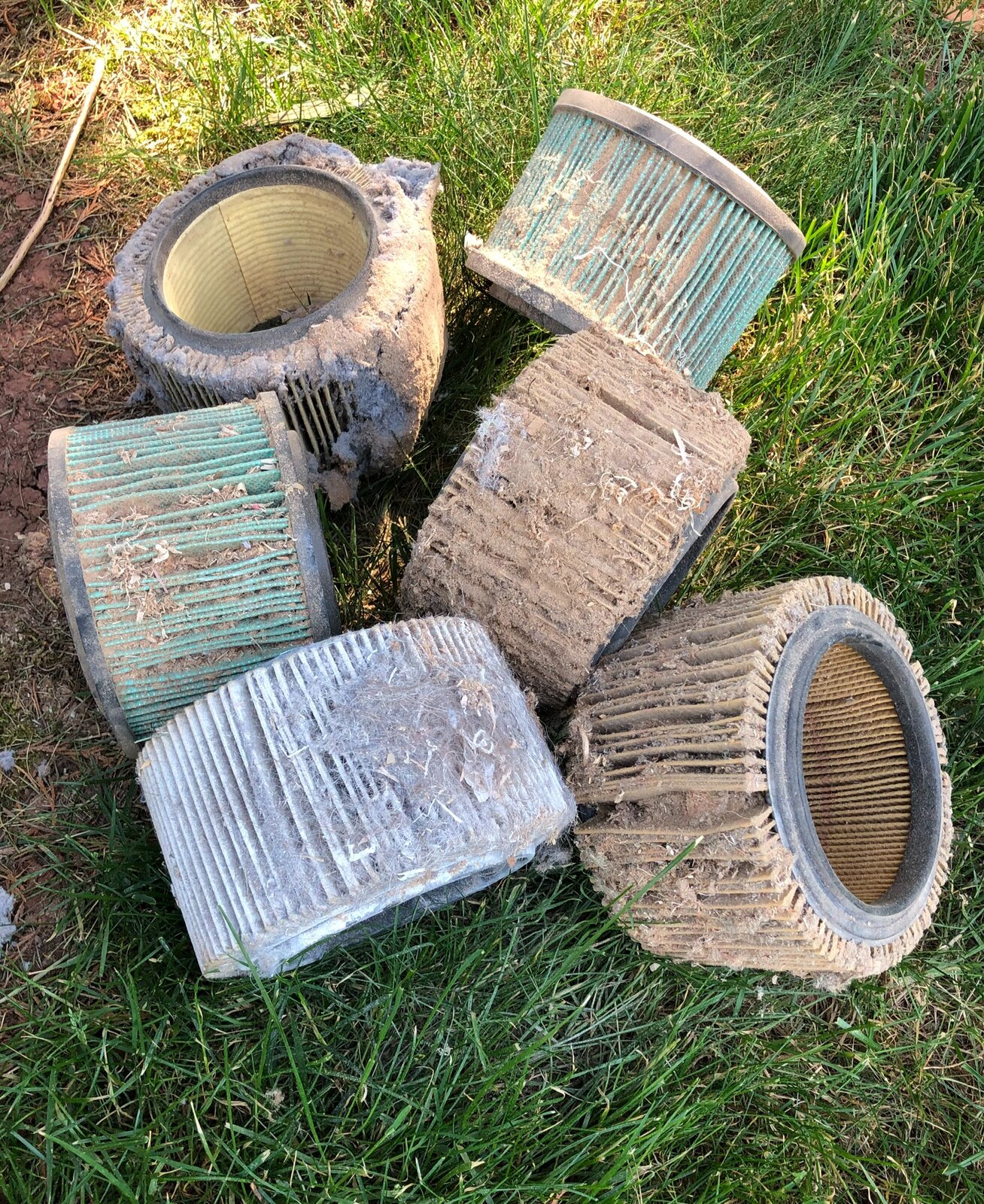

Well, it was that time again.....all my filters for one of my shop vacs were dirty and needed cleaning.
I pulled my air hose out to the backyard and went at it. I had dust mask, gloves and eye protection of course. Now I'm good to go again!

o_O Are you kidding me?? No way have I ever gotten mine that clean. Did you use a garden hose on them? I'd like to know your process Charlie. I've gotten the bulk of debris out of mine but, never that much. I'm going to build a trap like Marks someday. AND, thanks for reminding me it's time to clean the filter. ๐Ÿ˜

I gotta tell you Charlie, it's time for a cyclone. After a half barrel of dust I don't have anything even close to that much gunk in my filter. Like youI do blow my filter with compressed air in the yard.

This shop vac is a smaller vac and not hooked to any shop tool. It is one I use for vacuuming cars, home projects, getting behind the bandsaw every once in a while. One day it might be drywall dust, another day, it could be scraps of insulation or shop dust.
I simply used my air hose with 100 lbs pressure and blew the filters from different angles and from inside to outside till most all the dust/dirt was gone.
when I change filters in my vac, I blow out the vac, put the new filter in and power up the vac outside in case there is a little residual dust that might blow out before taking it in the house.
Two of my filters are Hepa rated and I will buy those in the future as I wear out some old ones.
