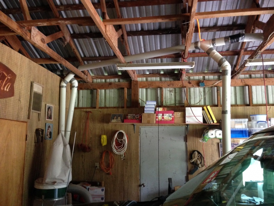

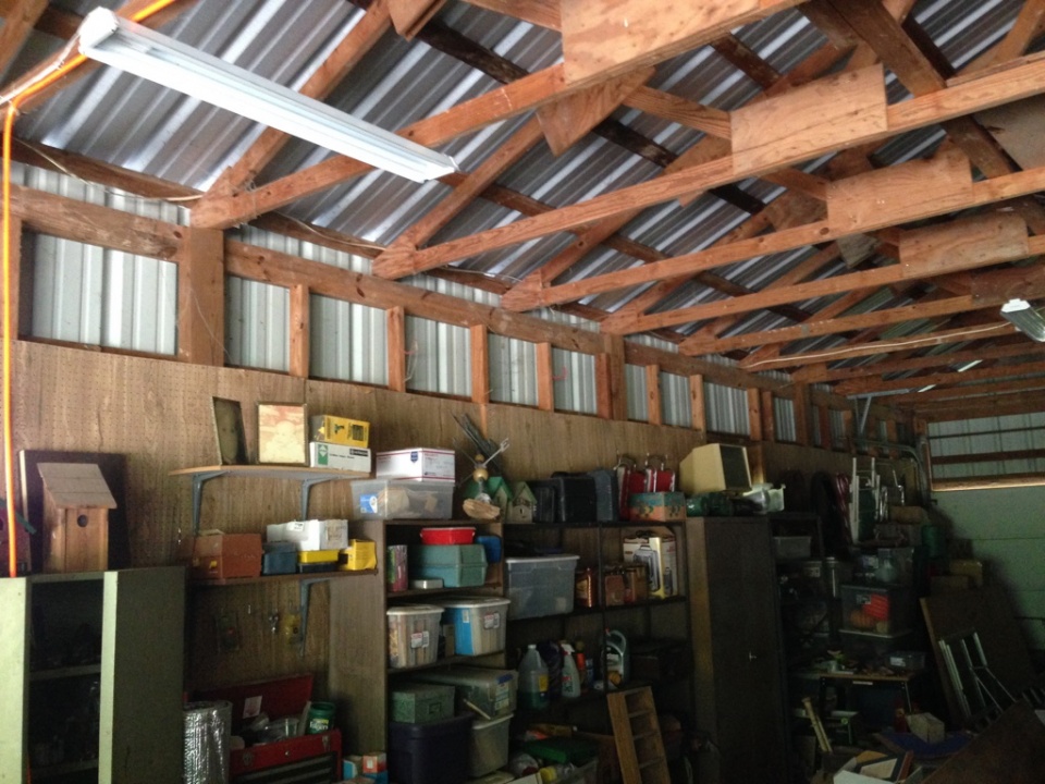

My garage/workshop is that same type of construction with 4x6 studs every 4'. After wiring it with LOTS of outlets, I used rolled fiber glass insulation & covered it with peg board all around. I walled off 1/4 of the building for a 15x25 wood shop & put peg board all around both sides of the interior wall and use a window A/C in that part of the building. Works fine in our gulf coast heat & humidity.

I have to correct my earlier post - the construction of my building is 4x6 posts every 10 feet with 2x4 studs every 24 inches. The sides are 10' high and I insulated & covered the walls up to 8'. I used peg board all around so I can hang stuff wherever I want & the extra 2' of stud extending above the pegboard makes it easy to mount shelves or other heavy stuff onto the studs or posts.
