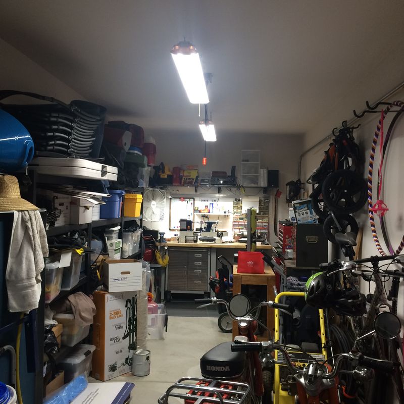

I have an extended 3.5 car garage that houses my shop, and I just finished a full LED light retrofit. I went from having 4 4' twin tube fluorescent fixtures to having 5 twin tube LED shop lights.
The quality of my lighting improved 100% going to the LED fixtures. My shop is now "daylight" bright, and I'm finding things I didn't even know I had!
I looked at both the Costco and Sam's Club LED shop lights, and I chose the Sam's product since it seemed better built and had a nice reflector. I used 1/4" toggle bolts through my dry walled ceiling and screwed 1/4" eye hooks into the toggles to support the new fixtures. The Sam's fixtures come with short hanging tabs. I also put one LED right over my bench/lathe.
At $36 per fixture they are a bargain and very easy to install:

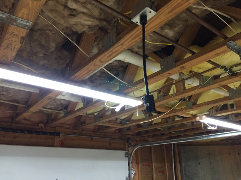

While I was rewiring the lighting set up, I also installed two "ceiling drop" cord. These cords hang from a ceiling box with strain relief, and provide a nice grounded outlet at a height of 6.5' off the floor. This makes it very easy to reach up and and plug in my band saw or shop vac, etc...

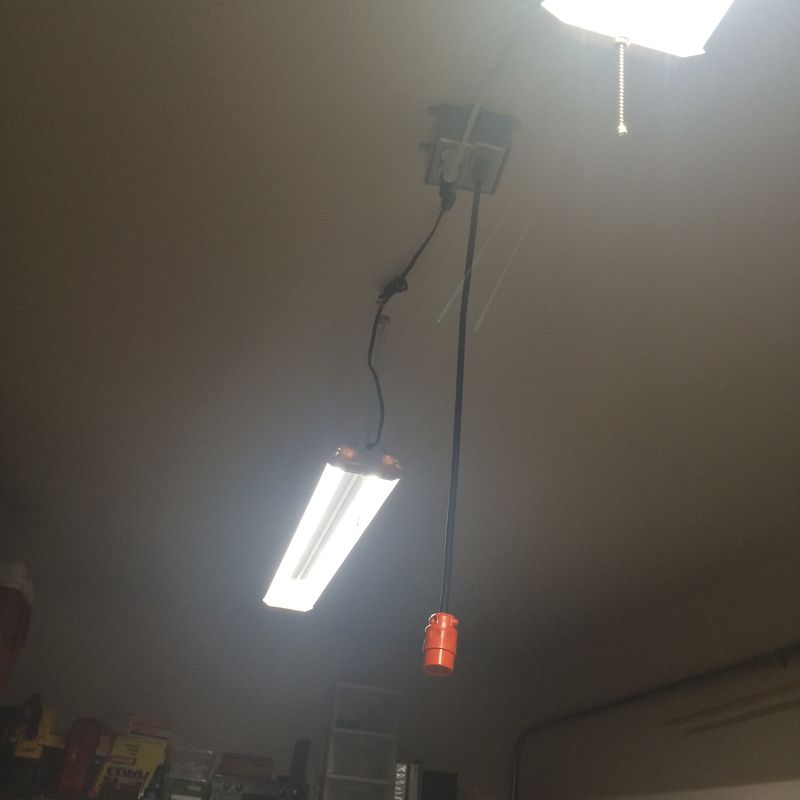

There is no reflector On the Costco unit and also, no on/off switch or pull chain. Just plug it in and it is on. I do have everything on a main switch but can't switch on or off individual units with out unplugging.
I added a pair of the LED tubes to one of my regular fluorescent fixtures and it was brighter and are supposed to last longer than fluorescent tubes and use less power. These do work with your existing ballast.

I simply made up the fixed length drop cords from parts at Home Depot. Buy one strain relief fitting, a heavy molded recepticle plug, and a length of 14-3 rubber insulated cord wire and you're all set. The strain relief threads into a standard 1/2" electrical box knockout. I'll try to get a picture later. It was around $6 in parts for each drop.
I already have a long 30' self retracting ceiling cord reel in the shop, but these fixed drops are very handy additions and they keep cords up and out of the way.

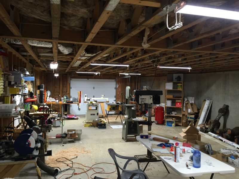

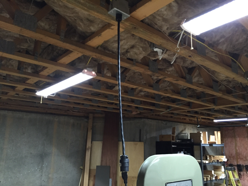

Okay,excuse the messy shop, but here are a few pics. It's hard to capture how much light these LED fixtures put out. A plus too is no heat or attraction of giant June bugs we have here in CA.
View of shop area in tandem garage:
Fixture directly over lathe:

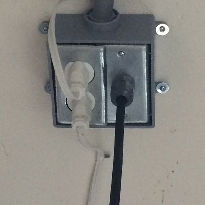

Here is one of the two drops:
And here is how the drop is wired into a two gang box. My prior builder installed fluorescent lights were hard wired into pan boxes in the drywall ceiling. For this upgrade, I surface mounted a two gang box over the in ceiling box. One side has a duplex switched outlet for 2 LED lights, and the other half mounts the strain relief for the cord drop:
Besides pen turning, my other passion is restoring vintage Honda trail bikes (hence the messy shop!). The drops are really coming in handy for powering battery tenders I use to keep these old bikes ready to ride.

Mostly done! The main shop area is mostly done, went with the Sams Club LEDs and they are great, plenty of ceiling outlets to add more lights if they are ever needed but don't think they will be. Even added a 220 outlet while I had an electrician here, leaves an opening for a new addition one day down the road.
Thanks for all of the advice! Really happy with how it's turning out. Now just need to get the other to dos done so I can find some shop time.
