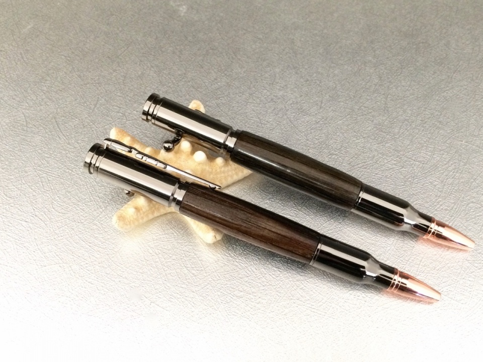

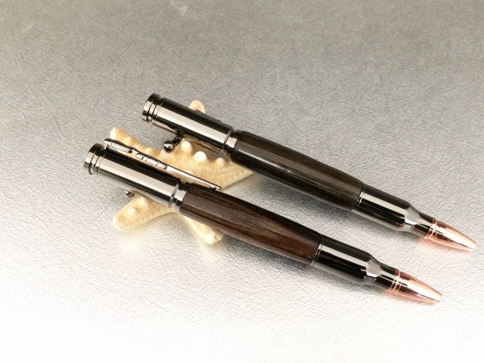

A customer who is a first responder on the Great Salt Lake here in Utah brought me a plank recovered from the W.E. Marsh that sank in the Great Salt Lake in the mid-1930's and ordered two bolt action pens.
The W.E. Marsh was part of a fleet of boats that the Union Pacific kept on the lake to maintain the Lucin Cutoff, a train trestle that traversed the lake. The boat was built in 1908. A picture of the boat and the Lucin Cutoff trestle is shown above.
Even though the wood was well preserved by the minerals in the lake, I had to stabilize it in cactus juice and kept applying thin CA in the cracks as I was turning it. Finished with Pens Plus.
C & C welcome.

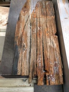

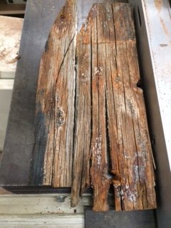

Larry, I'm posting a picture of the plank I received, minus about 2" in width.

Steve, Bill and Richard: thank you all for the compliments! I was nervous about the wood holding together. I don't know if it helped, but I kept the wood under vacuum (in cactus juice) for 24 hours, then after the vacuum was released, it sat in the cactus juice for 48 hours.

Nice looking pens!
You did a great job of turning that wood into pens.
Now you really should make photo castings of that boat & trestle to go with the wood pens. That would make an awesome pen set.
John, great pens, great work and a great story. Thank you so much for sharing this with us. It is so much more special when the back story and history are revealed.
