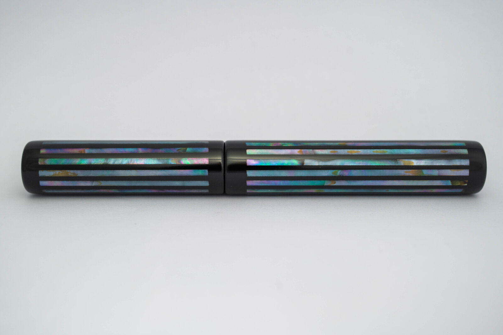

Hi Everyone,
Long since my last post.
Just finished this pen with raden stripes. Several translucent layers of high-quality urushi are added on the top to create gloss and protection. Some amber spots, they will clear out in time.
Turned with Nikko ebonite, for Jowo 6 nibs.
Regards,
Teo

Very well done A+++ May I ask how are you doing your grooves for the stripes in the black pieces? It looks like the black is one solid piece as opposed to caps on both ends. To get squared off edges is not easy. I have had a similar version of that blank in my mind for a few years. Your fit of the stripes is very clean. The cap and body match up dead on. Not an easy thing to do either. Thanks for showing.

There are no grooves.
The stripes of abalone are very thin, 0.2 mm. They are glued on the prepared surface made from several layers of urushi, base layers, middle layers and coloured layers. The "glue" it's also urushi.
After curing, several layers of black urushi are painted on till everything is on the same level and sanded very carefully. The stripes alignement is done by eye, imperfection it's part of creation. In the end I applied several layers of high quality urushi to give the gloss, deep effect and protection. I polished everything with a special powder using only my fingers. All this work process took me 5 months.

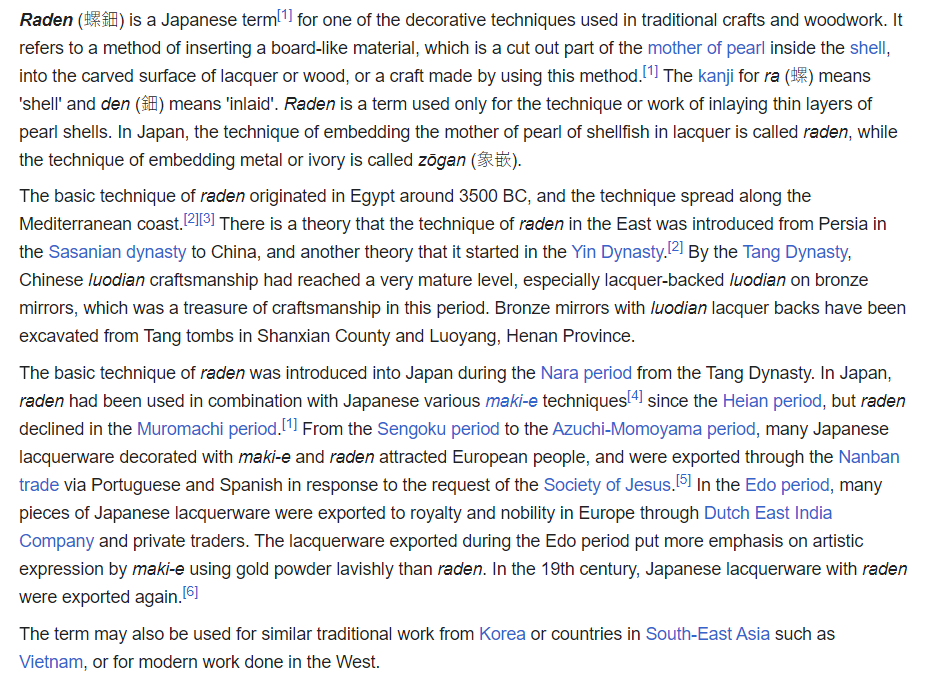

I am probably not the only one that wondered about the term "Raden" so here is a snip from wikipedia. The history is interesting, but what I wanted to know was ultimately as simple as ra (shell) and den (inlaid).
They don't mention the skill and patience required, which I'm sure are indispensable! Teo, how long did it take you to master the urushi technique? I'm always amazed by your finishes.
