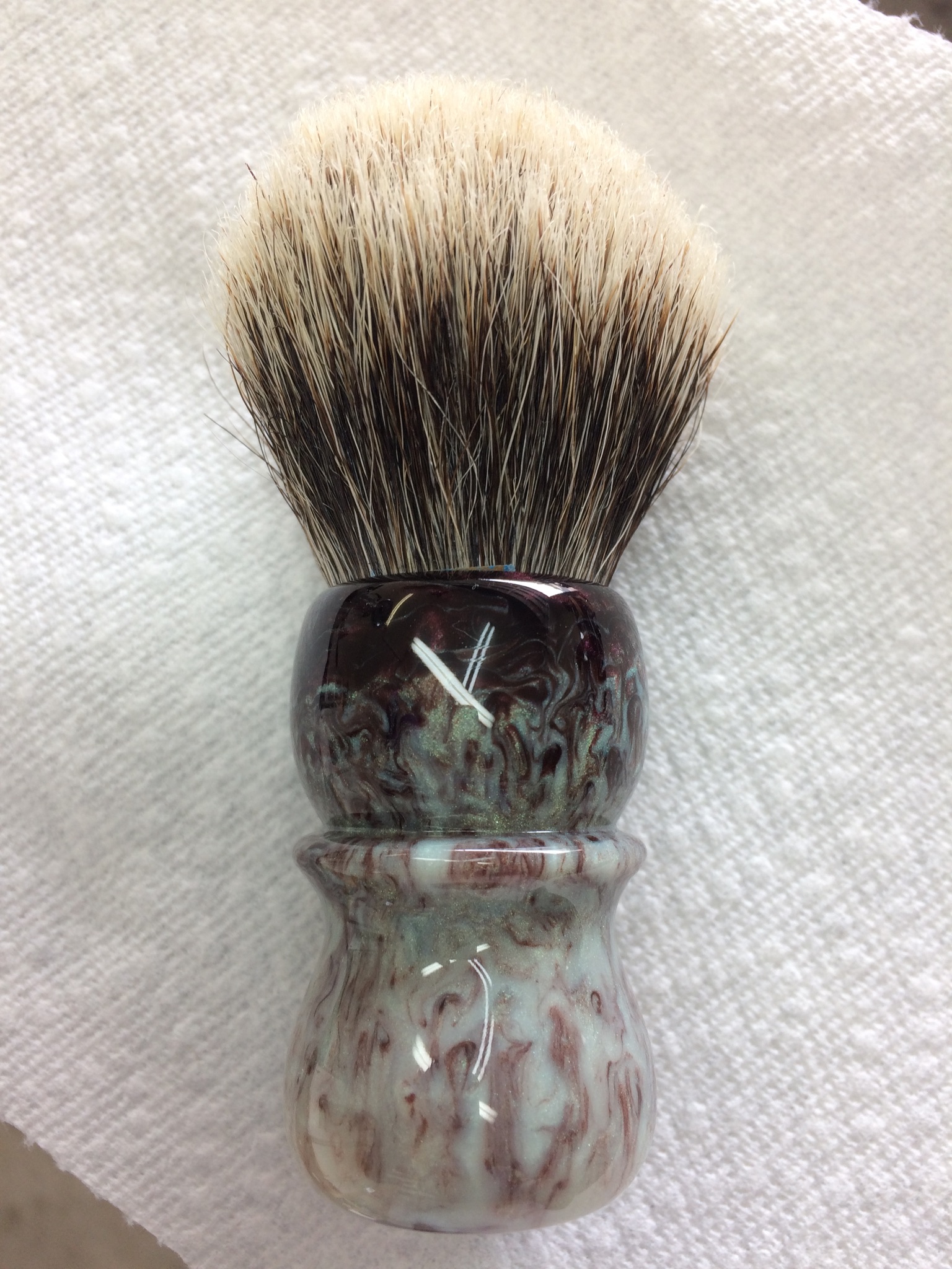

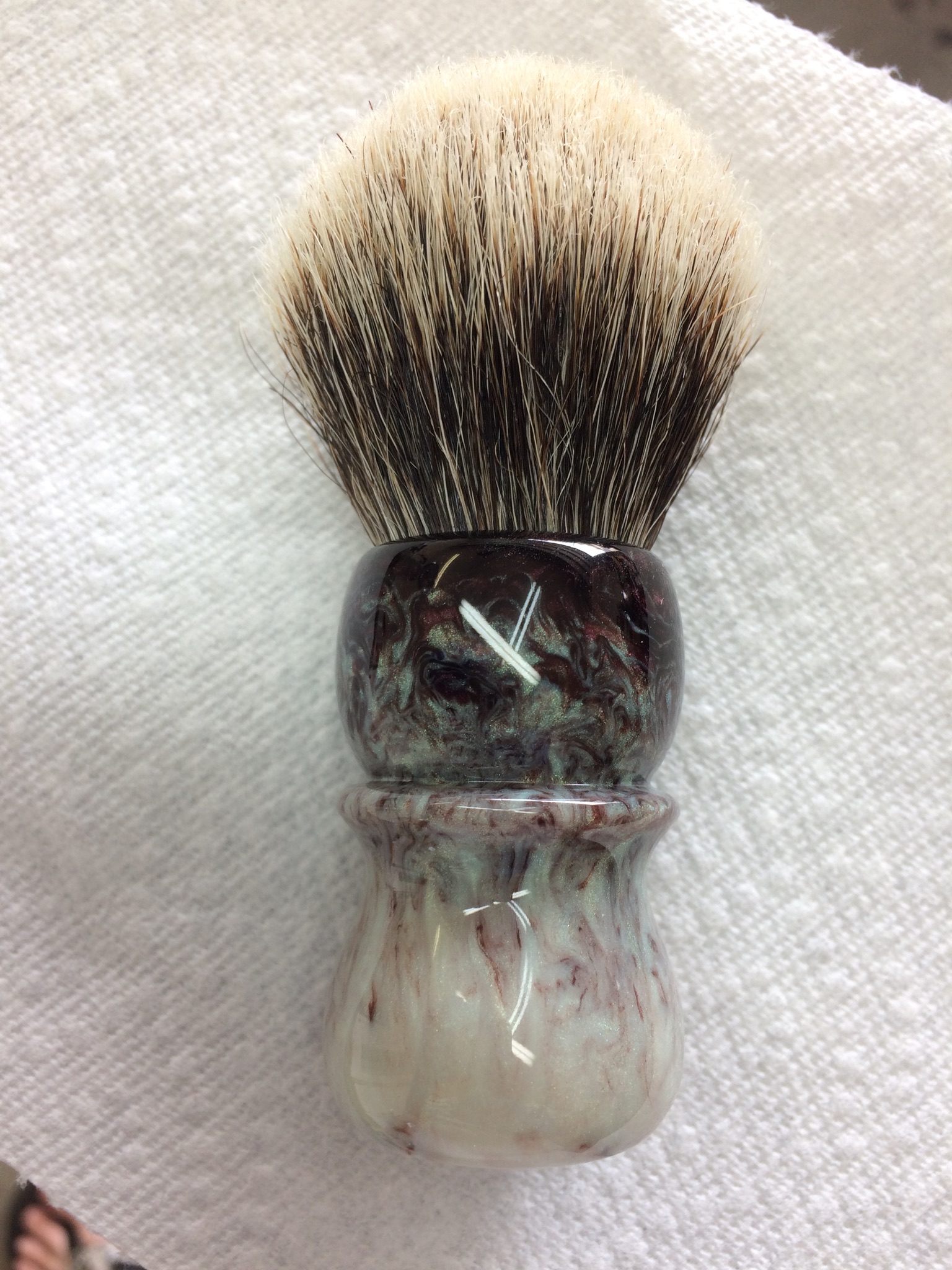

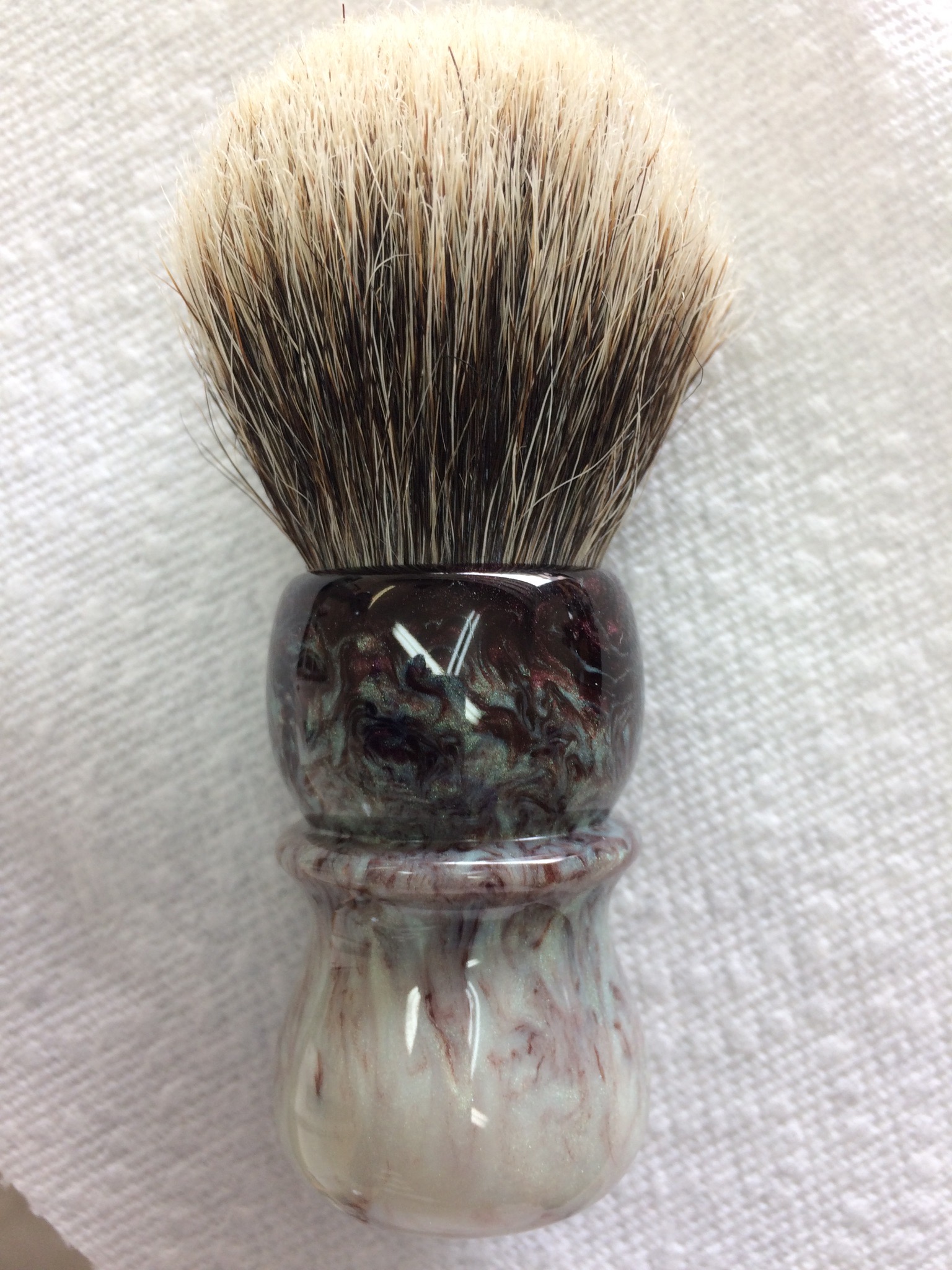

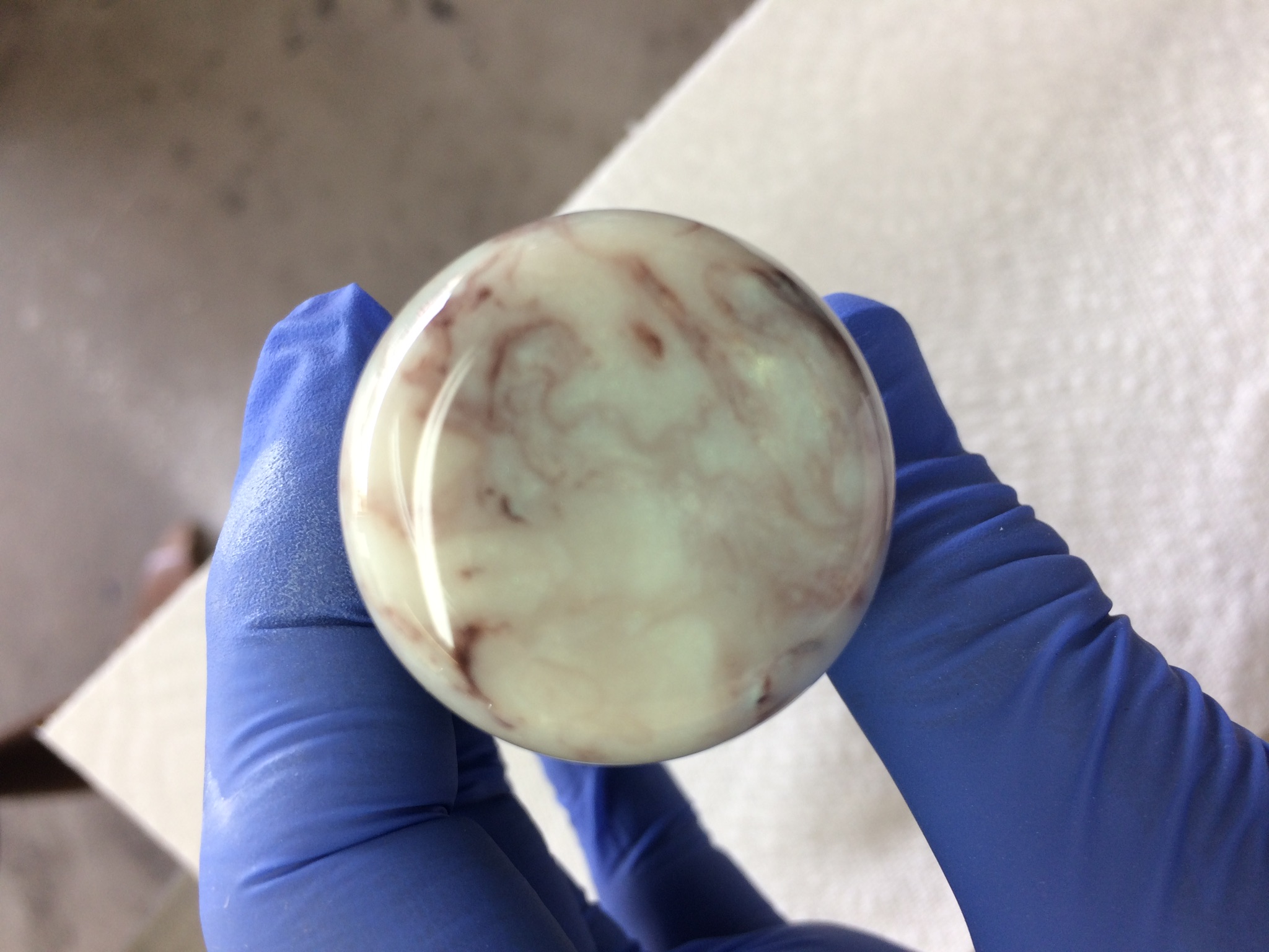

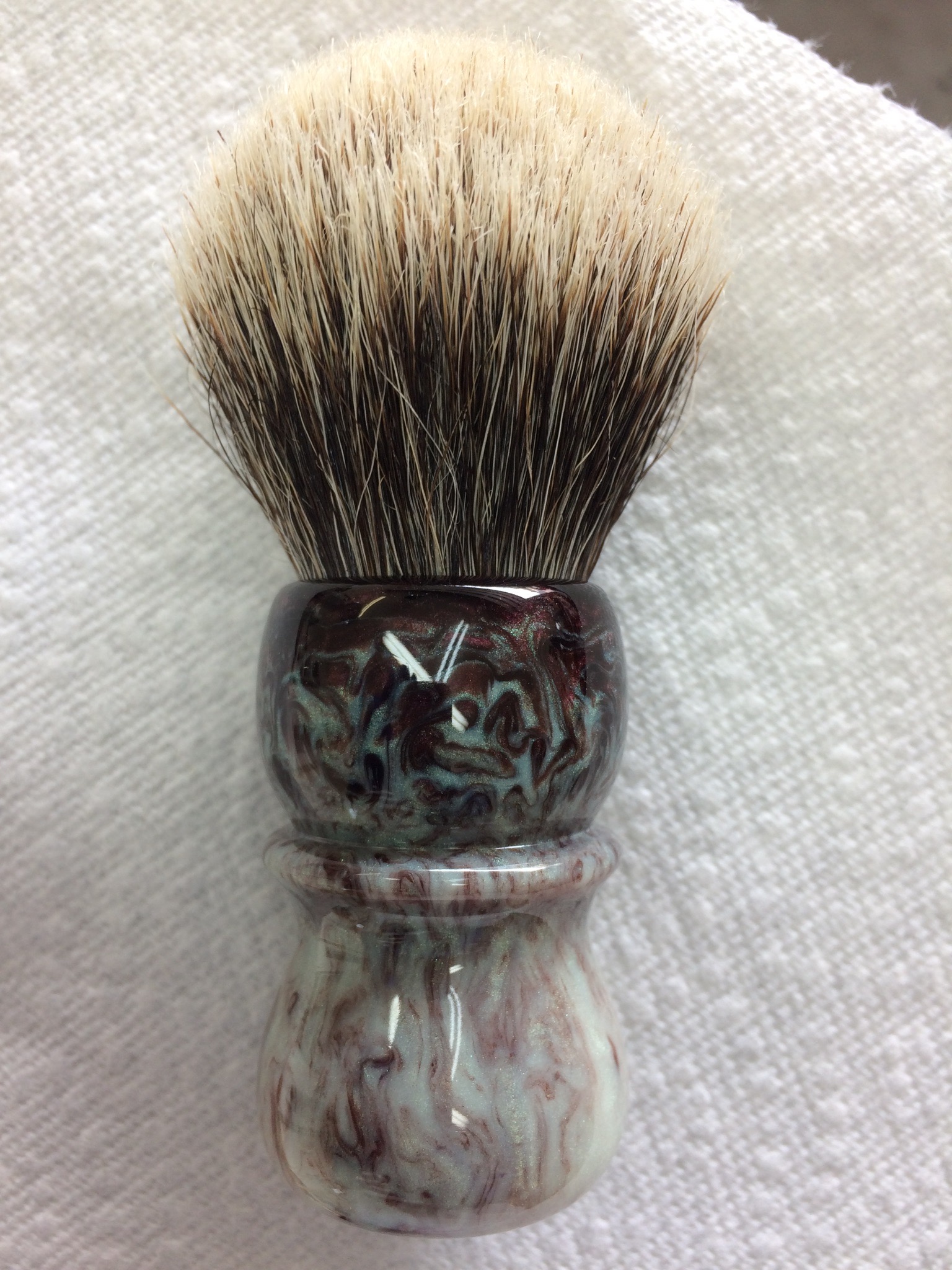

My shop has been about 100 degrees for several weeks now so I haven't been making much. A monsoon blew in yesterday evening and cooled things off (relatively speaking) so I got to work today. I cast this blank yesterday before it hit and had no idea it would cool off enough to make it. I figured I'd sit on it until Sept or Oct when it cools down but this was a gift. I also rough turned two red cedar bowls and threw them into paper bags with the shavings to let them dry (my shop smells heavenly). It's been a productive day for the middle of summer in the Phoenix area.
Handle was made with Silmar 41 and I only used two colors, but mica has a way of blending and giving off more color than what is actually there. Wetsanded 220 through 12K MM, Novus 3 & 2, then buffed on the wheels with blue rouge. I didn't permanently set the knot because I plan on using it in a different handle and will order another for this one.
