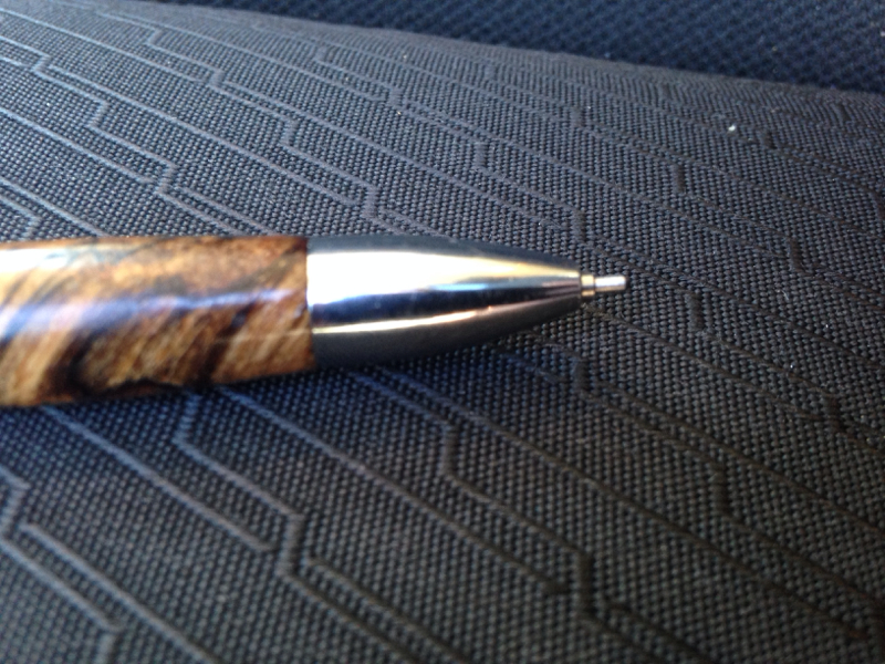

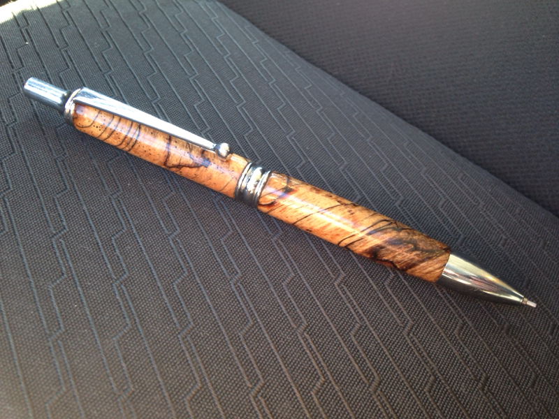

I was able to place the Sharpie liquid pencil refill in my power point click pen kit from PSI and it worked like a champ. This pen has been my daily carry for close to a year and kind of beat up as a result. Hope it helps
***They also make a power point pencil that may help incorporate an eraser***

Looking at the power pencil assembly instructions I don't think it would help because the pencil mechanism has a built in spring and the tip always sticks out. Wonder if the sketch pencil will hold an eraser.
