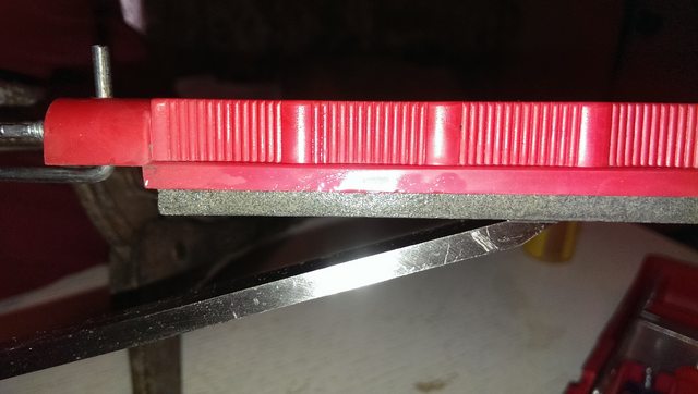

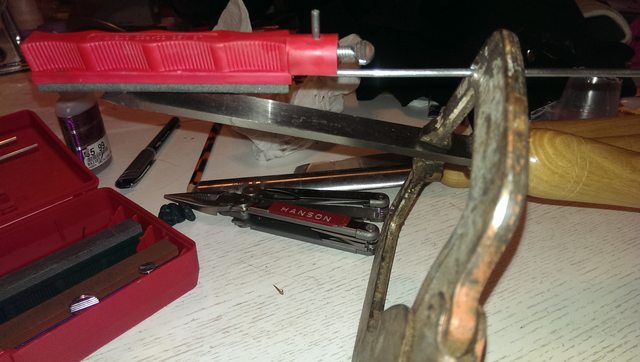

I modded an old pair of deep jaw vice grips to act as a sharpening guide for the Lansky.
Works great and won't slip!
What?:eek: And to think I dropped 700 Benjamin's on a Tormek! I let somebody "should" on me. Shoulda, woulda, coulda. That is slick!:rolleyes:
