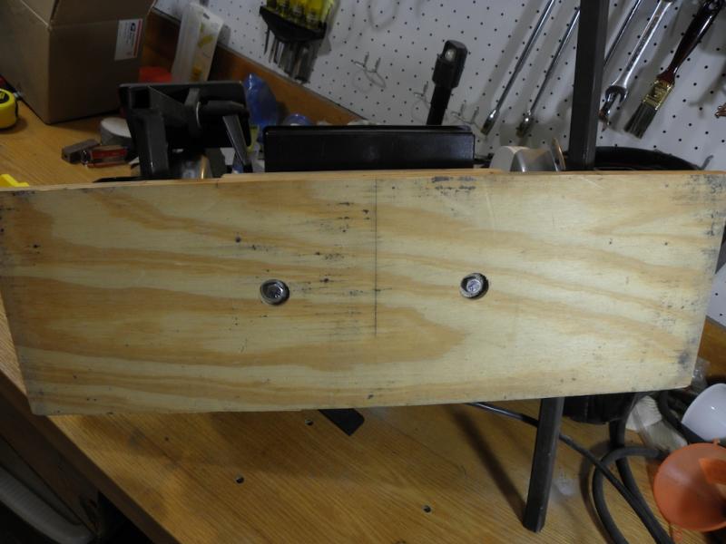

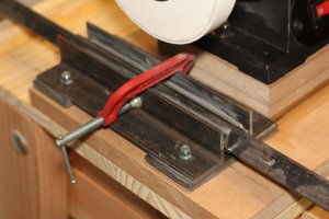

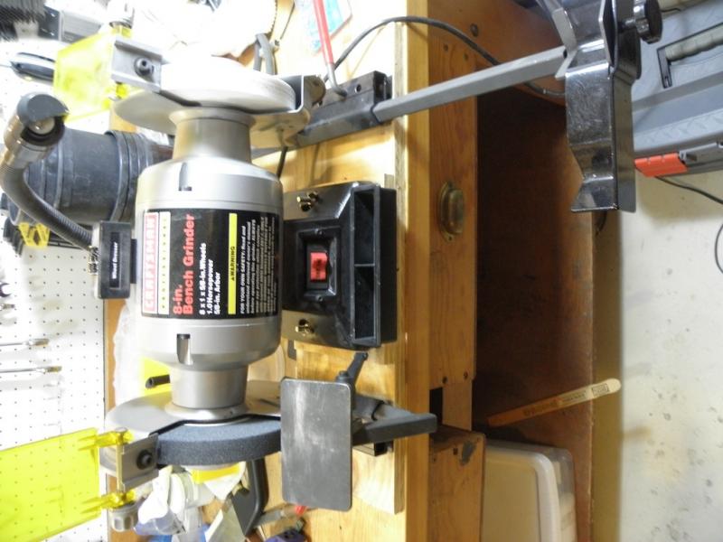

Pretty much the same way you bolt the grinder to a bench, with lag bolts. Only difference is you need to recess the bolts so they don't scrape on the benchtop. Pics worth 1k words:
EDIT: dang it, I can't get that first picture to rotate. Deal with it.
