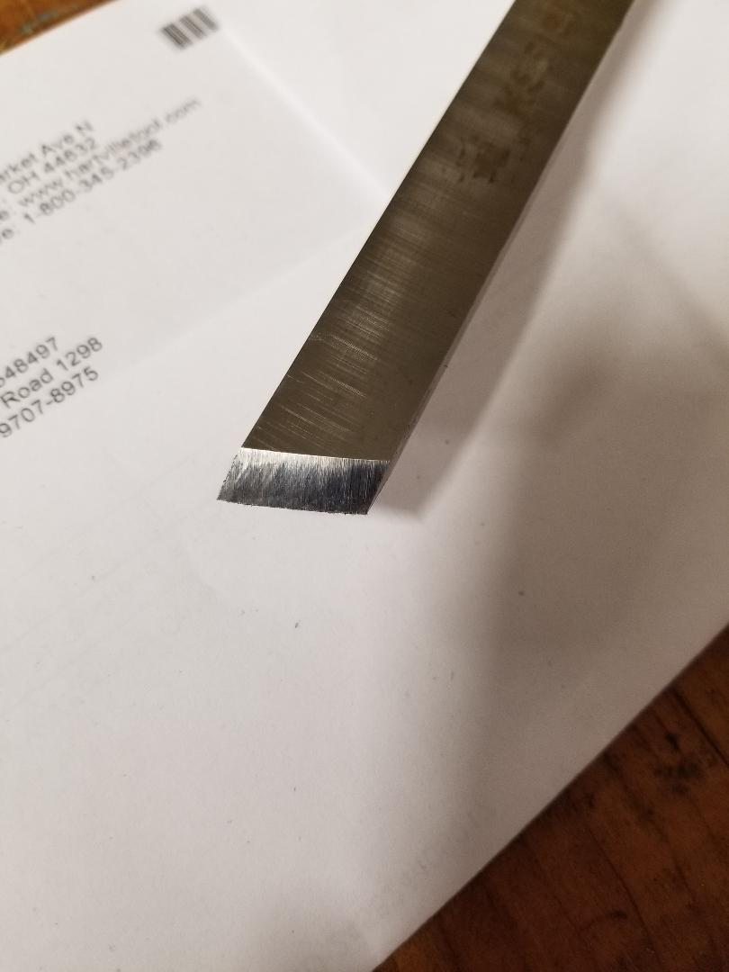

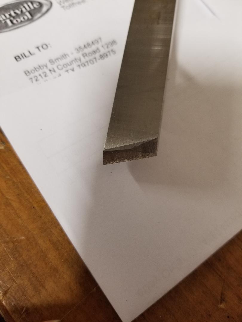

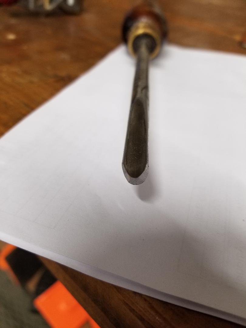

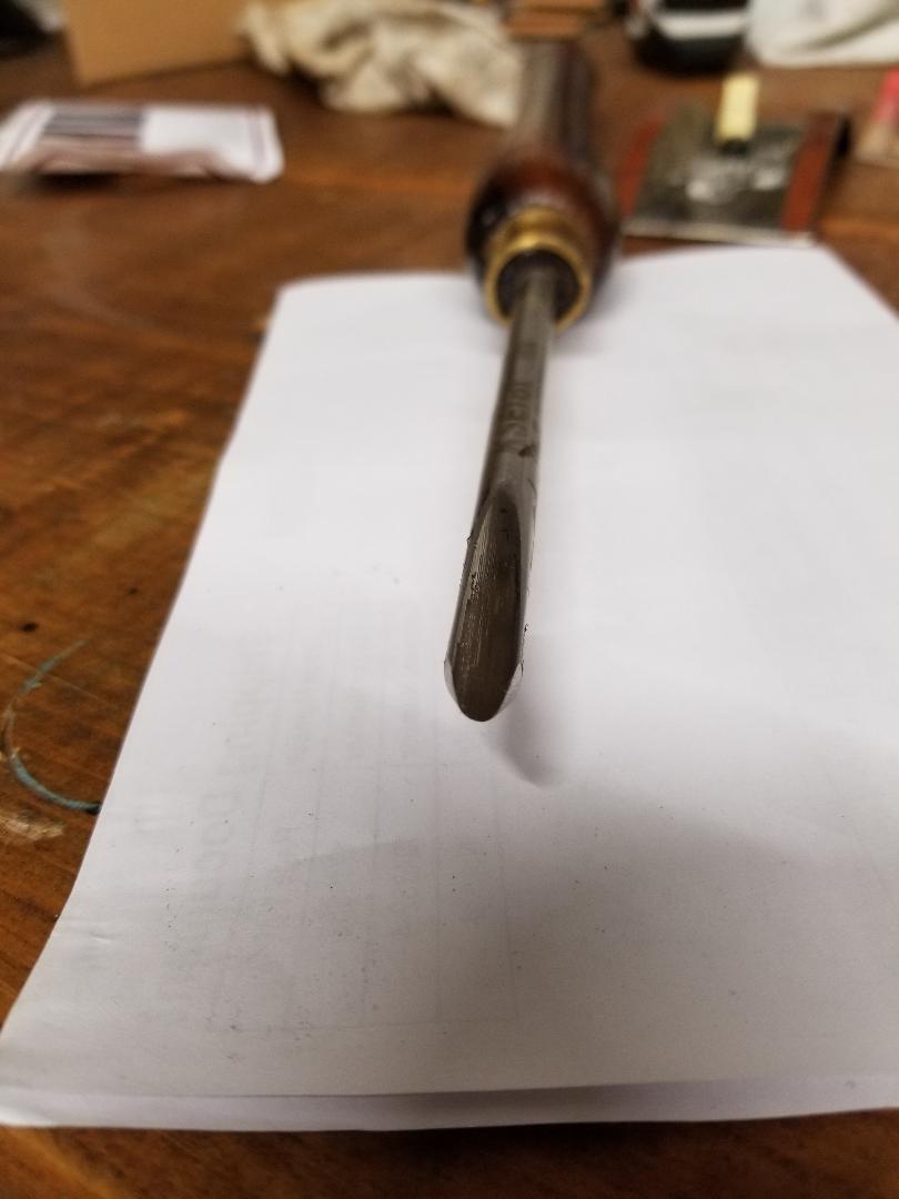

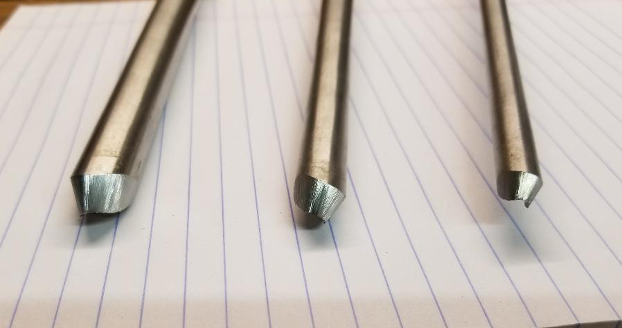

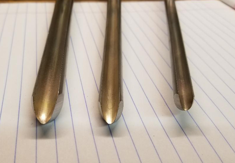

When I started turning, which was not long ago, sharpening tools was my greatest weakness. Without the proper edges, dangerous things can happen. I bought a new variable grinder and the proper grit wheels. I invested at least a couple hundred dollars for that stuff. I still couldn't get the edges like I needed them. This is also important if you plan on turning other things besides pens. It takes a while to properly sharpen cutting tools and I just never got the hang of it. I bought my Sorby, watched their sharpening videos and right out of the box, I was sharpening my tools the way they needed to be. It was well worth the money. Here are a couple before pics of the best I could do and then after pics of putting it on the Sorby.
Wow
There clearly is a difference. Thanks for sharing and the pictures.

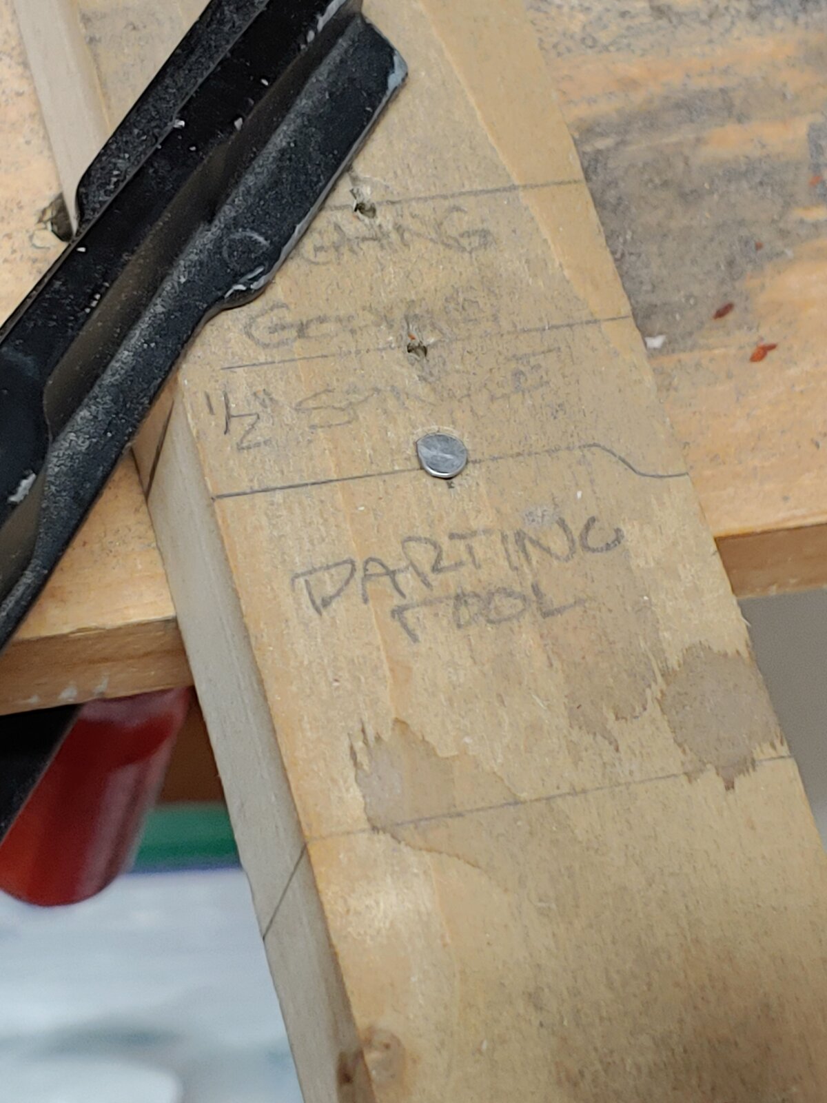

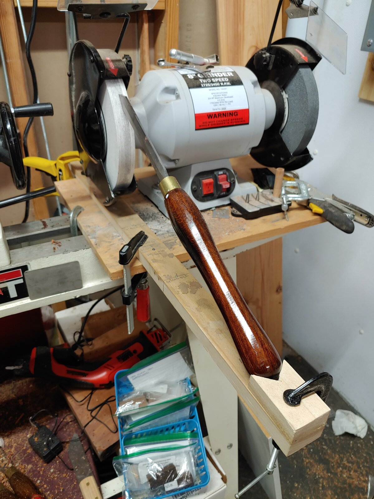

I just improvised with a 1×2 clamped to the board holding my grinder with a notched piece of wood at the end. I drilled various holes for an indexing nail to get repeatable setups for my different tools.
I did buy the Wolverine fingernail jig for bowl gouges, and the Lee Valley adjustable platform I can bolt on when I just need a flat rest.
Finally, I keep a diamond credit card on a magnet on the lathe and touch up any tool the first time I pick it up during a session.
