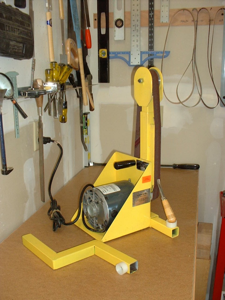

Here's what I use. It's called a Carver Sharp. It runs at 1750 rpms. I use it for all of my sharpening. You can see one of my carving chisels on the belt. The other part not attached is used for my lathe chisels. The principle is pretty simple for chisels. You just move the base in and out until there's no daylight between the tool and the belt. It came with a leather strope belt, too. I don't remember where I bought the belts--maybe Industrial Abrasives? I also bought a little stand from Lee Valley that I use to sharpen my plane blades and also my scrapers.
