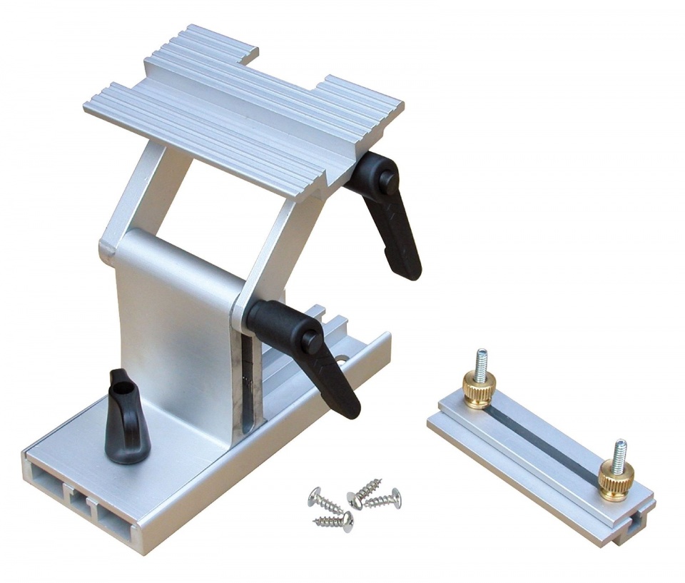

So I have an old 6" grinder. Bought an 80 grit wheel for it to sharpen my tools. It doesn't have the little rests or anything left on it that may have been attached. Lol I bought a jig off ebay, pictured below and it's basically a piece of crap. It doesn't tighten down enough and wants to keep jumping into my grinding wheel when I go to sharpen. I've been trying to sharpen my 1/4" spindle gouge and I just can't get the shape on it. So I'm looking at a couple other jig setups and was wondering if anyone has used them or is using one that would be easy to use for an amateur sharpener? I'm looking at the Wolverine Vari-Grind Jig and the Nova Sharpening center. Thanks for any help!
Bobby
Here's the funky one I bought. Wasted about 40 something $ on this.

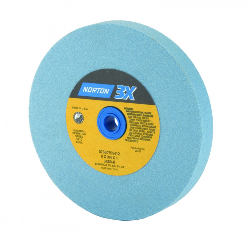

Thanks John and Randy for responding. So my grinder is a 6". Buying another grinder right now may be a problem with Christmas coming on. I did buy a new wheel just for sharpening. It's the 80 grit below. I watched videos before choosing that one. Lol There are soo many methods of doing things, a person can get caught up paying hundreds of dollars following everyone's different procedures. Even the jig setups I'm looking at and the one suggested will set a person back over $100. I guess for now I need to figure out a way to support the one I have better and to make some sort of degree gauge on it. Supposedly the turning tools I bought are HSS M2 and should be able to handle sharpening. But I know I'm destroying my 1/4" spindle gouge because I just can't seem to get the right angle on it. I bought another one from woodturning store, a hurricane m2, and it will be in tomorrow. I'm gonna check the degree with the new one and see if I can fix it. Thanks for the help y'all. Btw Randy, this is oilfield country. No woodturners or chapters out here. Lol I've attached the 80 grit wheel I'm using.

The wheel will work fine. 80 grit is not bad. It is a fine grit. If my eyes read right it is a type "K" wheel which is good for high speed steel tools such as turning tools. There are many people that use a 6" grinders for sharpening tools and do very well. I just gave you ideas of basics because you said you were just getting into this. As I said there is alot more to the story but much can be found in videos on utube. Keeping the wheel dressed and flat is key as well as having a balanced wheel. Making sure there are no cracks in the wheel. Do not grind on the sides of the wheel and so on. Norton is a good brand. There are many homemade jigs used to sharpen all kinds of tools. Do a video search on utube and I am sure you will come up with something. Good luck.

That Norton wheel runs cool and a 6" wheel has a surface speed of 5419FPM @ 3450RPM. The 8" is 7225FPM @3450RPM and 3610FPM @ 1725RPM. So right in the middle. If the OP is using HSS tools a little blueing doesn't matter as HSS was developed to cut metal at near red hot temperatures. What is a problem for HSS is quenching it in cold water to cool it when grinding. It must be allowed to cool slowly because the shock of dipping it causes micro fractures in the metal and it won't hold an edge. Carbon steel like an old Stanley plane blade must be kept cool enough that it doesn't get discoloured ever. Dressing the wheels to keep them clean and sharp will reduce overheating. I use a piece of a diamond masonry saw blade to dress my grinding wheels. The one for the Wolverine is probably the easiest to use, just costs a lot more than a free diamond saw from a road crew.

You started off asking about the grinding jig and referencing the one in your post as unacceptable. I too looked at that one about a year ago and from most reviews that I could find, it was not acceptable.

Yea I took the locking handle off and put a lock washer behind it. It holds better but I feel like I'm gonna bust the thing as I have to tighten it so hard. Thanks for the response hank!

When sharpening there should be almost no pressure being applied on the tool or the platform so I am surprised it is moving. Even a cheap platform shouldn't have any problems.
Are you pressing on the platform?

It would move about a 1/2" as soon as I laid my tool on the rest. I have to tighten it down soo hard I feel like I'm going to break it. But is hasn't broke so now it doesn't move. And yes, I'm trying to get the knack of a smooth and quick grind. I hold the end down with my left hand and the handle with my right. But my right always wants to raise up while I turn. Gotta fix that. Lol
