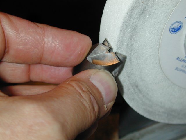

On the trimmer you will notice a curved section and a flat section. The flat section is what trims the blanks
The flat section touches the side of the wheel and the curved section touches the curve of the wheel. You need to touch both the side and the front of the wheel at the same time. When you see sparks flow over the trimmer evenly on both sides, you are doing it right.
The difference between dull and sharp is about .005", so touch the wheel with the trimmer and pull away as soon as you see the sparks flow. If the trimmer gets warm you are grinding too much.
It’s a good idea to practice placing the trimmer to the wheel with the power off until you get the hang of it.

Thanks Ron! I was using the small, flat, diamond file that I got from HF to go across the top surface, flattening it out better. That seemed to work well, but I'll have to give your method a try to see if that works better for me.

You are right, but if you look at the photo closely you will see that I am not touching the top of the cutters. Because of that the height of the cutters will remain the same.

The one thing I have leaned through trying to sharpen my own mill is it did not work after[:(!] I called CSUSA to find out what I did wrong and they said do not put a stone down and run all 4 wings on it at the same time. The wings have a slight taper on them so that the brass is trimed just a hair shorter then the wood. They said if you ran all 4 wings on the stone at the same time it will not cut anymore.
I bought a new mill[V][:)]
Paul is this something you can fix? If you grind just the back side as shown above it should work fine. I just wish I had thought of this before I messed my old one up.

If it works for Ron, fine. Can't argue with success. We have had this debate before. Eagle and I have exchanged comments about this technique and we don't agree. I claim that if you file the flat side, the tapered top is bound to shorten. My sharpening technique is basically no different than sharpening any chisle. Hone the edges. Yes, counting strokes can minimize variation between cutters. I use the Ez-Lap and it does just fine. I also have used a 1" belt grinder. A fraction of a second touch is all that is required, plus a lot of care as too much can be removed with too much time or pressure.

<br />The wings have a slight taper on them so that the brass is trimed just a hair shorter then the wood. They said if you ran all 4 wings on the stone at the same time it will not cut anymore.
As far as I know, all barrel trimmers cut flush and will not cut a tube a hair shorter. If you check around you will find that there are 11 different sized pilot shafts and two different sized trimmer heads. If what you say is true, there would be a need to match each pilot shaft and trimmer head to each different sized tube.
As to the secondary bevel, that sounds like it might be true.

<br /> I claim that if you file the flat side, the tapered top is bound to shorten.
Yes it will shorten after time and when it does (after 10 or more sharpenings) you buy a new trimmer head. Nothing lasts forever.
Look at it this way, the life of a trimmer head (just a guess) is 2000 blanks (1000 pens). How much will you send on sandpaper for those 2000 pens? I bet you will have spent allot more than the cost of a new trimmer head. Compared to sandpaper, trimmer heads are cheap.
Ron,
There would not be a need to match pilot shafts to the trimmer heads, because the pilot shafts are the in the center. The brass tube is next. Then the wood. No matter what size pilot shaft you put in it will alays cut in that same order because the uphill of the angle on the wing is closest to the center. This will always cut the brass tube a hair shorter than the wood. If you still do not think this sounds right a quick call to CSUSA will confirm this. They also said if you are going to sharpen the tips of the mill only do them 1 wing at a time. This way you can not loose the taper on it.
Also as stated in my post your picture of the way you are grinding yours will work. I am even going to try it my self. CSUSA recommended only sharpening the flat side of the wings. I believe this is the way Old Griz does his.

<br />...I claim that if you file the flat side, the tapered top is bound to shorten...
100% correct, Frank!! If you use a light touch and a fine diamond fine, it won't change much; but it will change. Anyone who doubts this can make themselves an exagerated drawing of the cutting edge and then draw a simulated sharpening and it will be obvious that some shortening will occur.

<br /> The wings have a slight taper on them so that the brass is trimed just a hair shorter then the wood. They said if you ran all 4 wings on the stone at the same time it will not cut anymore.
I just looked at my trimmer head and the wings are perfectly flat, no taper at all.
When I trim barrels, the shavings that comes off are nice, very thin ribbons.
I've never noticed on any of my pens that the tube extends out beyond the wood.
I don't know, maybe it's possible my trimmer head is a different brand.
