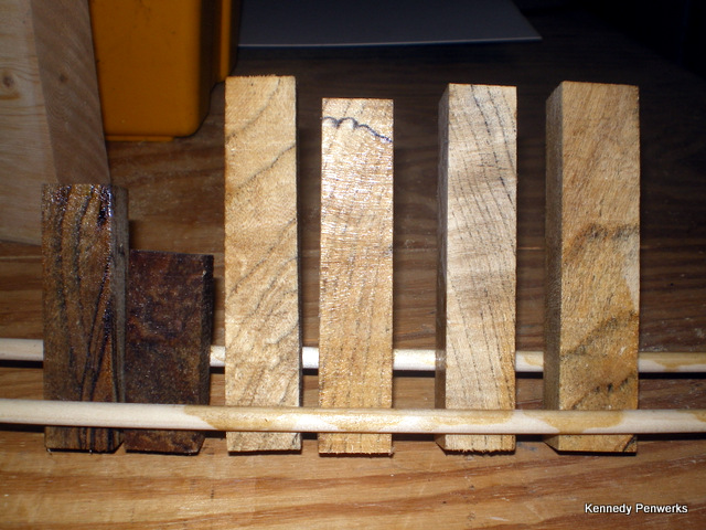

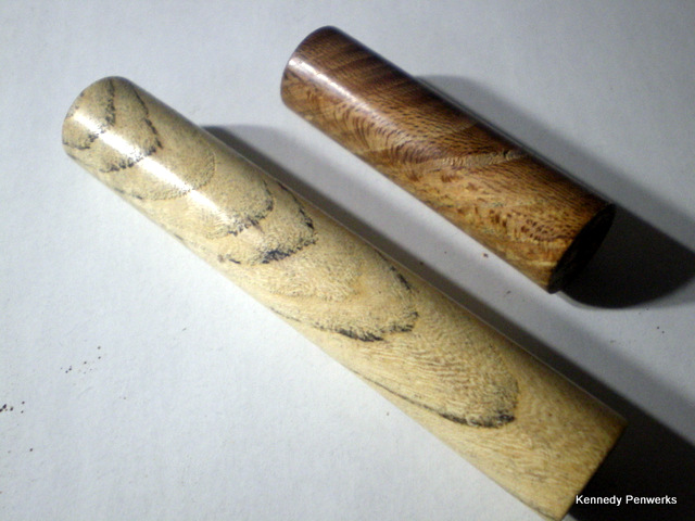

I had about 1/2 a quart of lacquer and I packed a few 3/4" X short blanks standing on end into the can and sealed the lid. Every morning before I left for work I'd flip the can over and every night when I got home I'd flip it again. I did this for a week (7 days). I removed the blanks and put them on a drying rack outside for a couple of days, then let them dry for a few more days inside the shop. Tonight I spun a couple to see what would happen. The end result was better than expected.
Instead of dust I got fine little shavings. I also noticed that the lacquer had fully penetrated the blanks so they are hard all the way through. Anyway, I thought this was interesting enough to share, so here's a couple of before and after pics...
After their week long bath...
Turned round, sanded to 400, and buffed a little to shine up that what powdery lacquer residue...

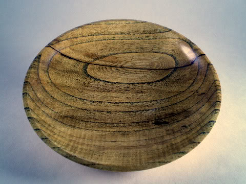

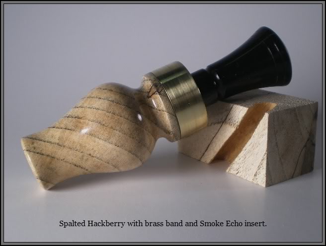

Here is a bowl I managed to get out of the same stuff a while back, but getting to the end was a tough road. The duck call was a little easier.
