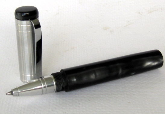

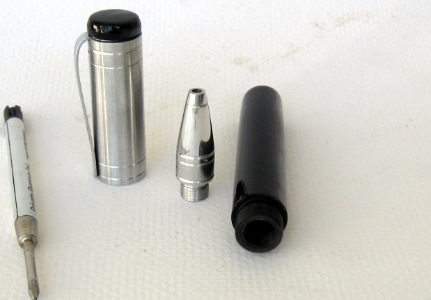

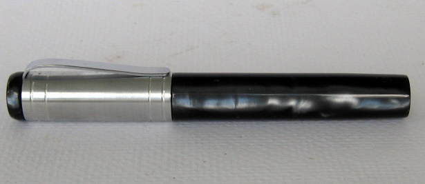

No! These are NOT black & white photos. :biggrin: Made this one this week. Using the triple start tap & die for the cap. And, my new 8x.75 tap & die for the nib. As was suggested to me, the finer threads made quite a difference in function and, appearance. I did get the nubs on the ends sanded off but, the finial is not quite flush with the cap. I'll look at that closer on the next one. Thanks for looking and, comments welcome.

CHuck you have become a pen making monster ;-] The grooves are a nice design touch on the parts.

Great looking pen, the black and aluminum are perfect together, and like Mike said, the grooves make all the difference!

Very nice job Chuck! You beat me to the aluminum cap/acrylic barrel combo. I like it! Excellent job notching for the clip too. I really had to go looking for it.

You mentioned having to turn both wheels at the same time...I am not sure if you were serious, so forgive me if I am being stupid...has anyone tried a ball-turning attachment on a lathe to make nibs? It can definitely make curves like that. You can make one yourself or buy one...I think Little Machine Shop carries them.

Thanks Frank. You just have to take the leap. I was fortunate to have a skilled turner close by (pretty close) Thank you for the link and, no, it's not against the rules, as far as I know. I'm still saving up for the 4 jaw chuck. When I mentioned turning both wheels, I was going for a straighter cone shape. It's tricky and, as you can see, it's not very straight.
