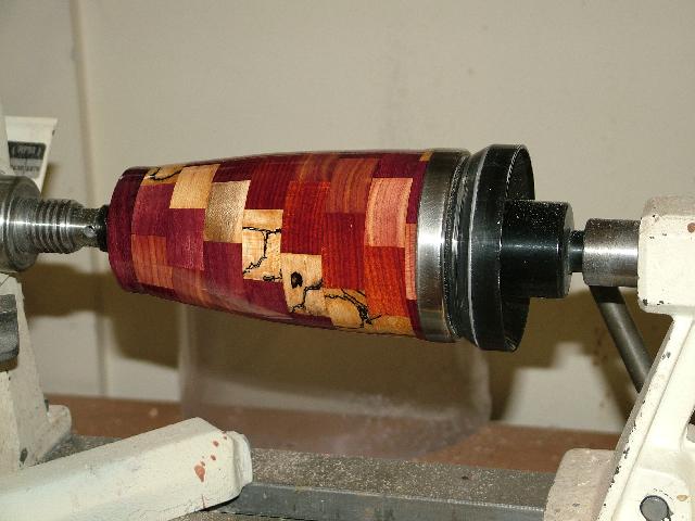

I have this one drying on the lather right now, it came back to have a
different finish put on it. It was made about 6 months ago and there's no
noticeable shifting, and from what I'm told it gets used every day.
VisExp
Oct 1, 2007
2,738
Palm Coast, FL, USA.
I think the grain orientation makes a big difference. Looking at NewLondon's coffee mug you can see that the grain of all the pieces is orientated the same way.
