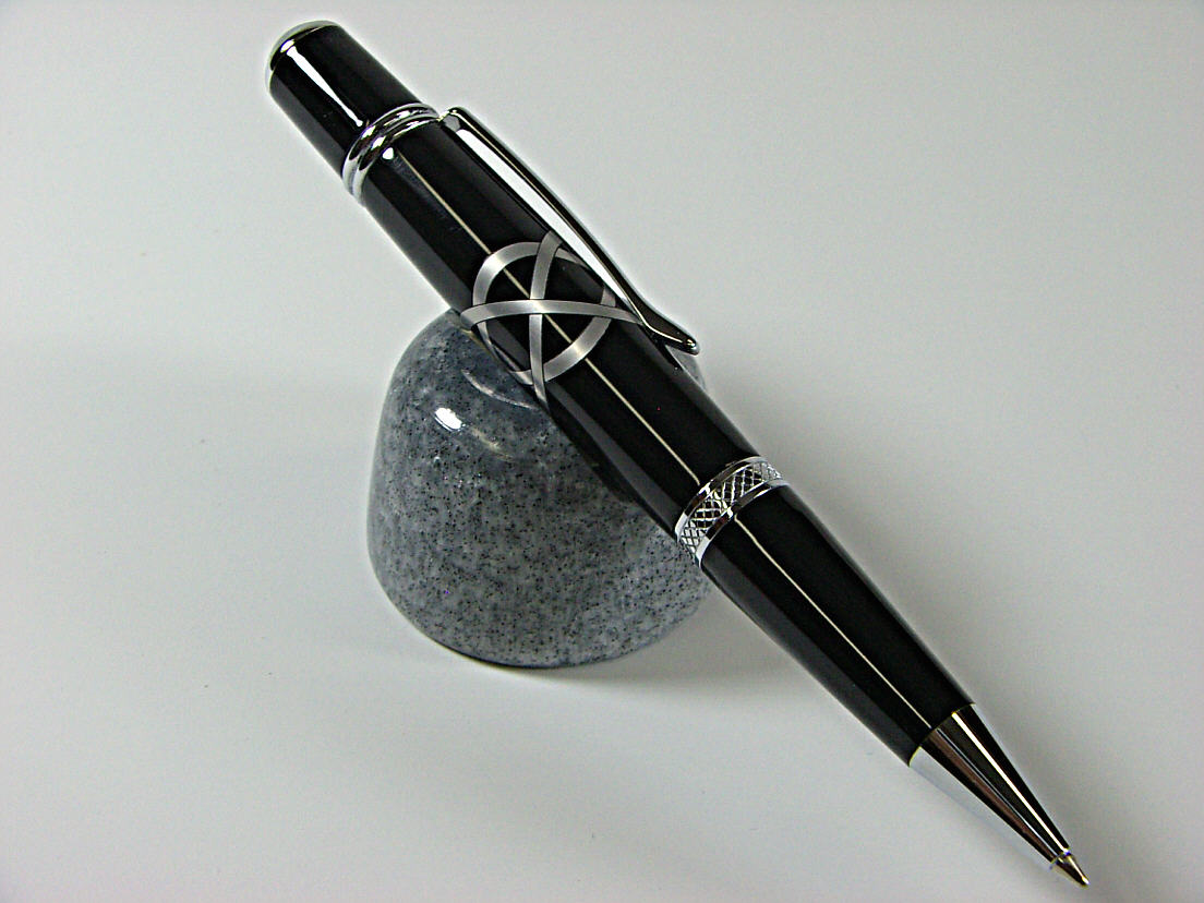

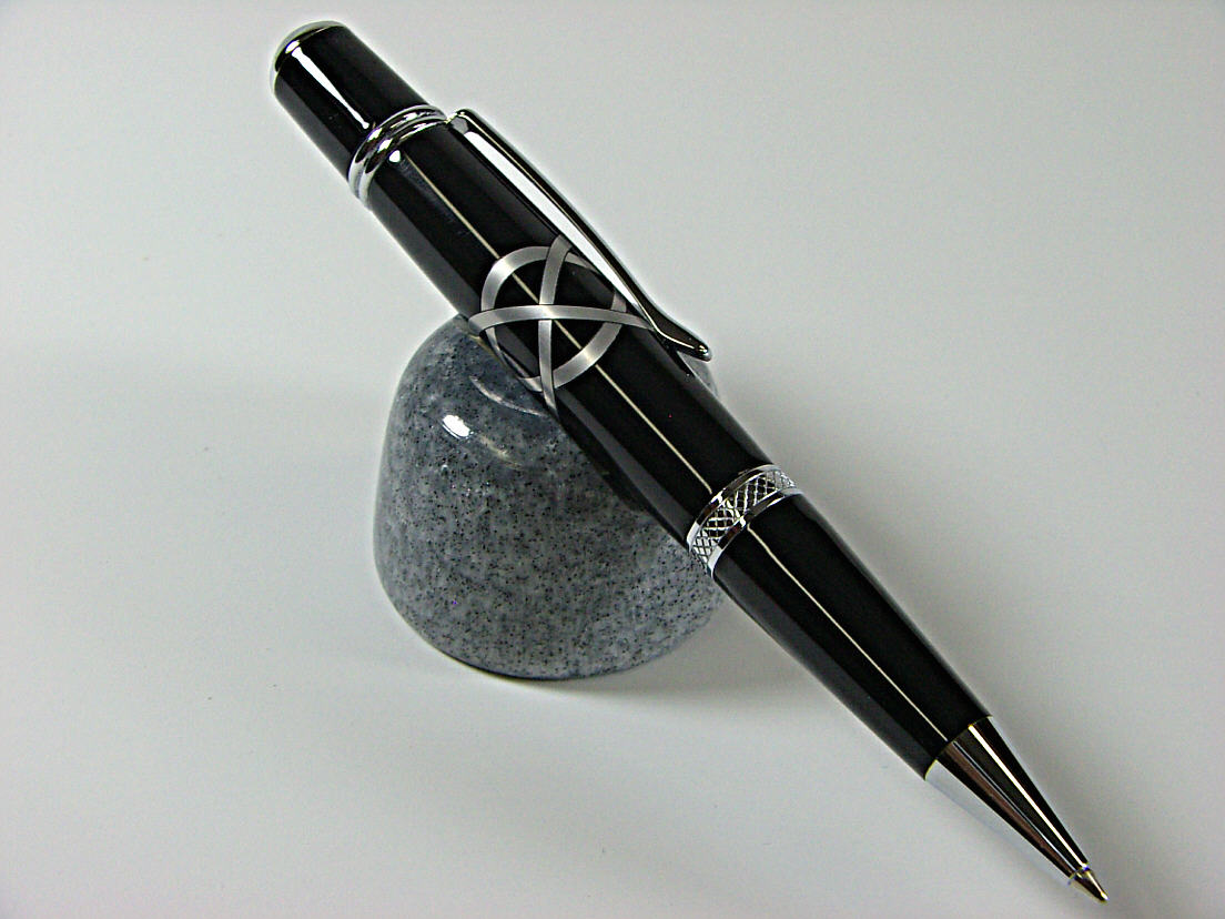

This was the last knot I made. Used that epoxy and it is black acrylic and aluminum the epoxy was tinted with black epoxy additive. Had no problems turning.
Very nice symmetrical and clean knot. What kind (thickness / source ) of aluminum did you use? I've had the best luck so far with flashing.
