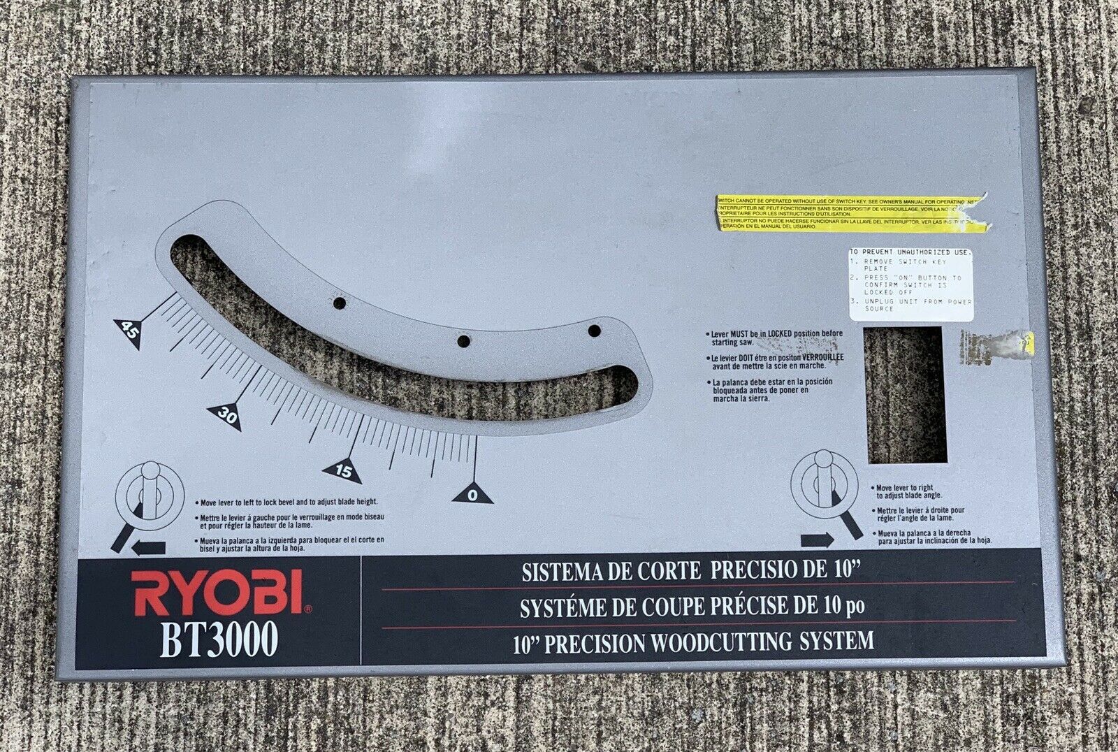

BTW: the picture in the OP is a 3100, not a 3000. The 3100 does have one advantage but had some downgrades also. I personally liked the 3000 better in spite of its tendency to lose its shims.

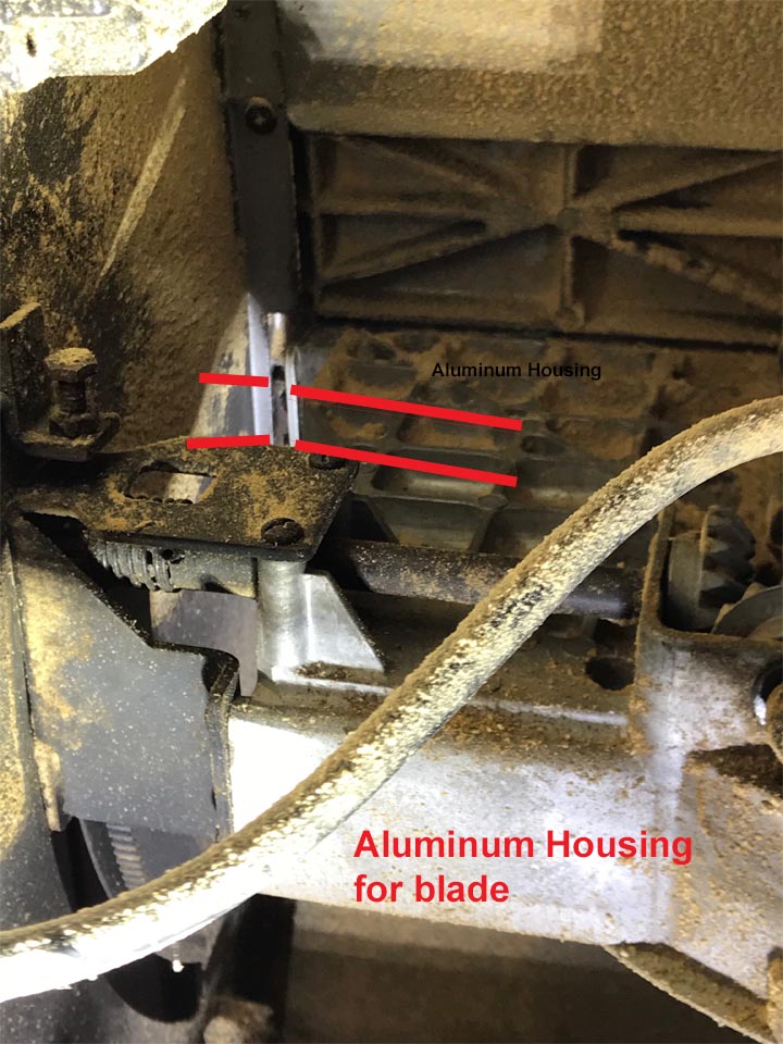

OK, I think I have the adjustment but you Might not need it. Check and see if the blade IS parallel with the side. If so, you are OK to make a sled.
If not, take a look at the picture below. The space between each red line on the right and left shows a little "bump" which are two screws. There is the same on the back side, I think. These are the screws that hold the motor/blade housing to the saw top. The saw should be turned upside down and the side panels taken off - several screws for each panel; then the front and rear panels need to be taken off and that gets a little complicated as the front height/angle wheel has to come off.
Then drill out the screw holes on the aluminum housing by 1/32" front and back. I would not drill it out any more than that, but that should allow enough wiggle.
BT3000.jpgReplace the screws and tighten barely snug. With the blade out the top of the saw check with a parallel leg such as carpenters square. Then tighten. This might be an hour or two endeavor but once done, it should be Good to Go.
It seems like there is one more little item I am overlooking but it has been 10 years since I had mine apart. I made a minor adjustment of some sort and it is working to this day.

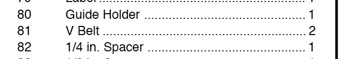

Below is a pict of the parts list: 2 V belts, which are the drive belt. It is not a matter of "I say" - as you put it.

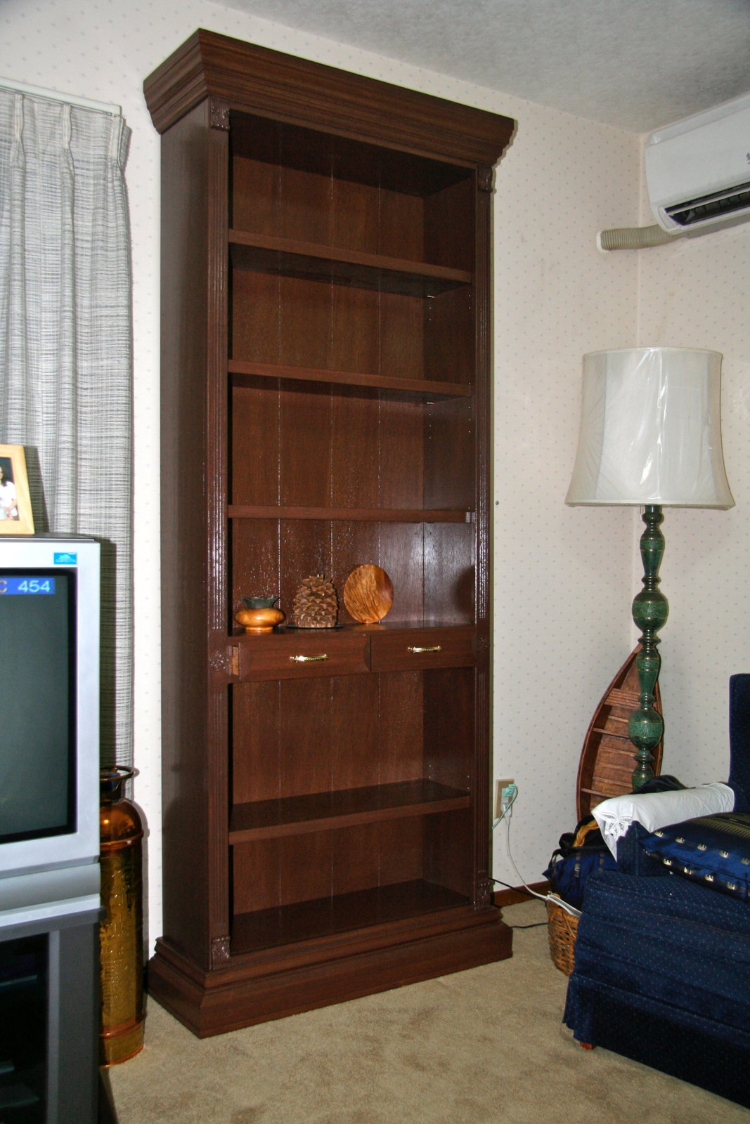

Below is some of my work with the BT as a PRECISION saw and I did NOT havre to calibrate it every time I needed to make a cut or rip.
Oh, here is a from panel pict from Ebay (Notice the bottom line in the black background. Sometimes what we don't know keeps us from enjoying things in this world.):
