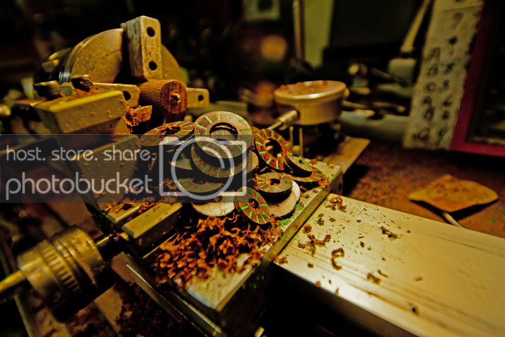

Segmenting
You need to match the materials thickness to the cut width of your saw blade .
The blade on my slitting saw is .037.
The veneers I buy are 037 .
