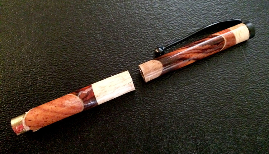

Hi, no rules that I know of, just whatever looks fun. I've only done one (see attached picture) which was a fail--let me explain: Everything went great with the gluing and turning and finishing. The end blew up when I tried to press the pen tip in. Frustrating.
But here's what I learned from this one attempt:
- on this one my cut angles allowed the entire blank stays straight. My only other attempt at segmenting failed because the angles of the pieces weren't right and the blank kind of leaned and I couldn't get a good hole for the tube
- I found that turning the pen was more difficult because the different species of woods behaved differently under the tools. I had to be careful transitioning from one to the next as I ran my cutting tool across.
These are fun, I'm going to do more. Good luck with yours.

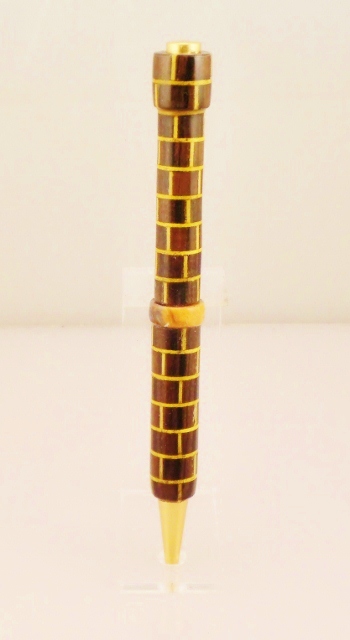

I sometimes start out a design with graft paper and colored pencils. Use the quarter inch squares to map out a design you like and add the colors that look good together. This will give you your size and places to cut for your blank. I sometimes also use one of my PC programs to design, as this gives me a full scale 360 degree view of my finished turned blank, plus I can change the colors or cut lines with the click of the mouse. As John T said, there is a large amount of information on this site and on you tube to give you ideas. Sometimes you can make up a fairly simple blank, and after cutting, rotate the segments slightly to get a bricked or other interesting effect. If you introduce any type of metal into your design make sure you rough up the surface on both sides with sandpaper or the two unlike surfaces may not stick together. The only limit to what you can do is you yourself !1 Here is an example of a rotated brick effect I had done several years ago. Start with something simple using scrap woods and dyes/inks to add color and work you way up. Jim S

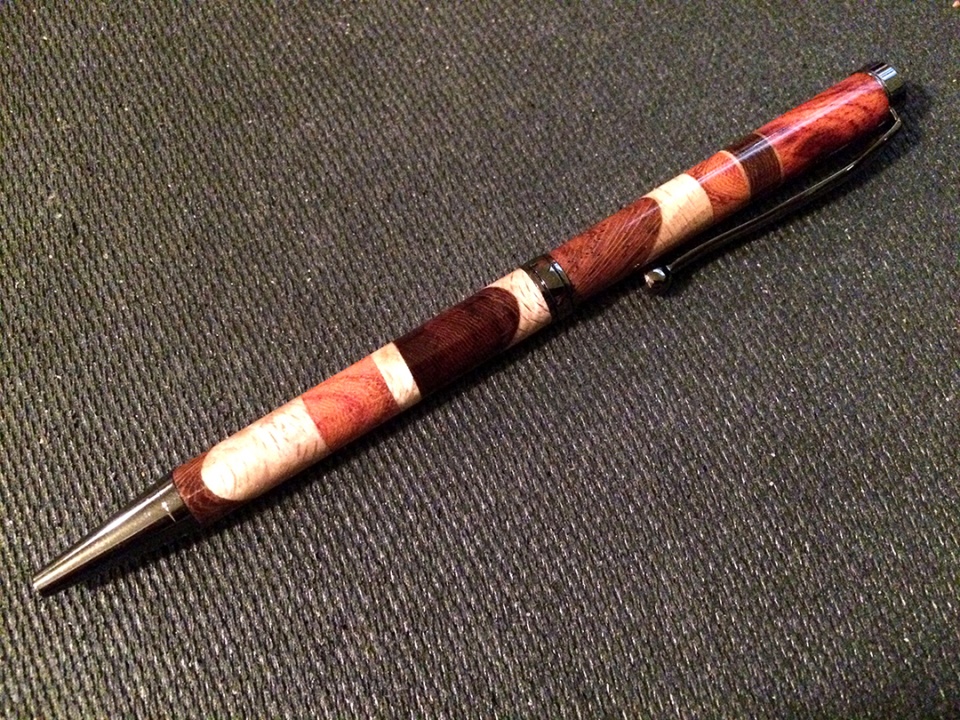

Here's Take 2 on the segmented pen. Burmese blackwood, Burmese redwood, and maple (no, not from Burma, from my back yard in Oregon).
Not sure I'm 100 percent happy with it, I was hoping the maple would be whiter. And maybe it's just too busy overall. I'd be interested in your opinions and maybe people could post some wood combinations that they think would work well together.
Sorry the picture's not great. Just took a quick pic with my iPhone.

My thoughts are that pen is way too busy with too much of a mish mash of cutoffs. Now if that is the look you were going for then it works but what I like to do is have a theme. Keep symmetry throughout the pen both top and bottom if a 2 piece. The eye is trained to look for this. As far as combinations go you get into trouble when mixing heavy grained woods or burls with grained wood. You need woods that compliment each other. Light ---dark But the grain patterns can not fight each other. Use a heavy grained wood with a mute wood such as ebony or holly on the other end of the spectrum. The use of accent pieces such as metals or acrylics or even veneers to divide the woods is a great look. just look at some of the celtic knots shown. Just some of my thoughts. :smile:

By the way maple will never be white. It will always have a tan tint to it and depending on the finish it could even have a yellow tint. If you want pure white Holly is the answer there. Or acrylic. Now you can lighten maple if you bleach it but the tannin in it will not allow pure white.
Good thoughts, thanks. I especially like JT's observation that you need contrast in grain as well as color, I think that's some of what bothers me with this example. I was going to look for some Holly. Madrone is also light-colored wood with a soft grain--and I have plenty of that.

I'm still interested in people's specific opinions about which woods would work well together. After my last try I'm thinking of trying a cocobolo-madrone combo.
