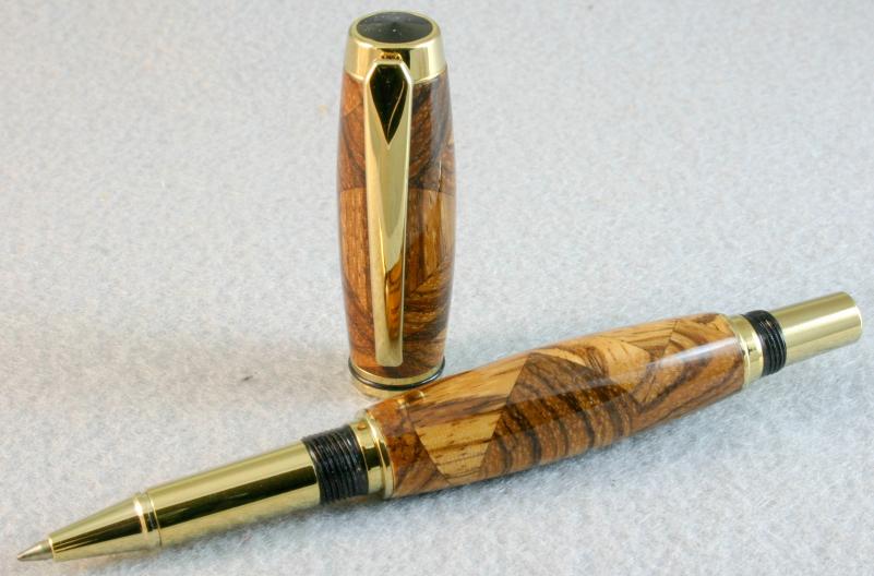

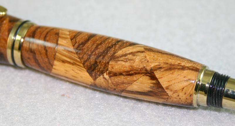

After my last adventure with segmenting I thought I would go with one wood, so I opted for Zebrawood.
It was a real pain to turn but I think it turned out okay.

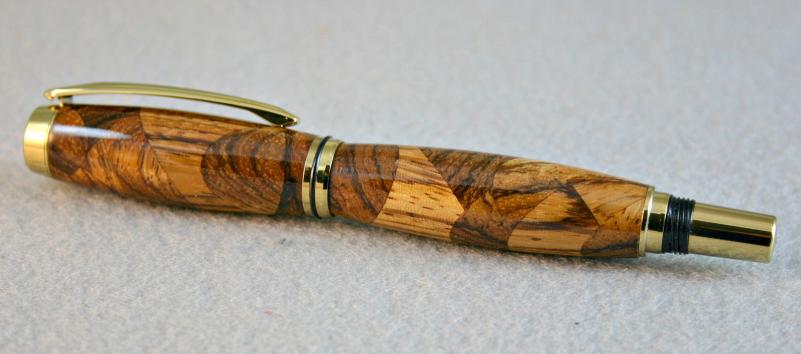

Here's a better view of the lower barrel.
The finish is 10 coats of medium CA.
All comment, suggestions or questions welcome.
Mike
That's cool,I can appreciate the patience it takes to keep cutting and gluing
that many times on such a small pallet I don't think that I could have kept track of the next cut and where it goes, You get my vote!!!
Beautiful work,
Mark
That is one piece (lots of) of great craftsmanship. A beautiful pen.
About how much time from layout to finished pen blanks is involved in that? I am sure it is a bunch.
You did a wonderful job on that.
Ray

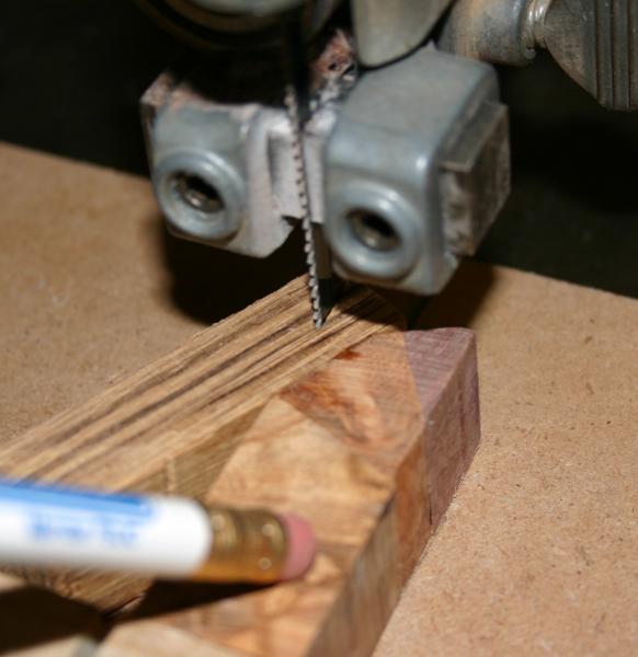

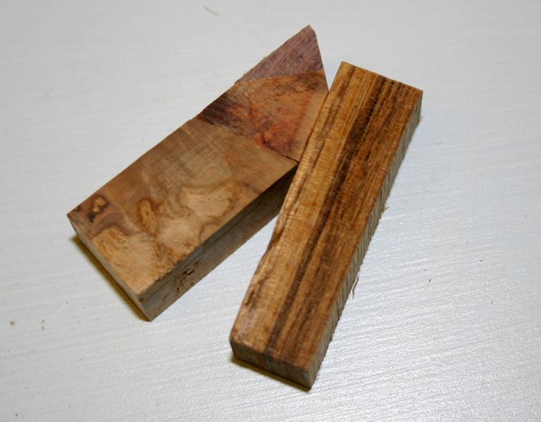

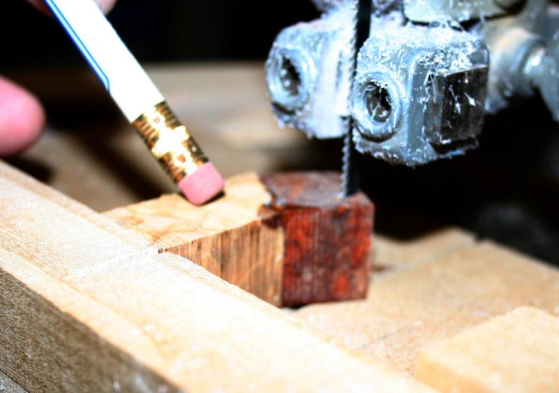

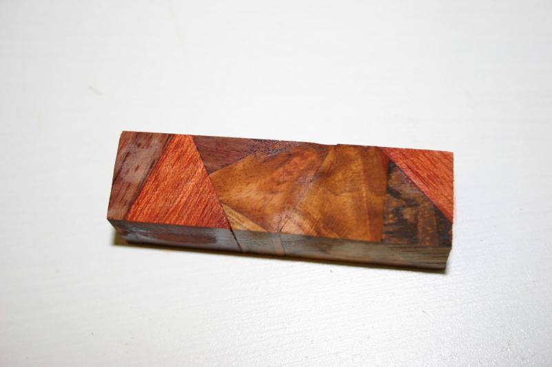

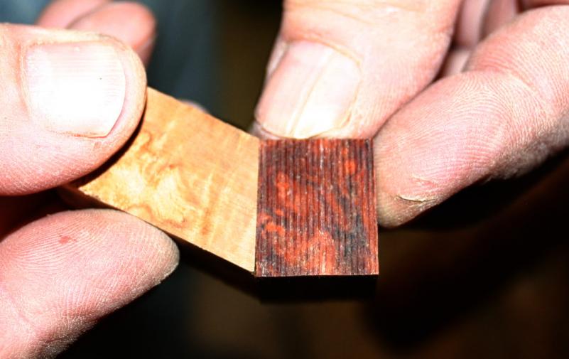

Here are a few pictures to show I how to do it.
Sand a bevel on a piece a couple of inches long.
Glue on a piece with CA glue
Remove waste
Disk sand and attach next piece.
Remove waste again.
Keep rotating the blank and adding pieces until you have enough for your blank.
Hope this helps if anyone has any question I would be glad to help.
Mike
