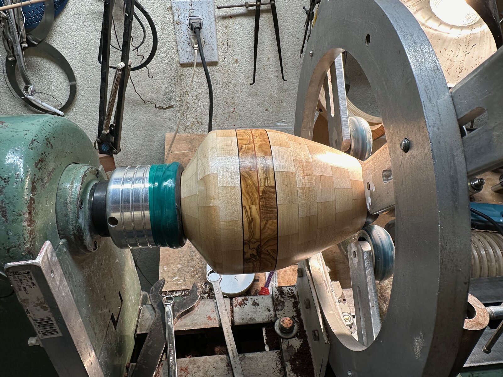

Dieseldoc Member Joined Oct 28, 2017 Messages 1,783 Location Livermore, Ca 94550 Dec 18, 2023 #1 9x6 segmented vessel vase with insert for water, Maple, Burl Walnut and Olive wood with infills. oil red and black Last. made for Christmas.
KenB259 Member Joined Dec 24, 2017 Messages 4,561 Location Michigan Dec 18, 2023 #2 Wonderful job. Charlie, do you hollow the entire vase or just enough for the insert?

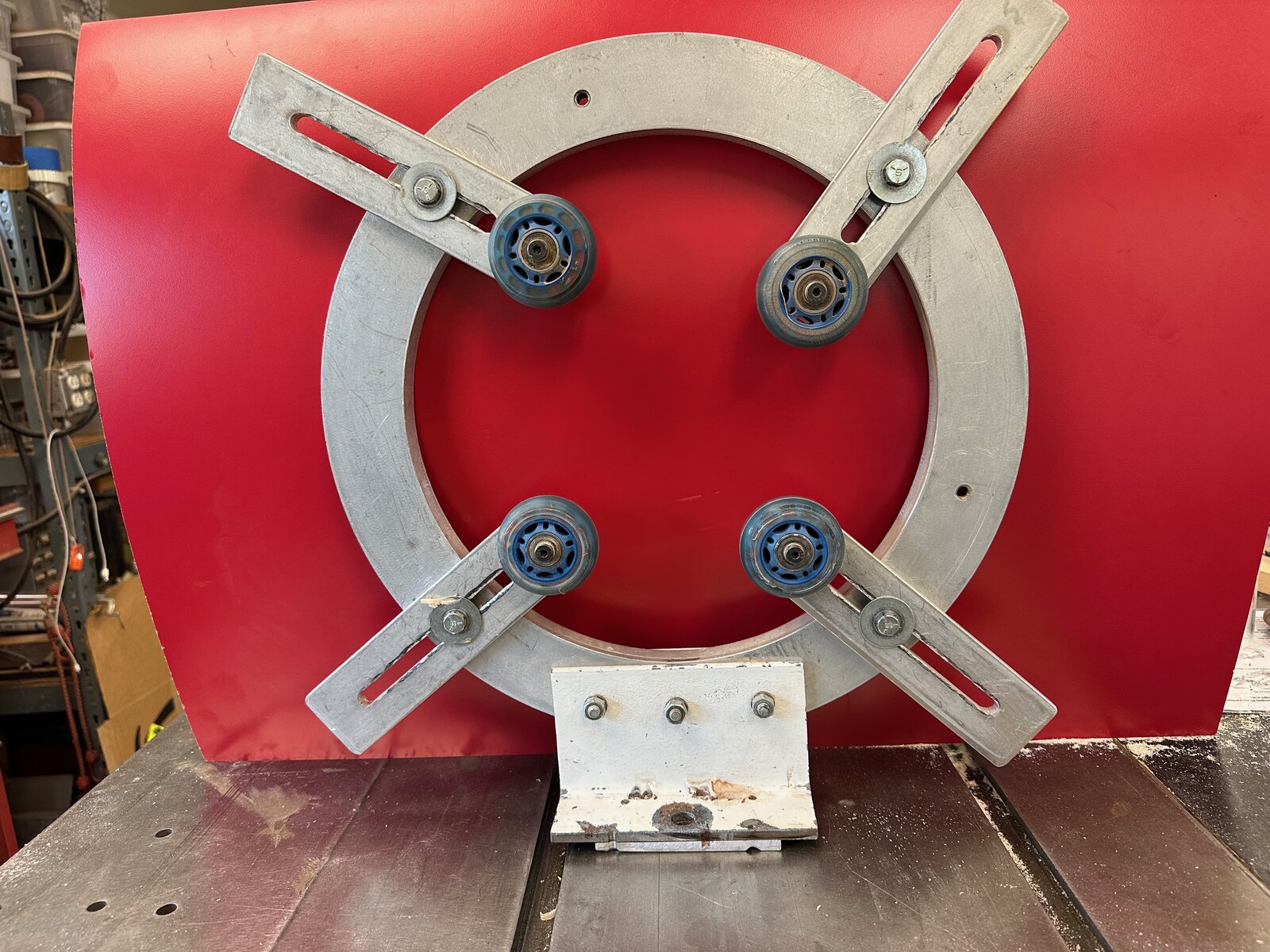

Dieseldoc Member Joined Oct 28, 2017 Messages 1,783 Location Livermore, Ca 94550 Dec 18, 2023 #5 KenB259 said: Wonderful job. Charlie, do you hollow the entire vase or just enough for the insert? Click to expand... Ken: Wall thickness is 3/8 , turn in side as you build,. Use steady rest when doing the last cuts. I use Lyle Jameson boring system with Hunter cutter. Also use vac chuck when doing the finish work.
mark james IAP Collection, Curator Joined Sep 6, 2012 Messages 13,698 Location Strongsville, Ohio Dec 18, 2023 #6 Lovely artistry Charlie. Hope all is well this season.
