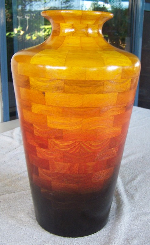

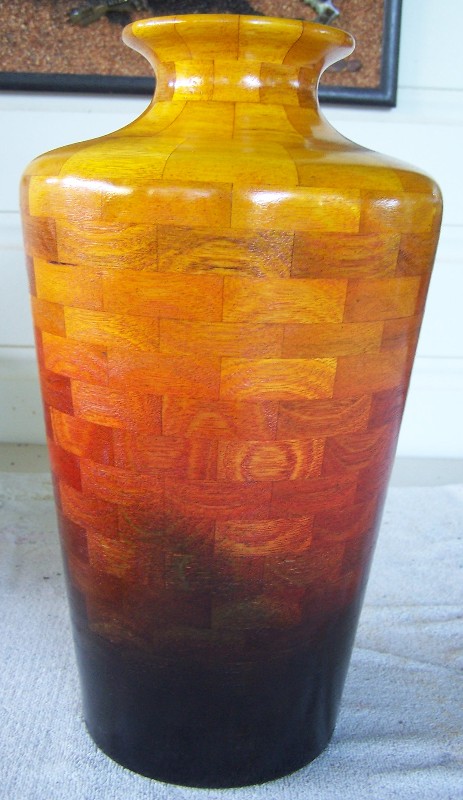

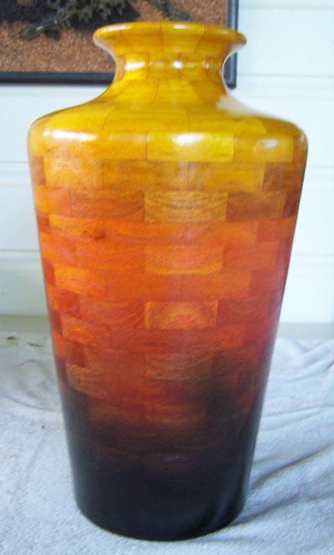

Haven't posted for a little while, so thought I'd better show that I am still here.:biggrin:
This one has 19 X 12 segment rings plus the base, making 229 pieces all up.
Wall thickness is 1/4 - 5/16in.
The water dye is applied with an air-brush as the lathe is turning at it's slowest (178rpm).
The vase measures 13.75in tall and 7.75in at it's widest, it was sanded to 400 grit and after being dyed was sprayed with lacquer.
Thanks for looking and C & C welcome.
Bob:smile:
