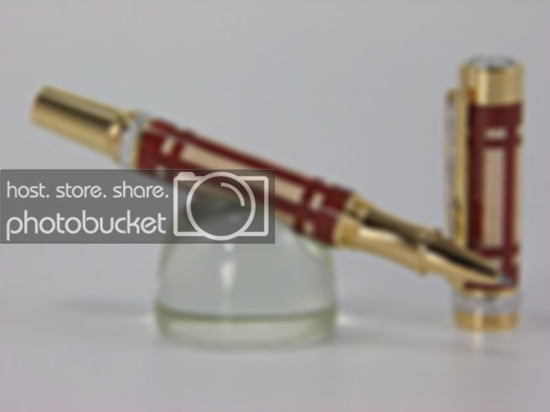

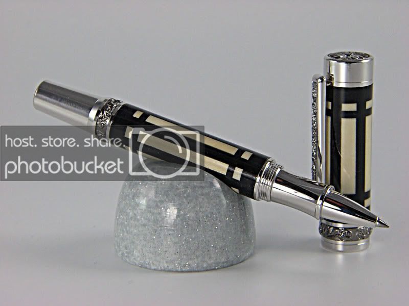

If you are going to put a surface finish on a pen such as CA, poly, or laquer of some sort you do not need to go past 400 grit of sanding. It will do nothing more. You can easily achieve that and more with the use of a well sharpened skew.. That is my recomendation. I do have a little experience in this area as I show you a couple examples of pens I made and not one piece of sandpaper touched them.
The first pen is Gabon ebony and Holy with a CA finish and the second is Bloodwood and maple with a CA finish. All woods would be prone to cross contamination if sanded. Yes I could have sealed with thin CA but to me a waste of time and effort. That is my opinion. Good luck and happy turning.
