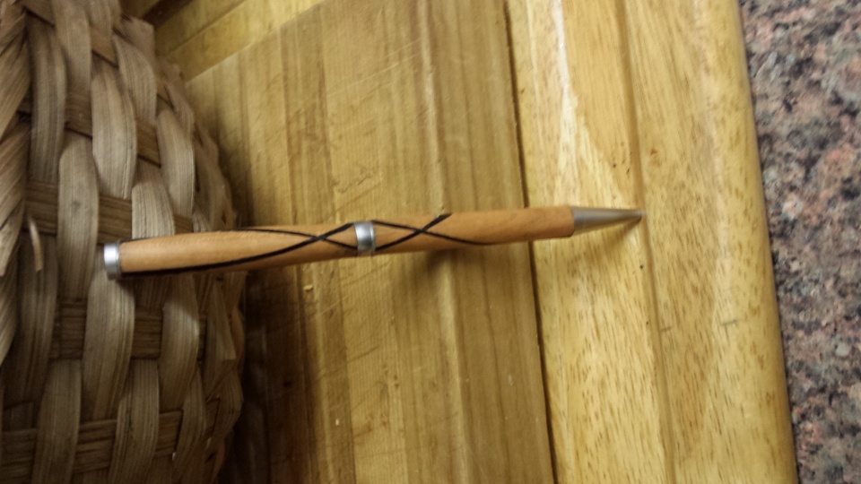

Was experimenting and made a blank from Cherry, Wenge, and Maple. I rushed the finish. Otherwise I was happy with the making of the blank.
Good balance in the segmenting. Subtle in the attraction to me.
Thanks. It was an impromptu affiar:smile: I went into my workshop and just started cutting. Just curious what it would look like. There are some flaws/mistakes which can't be seen from the pic.
1: I did not sand the blank well after cutting the curves. That meant saw marks. Saw marks= gaps. So there are two spots that have gaps that appear on a turned pen as little holes. Not noticable on a table top glue up but noticable on a pen.
2: The Maple slices were put on the blank too far to the ends of the blank. So when it was turned for a slimline you can't see th emaple since it is now gone. The only place you can see it is under the clip.
I am going to perfect it this weekend. Might use venneer to give more subtle curves.
You will be much happier if you can cut the blanks with a scroll saw. No sanding required. Don't make the curves to sharp or the veneer will break during glue up.
I have an Excalibur 21. I was just winging it at the time so I used the band saw (my scroll saw had too much stuff to move off the top :smile:
I am going to use the scroll saw next.
Thanks
Thanks
If it helps I cut my blanks with a #6 skip tooth blade.
