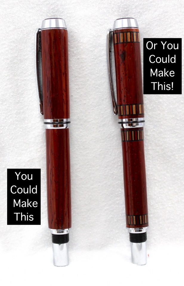

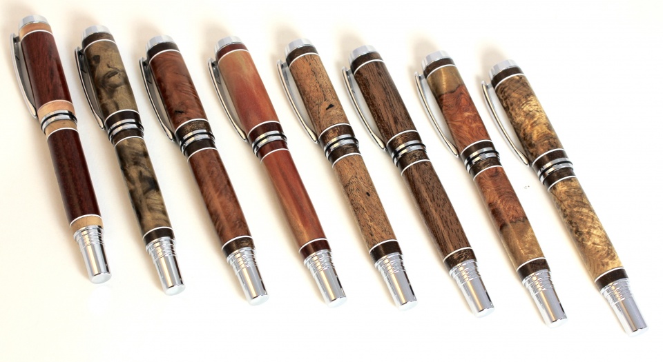

However, I'll offer a few pictures as examples.
The first are simple segments that I believe do command an equitable price increase, and are easy and quick.

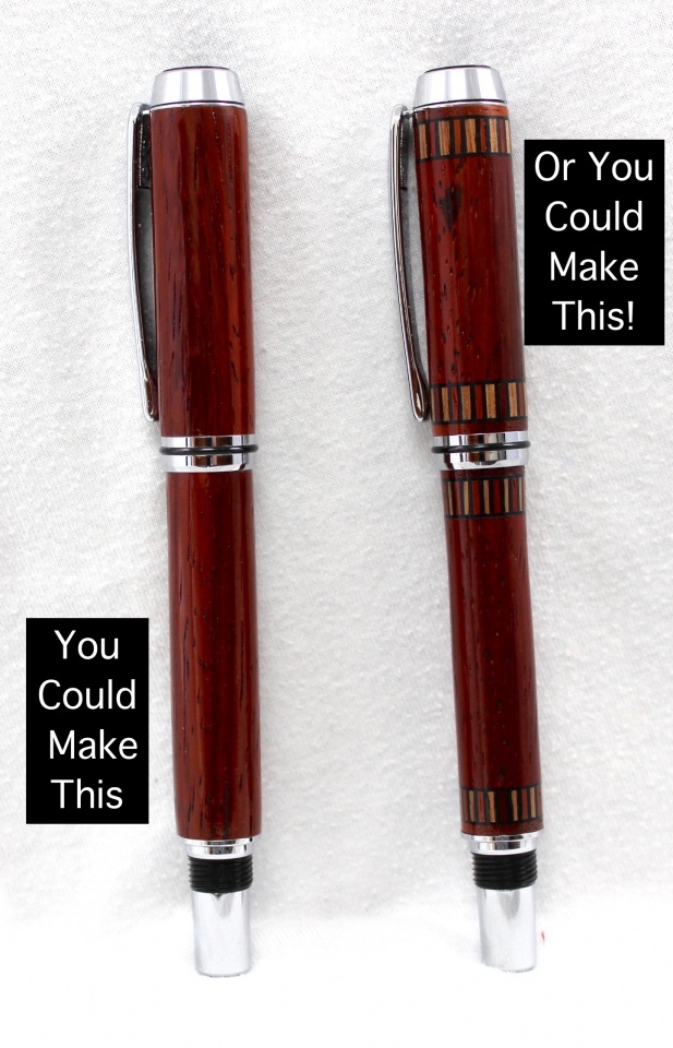

The second picture shows a nice pen without any segmenting, and the same wood (Padauk) with some segmenting... Would you charge $40 for the first, and $80 for the second??? This is where things get dicey.

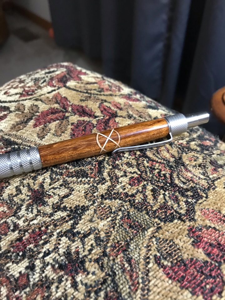

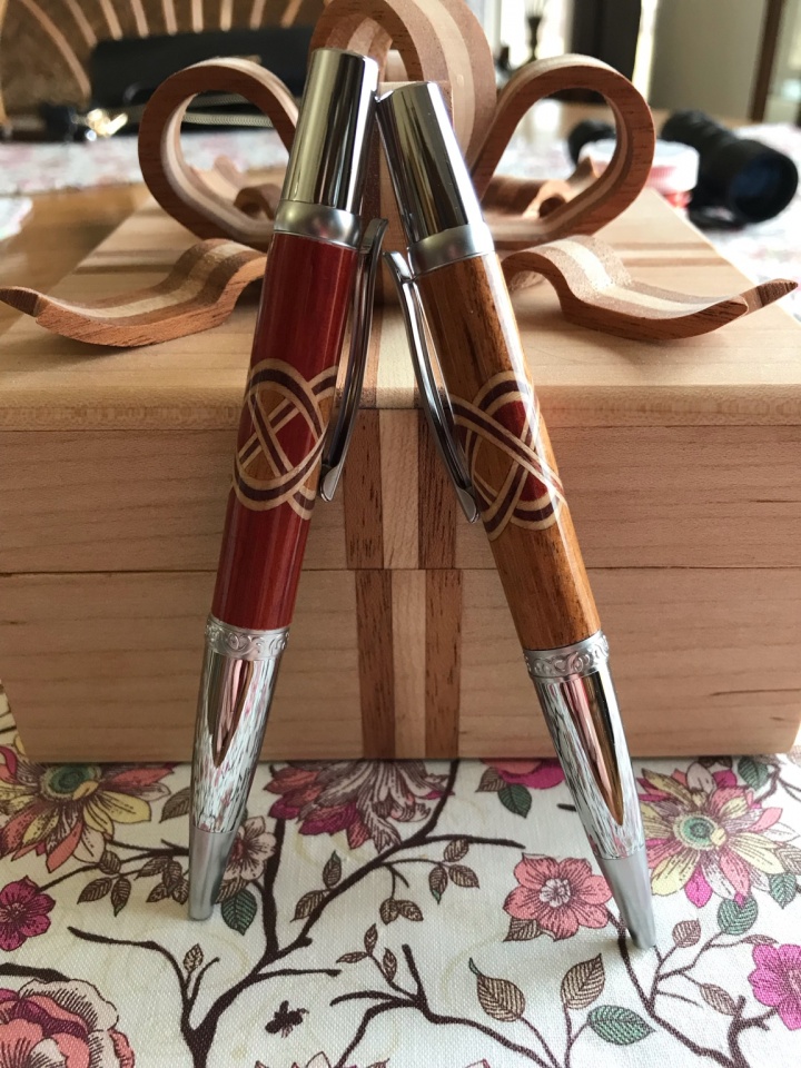

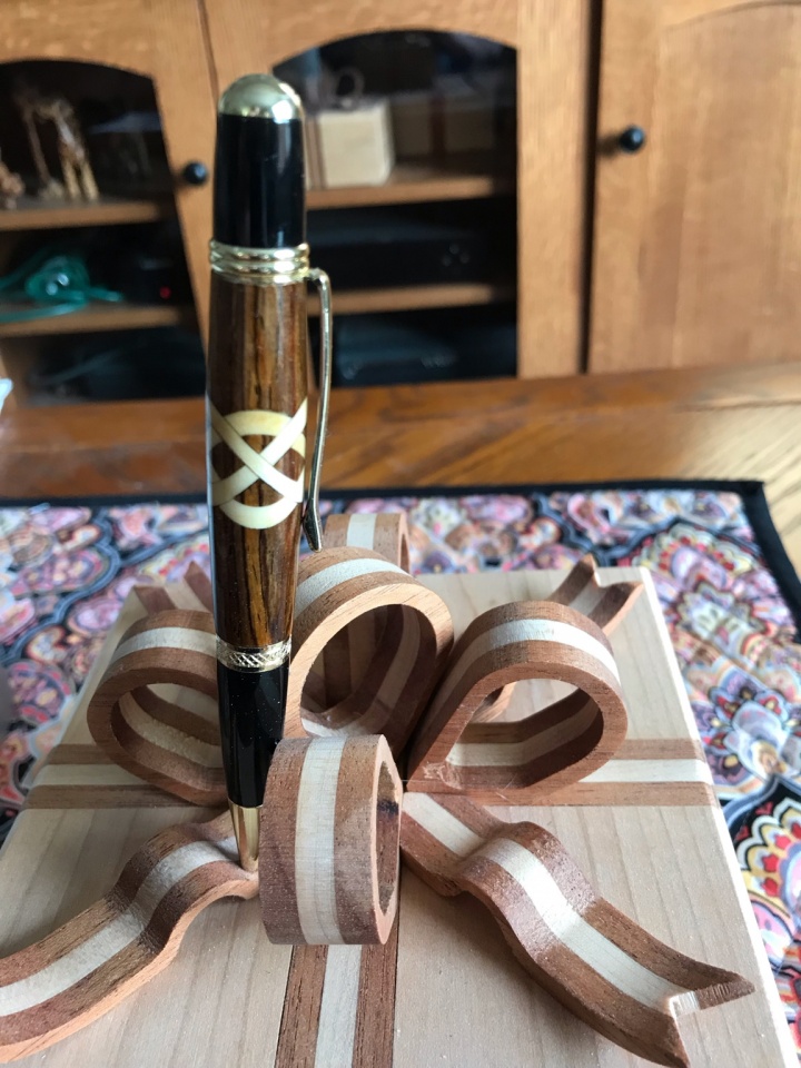

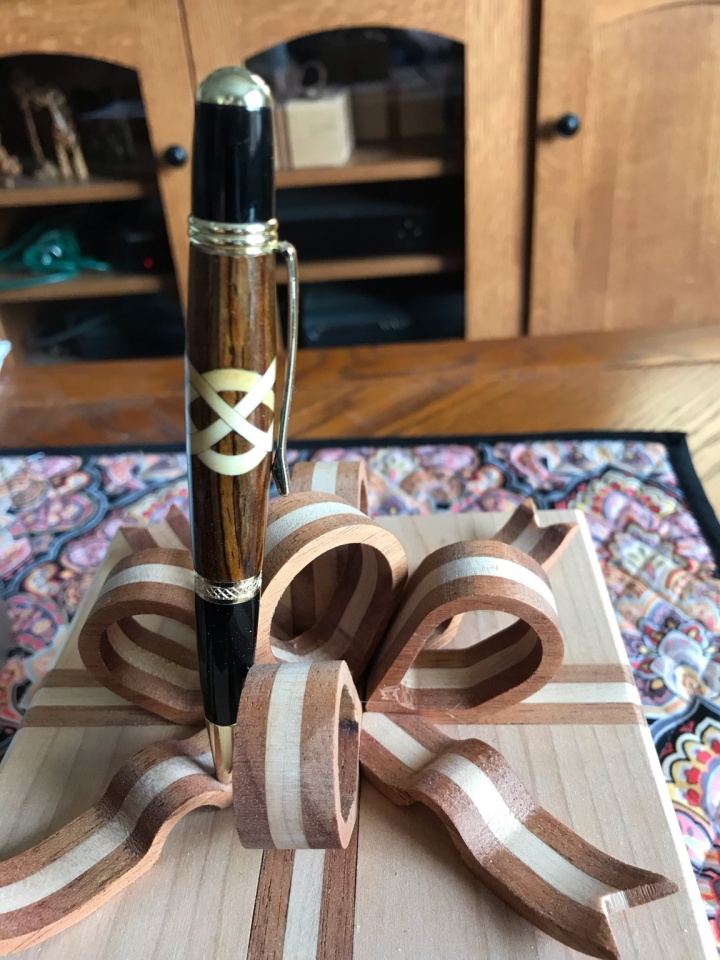

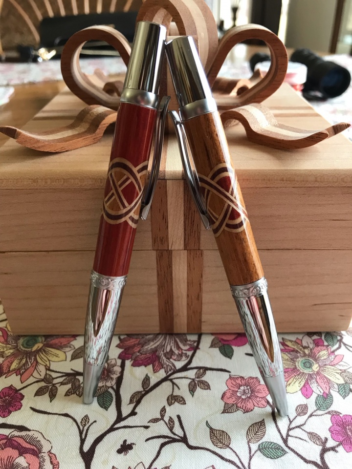

By the way. Here is my first ever attempt. It's not perfect but close enough that I know I can get there.View attachment 185954
Great first attempt. Just a tad off and you can tell by the area of the triangles top and bottom should be exactly the same. That comes from material used to infill the kerf. Needs to be exact.
But take that same design and do it in aluminum or use some pickguard of different colors or multiple colors and now the price of the pen could change and you did nothing different in amount of work. See what I am getting at. It is not all cut and dry and a specific formula to be used. Yes that pen looks good but it could look even better. Yes the labor portion is something you again get a feel for. I have never used a formula to figure out prices for anything I make. I have been doing this for a long time and have a feel of what people will pay and you too will gain this. You will learn certain pen types like cigars, sierras, jr gents and things just command so much and that is it. yes you can add a few $$ or subtract a few $$ because of the platings and also the blank material but you will be around a certain price. I put a circuit board blank on that same Sierra kit and it will get more $$ than that segmented pen. A small factor would be that the circuited board pen appeals to a wider audience than that knot that many people have no idea what it is. So just another example of not easy to price things. You took longer to make the knot but it does not mean more $$.
Save those special segmented blanks for the higher priced kits and they will command more. I talk all the time about the WOW factor and that is what will command a better $$
This is what works for me and everyone is different and have different thoughts but they arrive to their conclusions by feel over time and that is the bottom line.
Good luck as you continue.:smile::smile:

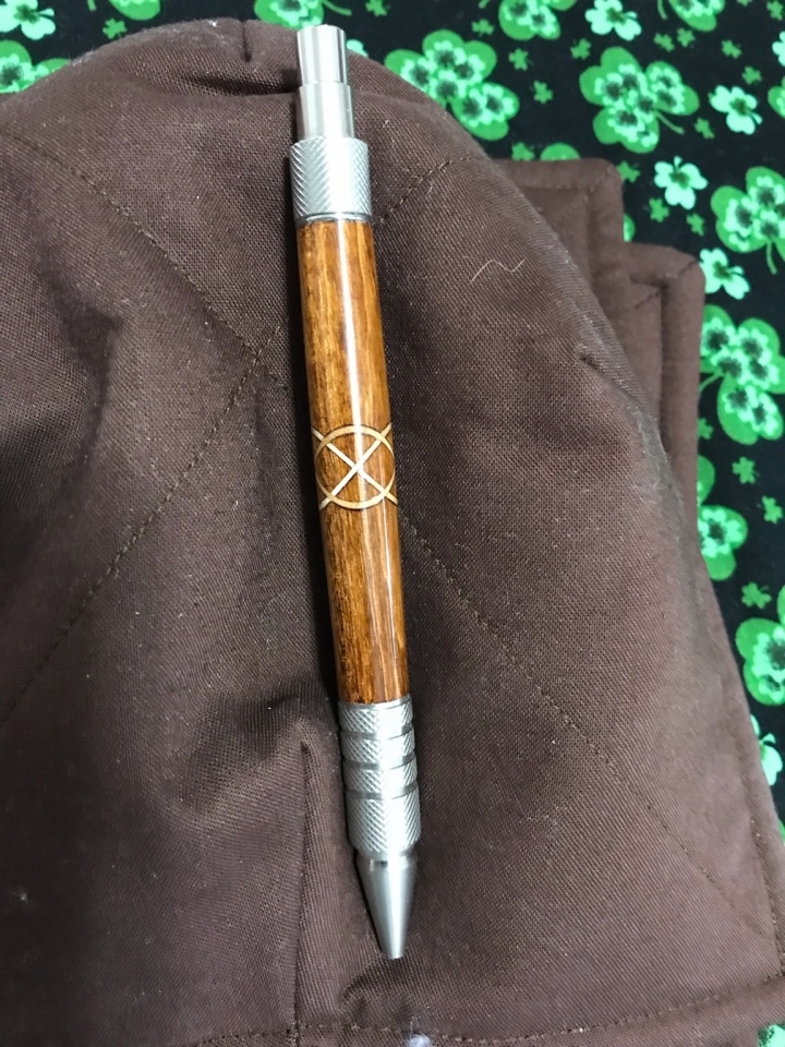

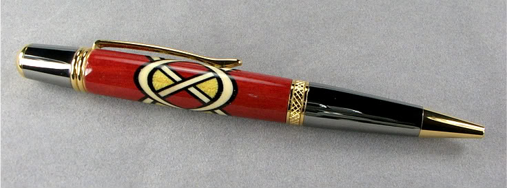

Yes that is an improvement by 100%. I see you are using a bandsaw from that thin of a kerf and the other were wider so guess that one was done on a tablesaw.
Your next step is to open the angle some to stretch the knot out more and get to see it better. Jigs will make segmenting so much easier because you can repeat cuts with precision. keep up the good work. We will make a segmenter out of you yet.:smile::smile::smile:

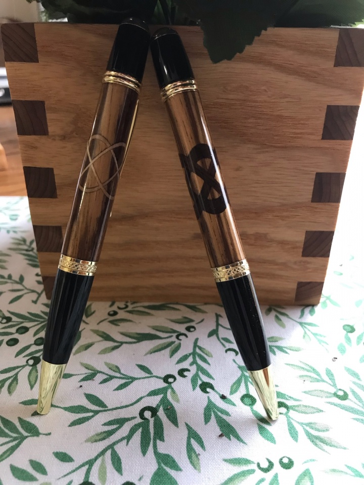

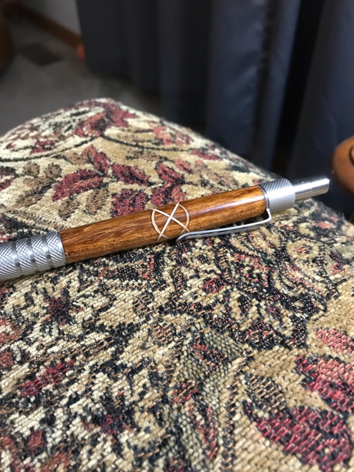

Yes, first one was table saw second is bandsaw. I built segmenting sleds, one for each saw. They use removable angle inserts. Both knots I did were at 45 degrees. I have read a lot of guys use 55 degrees. I will probably try that degree next. Yup, the segmenting monster has me firmly in its grasp.

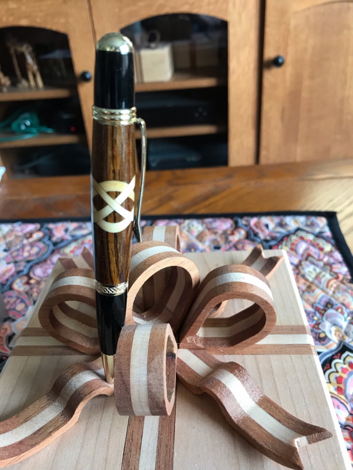

Made a 55 degree insert and tried it out on both bandsaw and table saw. They both turned out great. I like that I thought ahead enough to make the angle inserts fit either jig. Picture attached. IMG_0993.jpg
Yes so much better and see how it stretches the knot and gives a better look. You have the jig dialed in. That is what is great with jigs because they repeat cuts with accuracy.

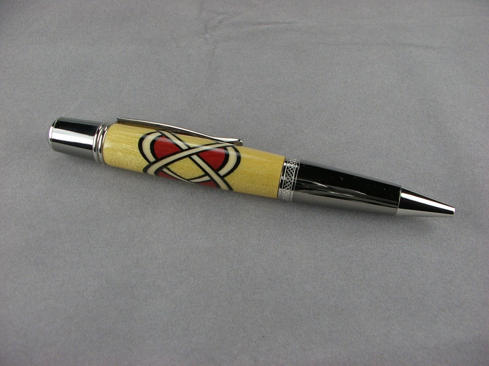

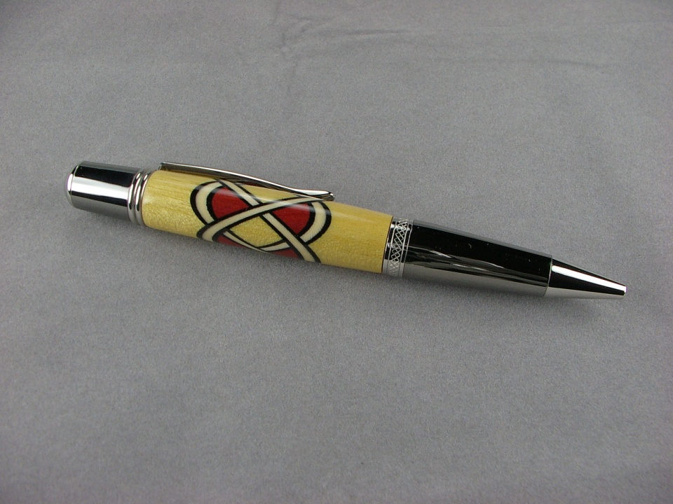

Here is your next project in that same realm.:smile::smile::smile:

Awesome , but that has me stumped as to how you can have the red in there. I see how to do the black and white knot.

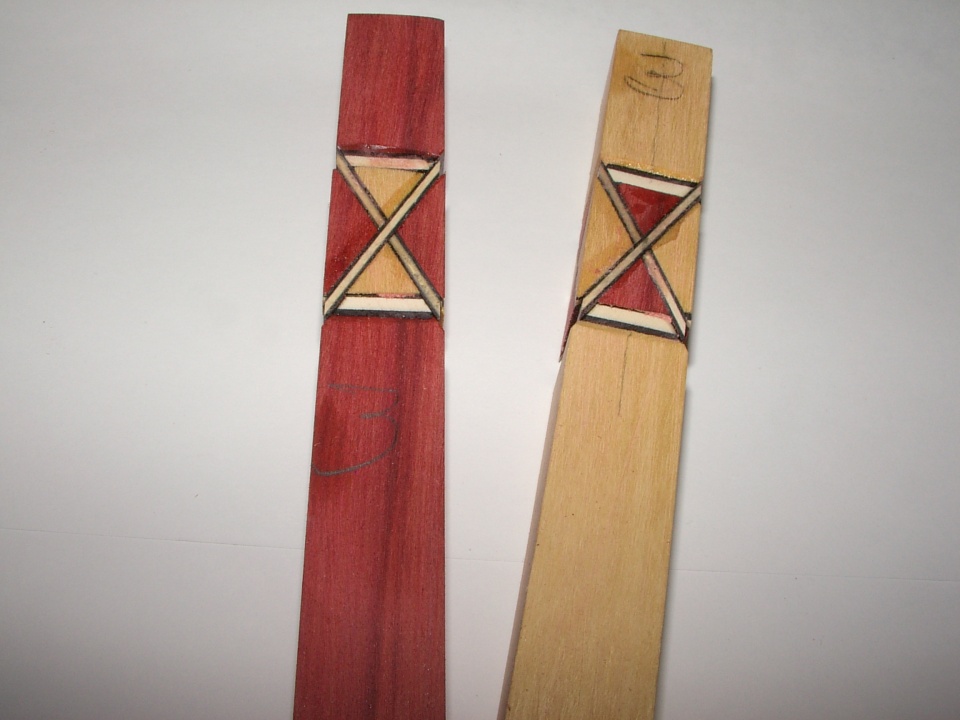

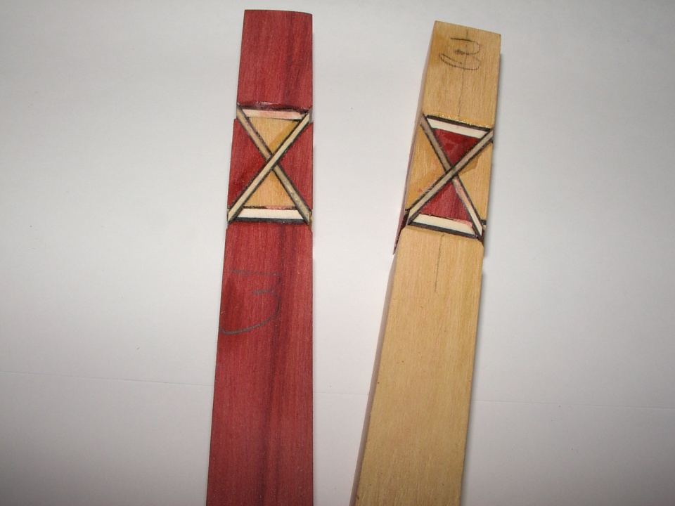

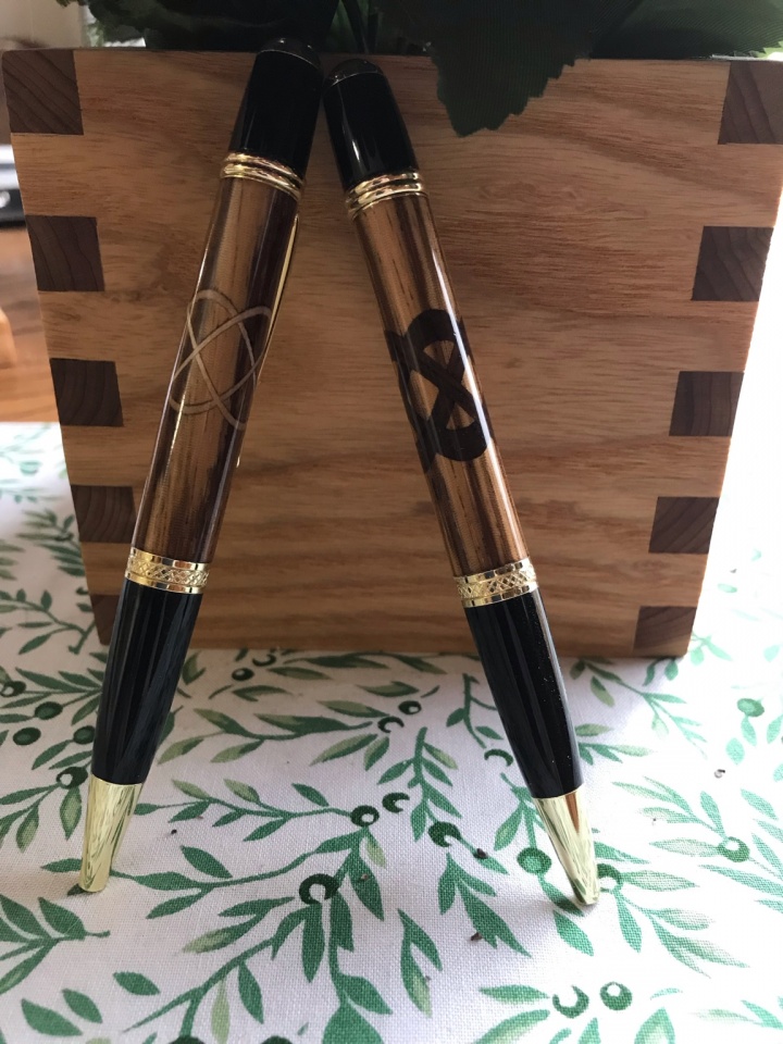

This may help you.:smile::smile:
View in Gallery
View in Gallery
It's like you took a segment from each and swapped them, but how in the world is that possible with such precision???
I see!! It looks difficult, but I like a challenge. I will give it a shot in the near future.
Not difficult at all.If you can make a knot you can do this design because it is the same principle. I have shown these here before and this topic has come up before so you can do a search for the older threads and all answers and suggestions lie within them. Good luck.:smile::smile:

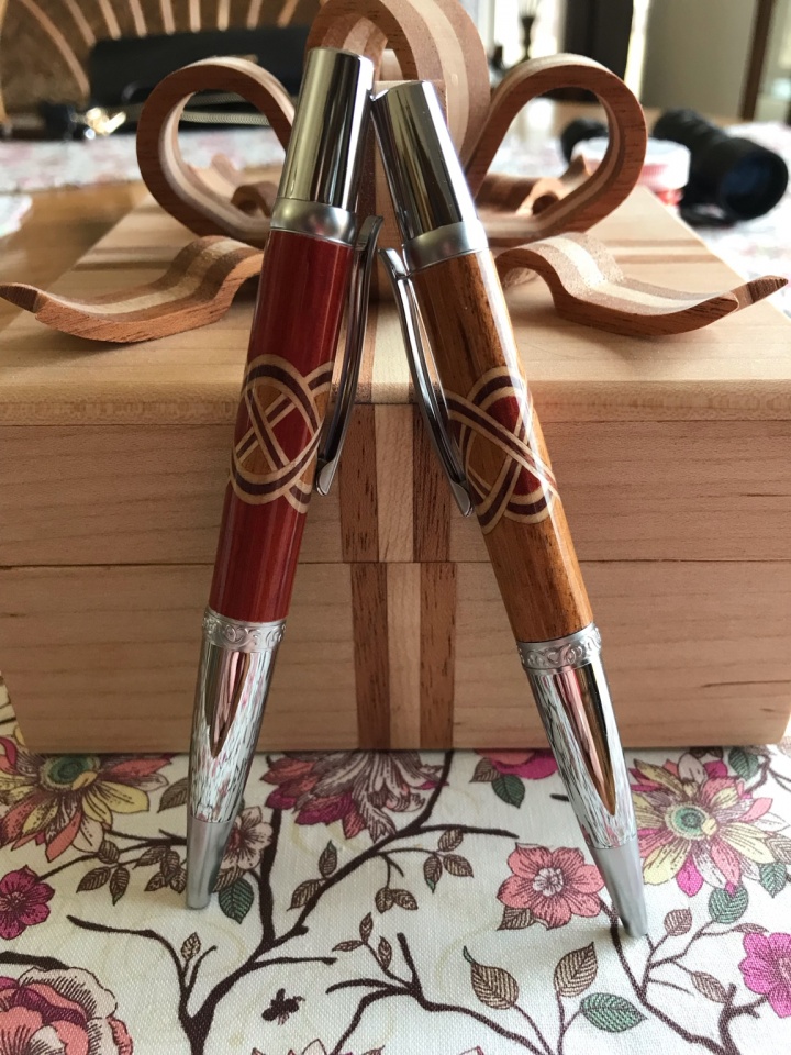

Okay John, I gave this a shot. I did figure out how to do it , but my results were less than stellar. The only thing I can think of why my results were so dismal is I think the blanks may have been slightly different sized. I will cut my own knot material and make sure they are all the same as well. Since you have to cut the blanks through completely, I would think the knot material can be any thickness,within reason, as long as they are exactly the same. Stay tuned, I'll get it sooner or later.

You are on the right track.:smile::smile: Look forward to seeing it. I did this on another site some years ago and had about 10 people trying to do it and they did figure it out.

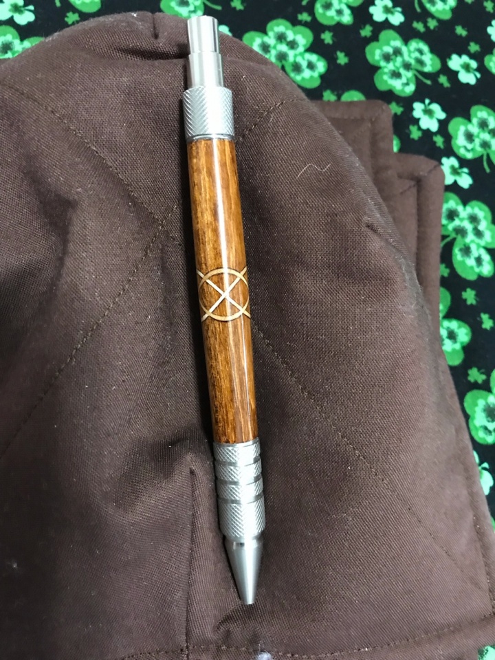

Ok John, challenge complete. I can't tell you how much I learned making these. Thank you for showing me your pens and thank you for pushing me. View attachment 186455
Well look at you. Job well done and they look great. Heck you are well on your way to some special segmented pens coming out of that shop of yours and I look forward to seeing them.:smile::smile:
