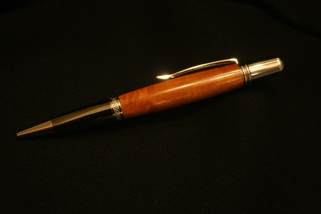

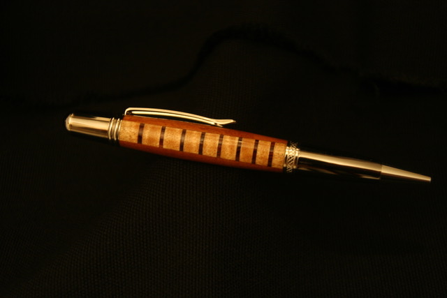

This was my entry into the Segmented Pen Category. The inlay was meant to represent a Les Paul Guitar Fretboard. The inlay was made with 17 pieces of Figured Maple and Indian Rosewood, it was then sanded, tapered and inserted into the blank. The blank itself was from a recycled pallet that was used to ship tiles from India.
Thanks for looking.

I had to start with a larger piece of wood and cut a tapered groove for the inlay with a sliding compound mitre saw with a stopped depth of 1/4". The inlay pieces themselves were cut from 3/4" x 3/4" blanks, darker pieces were cut to 1/16 " widths and the maple widths varied in length to match the spacings of the frets on the Les Paul Fretboard. The pieces were then glued and clamped together. I resawed the inlay piece to 1/4" thickness on the bandsaw, shaped and sanded it to match the taper in the main blank then glued and clamped the inlay into place. The dimension of the finished pen blank was approximately 3/4" x 3/4" and cut to length to the pen kit dimensions. Overall I'm happy with the results being my first attempt at making an inlay pen blank.
