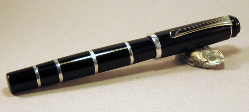

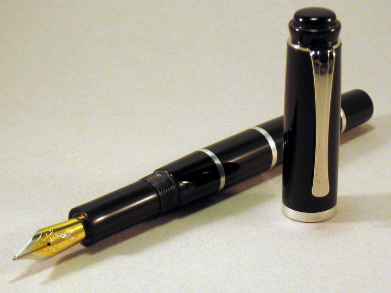

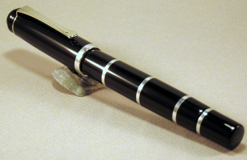

Although I haven't done it (yet) I will someday make a segmented kitless using a tube for reinforcement. Not a thing wrong with it IMO. It will still be a kitless, with threading on the parts.
I made this pen, and was told it wouldn't work, but I did it anyway:tongue: My friend was right. It would have worked if I had used a tube. I think a 10mm tube will work. You'd need enough inside diameter clearance for the converter if it's a fountain pen.
I suggest you jump in and make it happen. And have fun doing it:biggrin:

There is no rule that kitless pens cannot have a tube or some other reinforcment. You will need something, since the wall thickness is so thin.

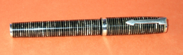

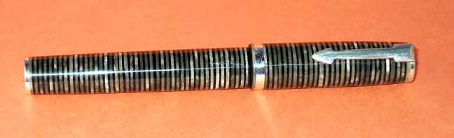

Hi Bruce where did the blank in the top photo come from. It looks stunning
Donovan
Thanks - I made it. I first cast some blanks and then made thin slices on a diamond saw. Glued them together one by one while rotating the pattern on the lighter color. Very time consuming, but I did get the effect I was looking for. Was trying to mimic the Parker Vacumatic.
