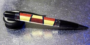

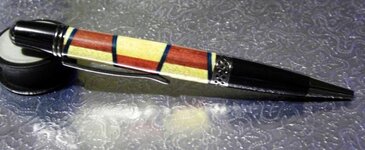

Pen Turner's Bible that is, I was reading my Bible the other day and saw this segmenting project and decided I wanted to try out my new 7 1/4" chop-saw. I had some very plain Yellow Hart and plain Paduk, so I put them together with some teal veneer and this is what I ended up with. This was more of a test to see how well the saw would perform, I am happy with it. :biggrin:
I did it a little different than the book, I built the blank before drilling and tubing. The Blank was turned by my friend John (desertrat).
Thanks for looking, comments welcome. :smile:
Look'n good. Silly question: How would you drill and tube the blank any other way? Wood'n it be hard to line everything up?
The book is excellent... However, even without the book you can find the best answer to that question: google for Rons Morning After pen tutorial. There he walks you through how his version is done drilling before assembly.

Did you CA the pieces together, or go with exopy?

I use Thick CA to put it together, and I used a piece of aluminium channel as a guide to keep it straight and wax paper to keep it from sticking.
