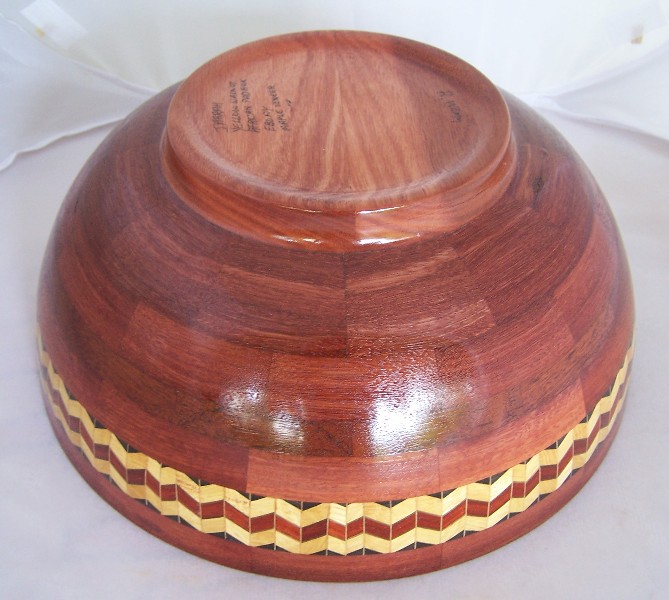

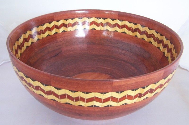

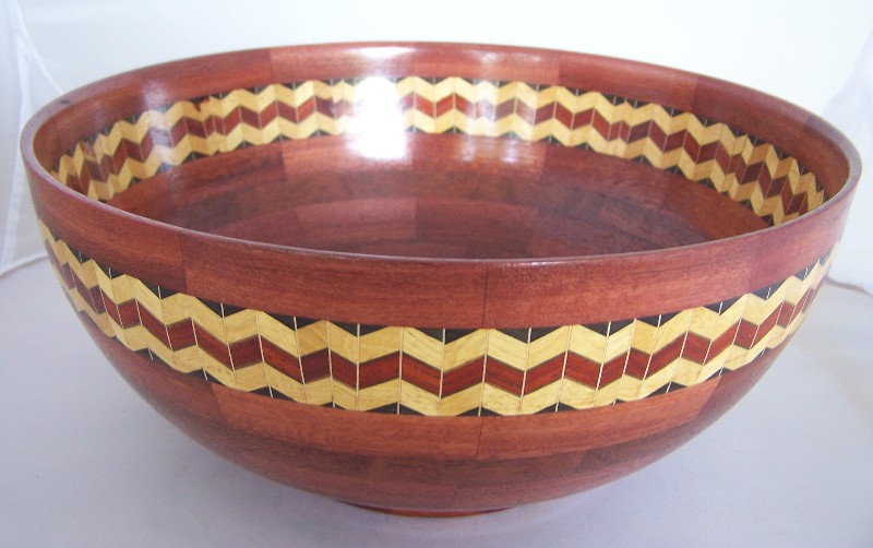

Got this one finished today, finally, and a VERY steep learning curve for me. I thought I had this all sorted, but NO!, there are lots of things to learn on the way. If you look closely at the feature ring you will see on the ends of each of the 12 segments, the pieces are smaller than the middle ones. That happens when you have a 3 inch segment in a 11 inch dia. curve. Moral of the story, when constructing a vessel of this size. make sure there are lots of segments in the feature ring. In this case 36 would have been much better.
The timbers used in the feature ring are Yellow Walnut, Padauk, Fake Ebony (made by me), and Maple veneer.
The bowl measures 11" x 5" and is made up of only 1214 pieces. The wall thickness is 1/8th inch.:eek:
It has been sanded to 400 and finished with several coats of WOP.
Thanks for looking and I hope you like it.
C & C Welcome.
Bob.:smile:
