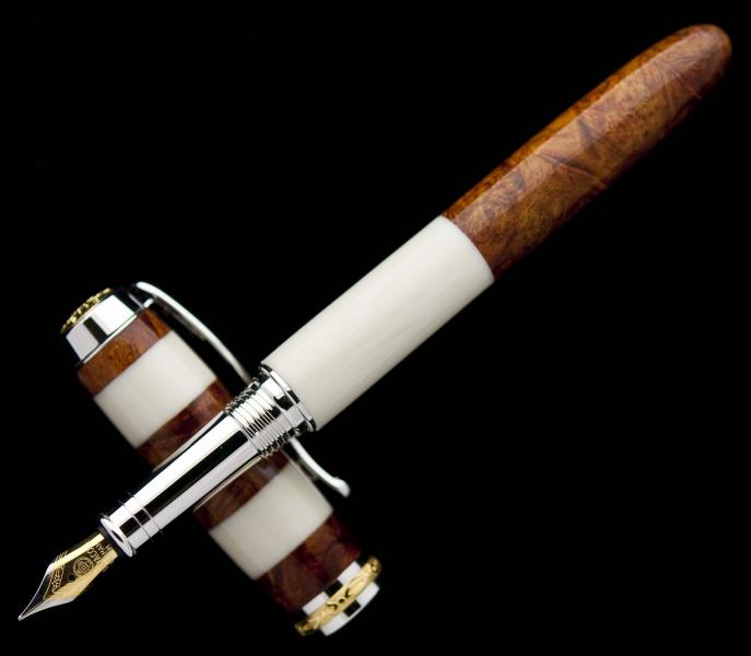

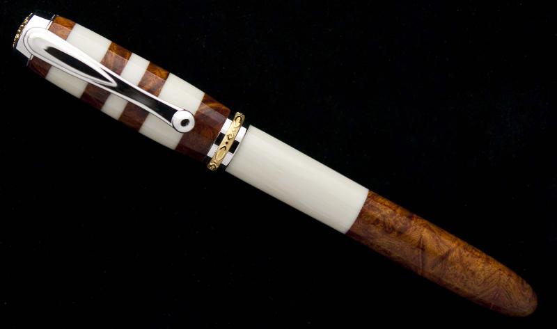

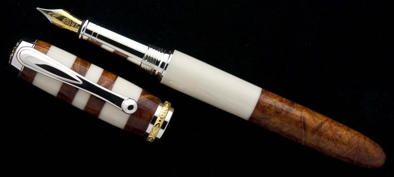

Finished this A.M. It's a segmented project on a 22K Gold/ Rhodium Jr. Statesman Fountain Pen. The materials are Alternate Ivory from Exotic Blanks along with a complimentary Logwood Burl from them. Segmented, glued together and turned it to near completion yesterday morning. Thought I would make it with a single closed end. SteveG mentioned that Logwood Burl turns darker and redder if you let it sit in the sun. He was right. Prior to finishing this A.M., I let the cap and barrel sit out in the sun light yesterday for a while rotating it occasionally to keep the color even. Still feel like the cap got more sunlight than the barrel. Felt like I was making hot dogs :eek:. Finished with 2 coats of thin CA, 8 coats of medium CA, MM to 12000 and HUT Plastic Polish. The pen looked better on the sketch pad than when finished ...but I think it will grow on me. Anyhow, it was practice segmenting. Next, I hope will be some angles. I hope you like the pen. Comments welcome but most of all thanks for looking. Doc:)

Did you design the cap the way it came out. with the lower segment larger than the top?
Whether you did or didn't it was a stoke of genius; as the design element works giving the top cap balance with its structure.

I did design the lower segment larger than the cap segment just as sketched.
Thank you for noticing!:)

Fantastic Doc, I see youre taking the Byrnes one step at a time :) I like segmenting on the cap no matter what is on the body and this is no exception - seems to be the first thing people notice although in this case the body definitely compliments the cap.
Im just not sure whether I like the difference in the size of the end pieces on the cap yet. It feels sort of unbalanced if you know what I mean? Perhaps its my left brains symmetry in over drive :)

Terry, I know what you mean with the different sized end pieces...I tried to use the longer wood end piece on the cap to enhance or accent the appearance of the longer wood section of the barrel. I'm not sure I accomplished that. Anyway, the idea seemed better as a sketch on paper than when I saw the finished product :rolleyes:.
By the way, the Byrnes saw is awesome and I'm just getting used to it. Regards, Doc
